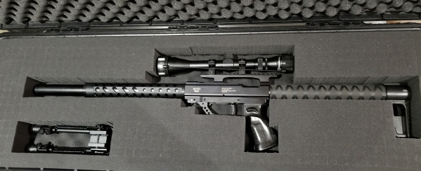

I am new to air rifles as I have been a firearms guy for more than 30 years. I have done some research and I decided on the Evanix Rex for my first big bore PCP.
First thing I did was go over the rifles and apply a bit of thread lock to the locations I felt might work lose during normal operations of the rifle. I adjusted the trigger pull to a level I am satisfied with and then placed a dab of silicone over the adjustment screw, this will help keep is from backing out or even changing the trigger pull inadvertently (seen where this was a concern for another shooter).
My next step was to mount a pic rail to the bottom of the shroud for a bi-pod...straight forward as long as you drill an appropriate size hole for the mount and ensure the fasteners do not protrude so far as to touch the barrel. I simple ground off a few millimeters of them and the fit is great.
As for the optic, I have a few from my other rifles and I am giving them each a go to see which I like best. Not doing much shooting with the winter weather but I have been able to shoot out to 45 yards after sighting in at 25 yards. No issues with my shot groups less than 1 inch when prone/supported. (Nosler .357 145gr)
My expectation for this rifle has been met so far, it meets my needs and I look forward to more shooting this spring when the weather permits.
Wanted to update this with a tip for the trigger adjustment screw, I removed the dab of silicone I had used and replaced it with a small plug I made from Mastic tape. Mastic can be found at places like home depot, it's very pliable and sticks to metal very well and yet is easily removable. This will help ensure the screw does not back out from vibrations and it will also keep the area around the adjustment screw free of debris. I fired about 20 rounds and the Mastic plug is holding well. A bonus is the plug is black and blends very well, I am a bit OCD so I care how it looks lol.
