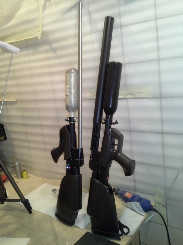

Electric Big Bore 0.357
9mm, the speed of the bullet is 5.3 grams.
320m\s This energy is about 270 joules. Electric hammer 38g.

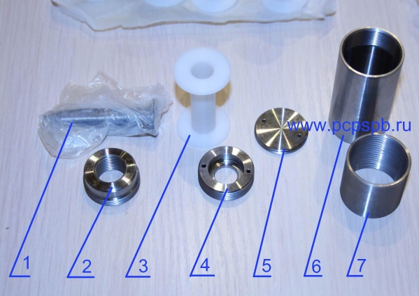

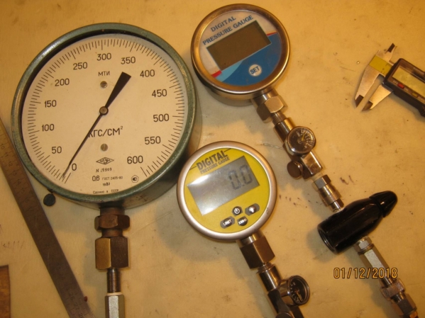

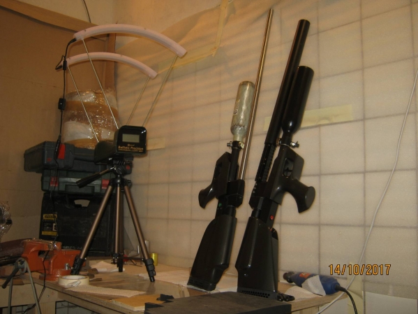

Barrel length and operating pressure @ valve during shot? Good build.
700mm, Lotar Walter. pressure 4400psi.
I put different barrel , usually length 440mm or 260mm, the speed is less.
700mm - 310-328m\s
440mm - 280-270m\s
350mm - 250-265m\s
260mm - 220 m\s
Remove the barrel and put - 1 minute. very fast. Create a video?
Sample - barrel 440mm, pressure 300 BAR, - 251m\s , 252, 260, 263, 263, 266, 266, 266, 268,267, 265, 265,264, 260,258. pressure 210 BAR
Bottle 0,35l + 0,048l = total 0,398l

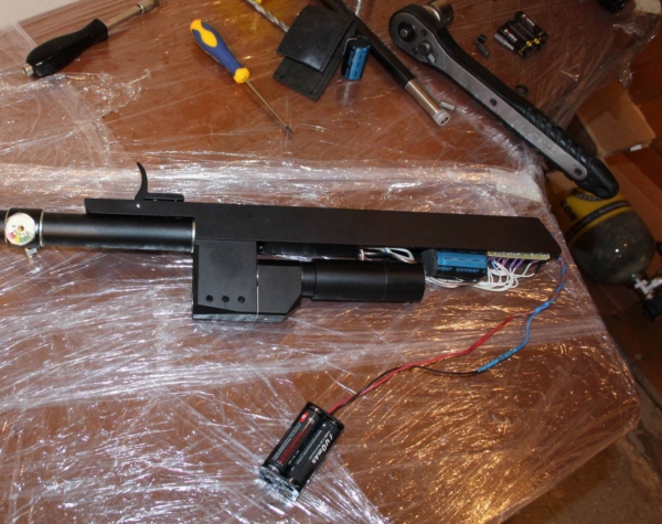

Is this a PCP with an electric firing mechanism?
So if I understand this correctly you are using a solenoid to open the charge chamber instead of whatever else is used?

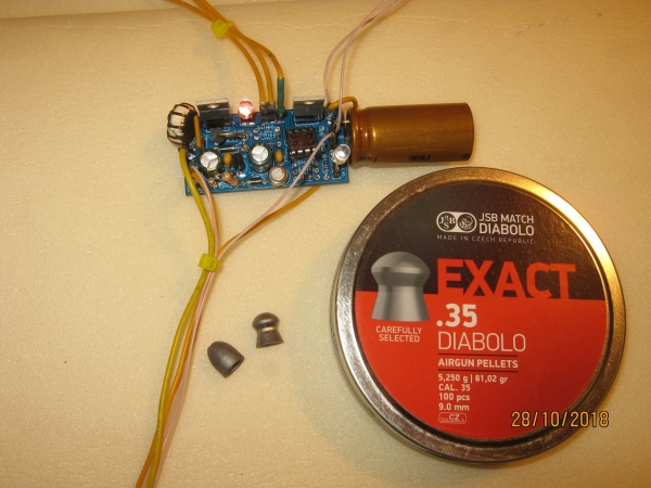

Yes. solenoid, impact. The voltage pulse is 100 volts. Scatters 18mm. Very accurate shot. Minimum time lok. Easy trigger. Sports descent.
