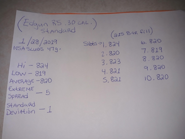

I bought a R5 Matador.30 Standard with huma Regulator already Installed from a Member here in AGN....i am shooting NSA 47 slugs...I sighted her in at 50 yards...10 shoots hole in hole was just to easy....im not sure where the reg is set at...But here is my 10 shot crony Data...planning on setting it to 130 bar on the reg to get it up to around 850 ish...
