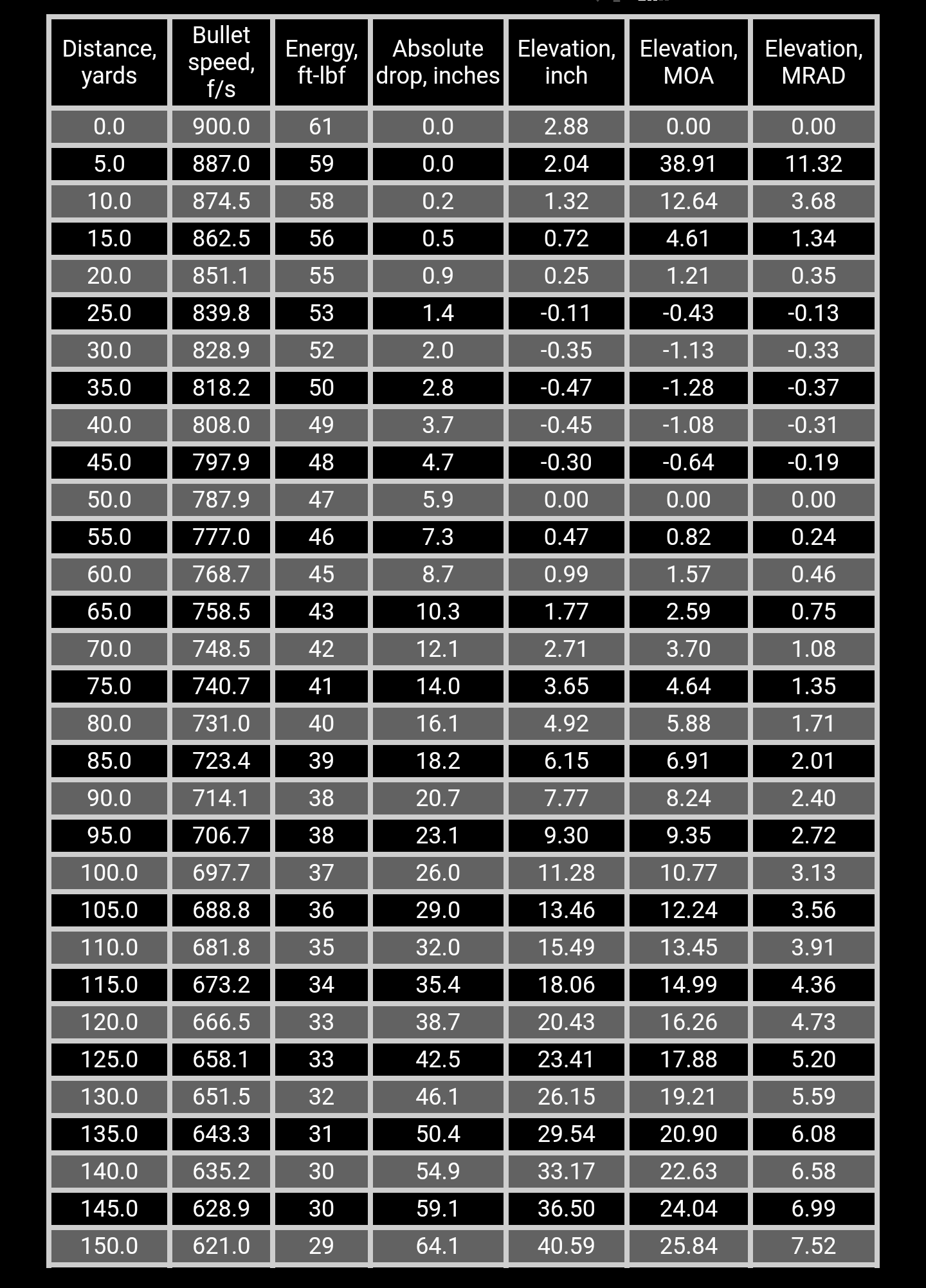

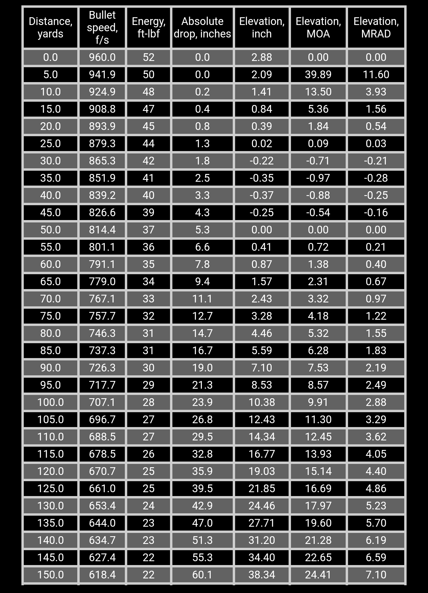

Without knowing what caliber you are working with, here's a generic dope chart that I pulled off Strelok Pro for a .25 caliber, 34 grain pellet. I changed the zero distance to a 50 yard zero so you can get an idea of drop and elevation adjustment. Going from 50 yard to 100!yards is about 11 MOA dial up. I can make you a better, more precise chart if you let us know the gun, ammo, and approximate speeds.
