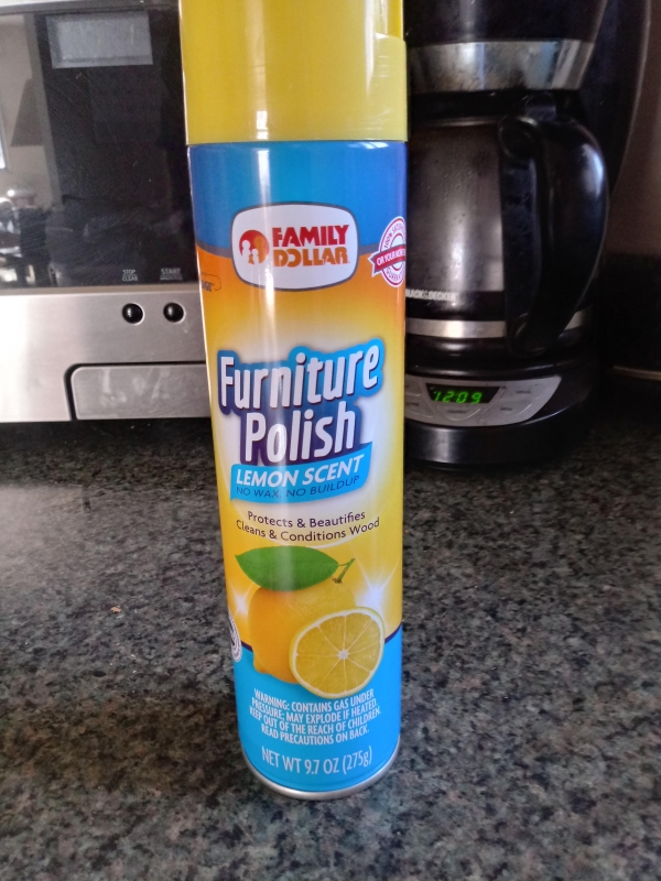

Just curious,does it have to specifically be Lemon Pledge? ...or can a slightly lower cost version be used?
It's not that I'm incredibly cheap,I just wondered if I can use what I have on hand. Thanks!
( I had to move quick taking this pic before my Wife saw me handling the furniture polish...didn't want to give Her any "False hope"!)
Mike
