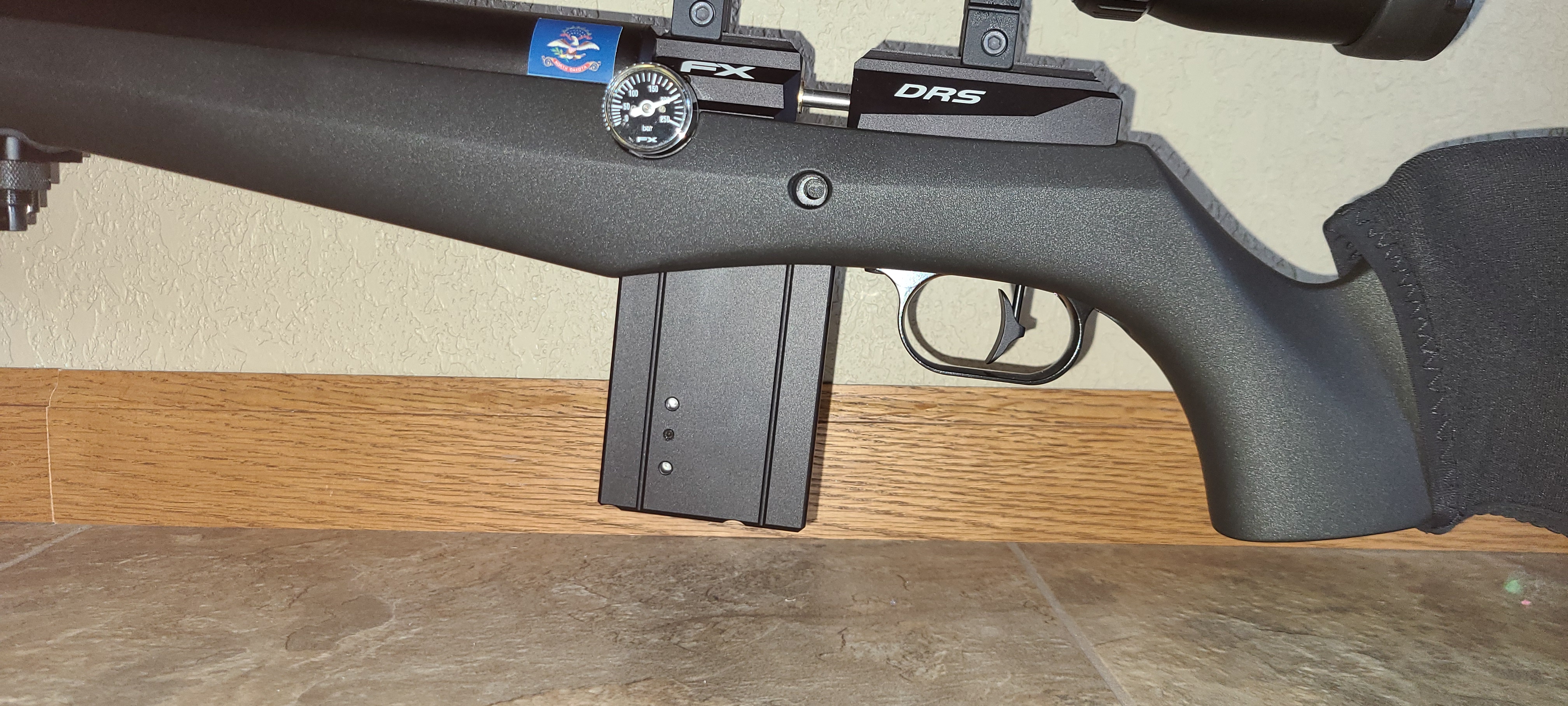

I'm a bit confused I wanted to get a drs 600 mm couldn't find in 22 or 25 I then ran across a 22 cal 700 mm with synthetic stock classic I thought so I'm curious what plenum would come on it 12 cc classic or a larger plenum?
I didnt watch any videos on the drs classic. I only looked at specs on the FX website.In this video from FX Airguns they show the specifications for the DRS with 500,600 and 700mm barrels at 2:45
So how heavy of a slug are you able to shoot with it I'd like to have 34 gr around 900-1000 fps would be nice
I am shooting a .218 34gr H&N Heavy at 945fps with the reg set at 155 bar.So how heavy of a slug are you able to shoot with it I'd like to have 34 gr around 900-1000 fps would be nice
How many shots per fill are you getting before you come off the reg?I am shooting a .218 34gr H&N Heavy at 945fps with the reg set at 155 bar.
At 155bar the maximum velocity I got was 965fps. I back the hammer spring tension down until it settled at 945fps.
