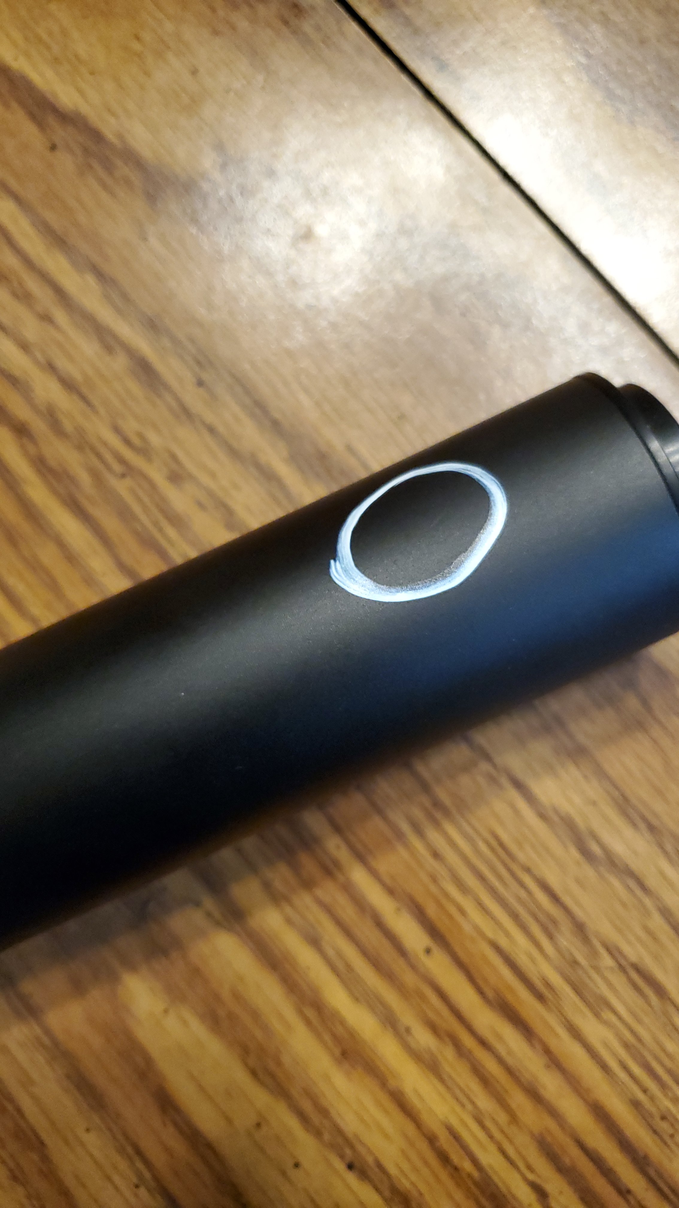

Found out my dang compact airtube has a microscopic crack. Was trying to fill it and it just would not top off. Felt air but thought it was coming from the nearby tank gauge. Removed the airtube and still felt air. It is about 1 inch from the threaded end. It is a 2021 airtube. Guess I have to buy a new one since this was second hand and probably not warranty-able.

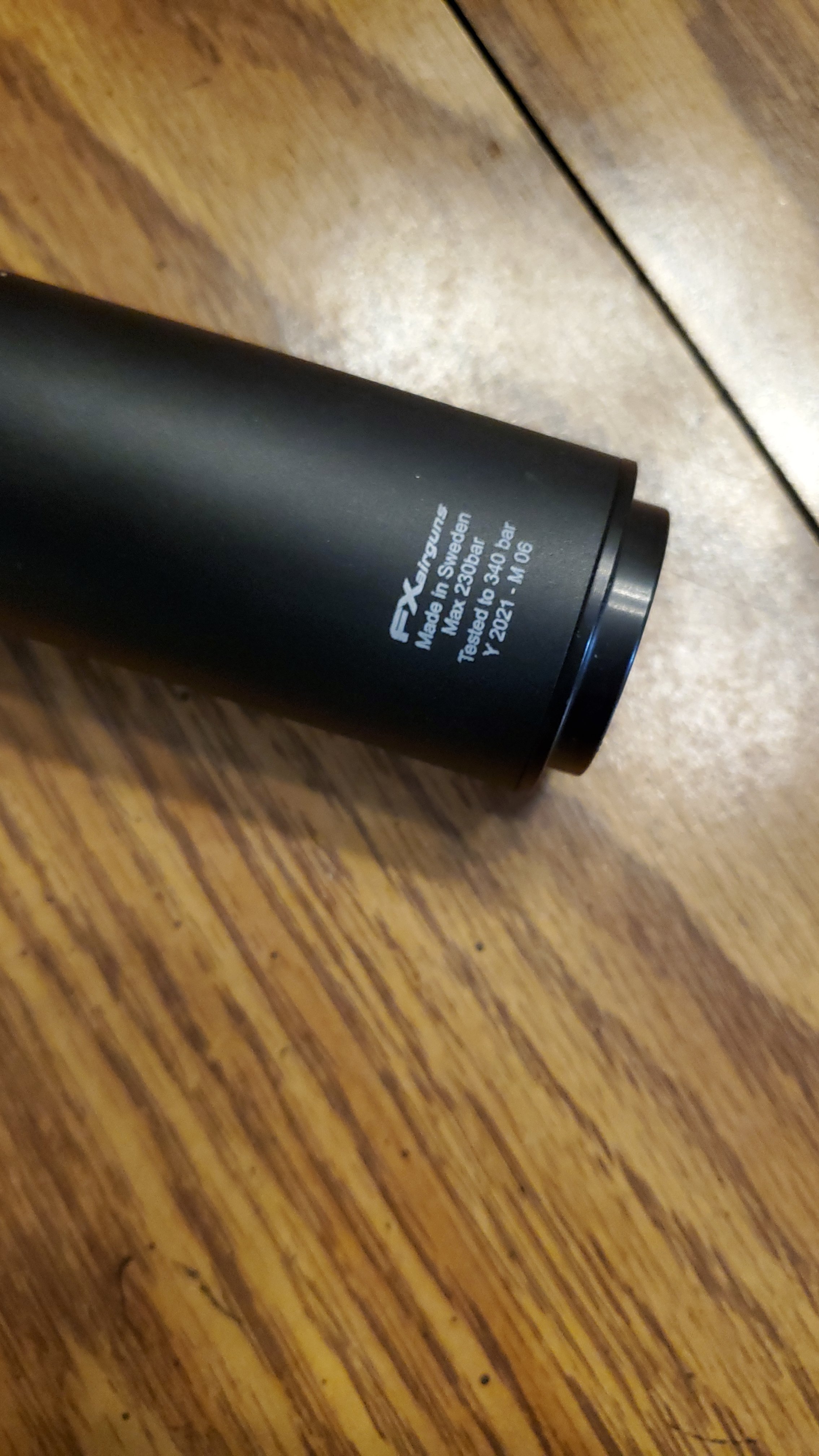

Well double check the dates on the tube to make sure it is not the 2021 ones. Thread over on UK forums says it is a known issue. Saw some on Pyramyd's site to but dang $200 is alot to shave a couple ounces. I will post up a picture of it later. Utah did mention this thread over the phone asking if I was the same guy having the problem. They are watching and trying to help us as best they can.
It is that tiny little fingernail looking scratch that is circled. Super hard to photo and see.
