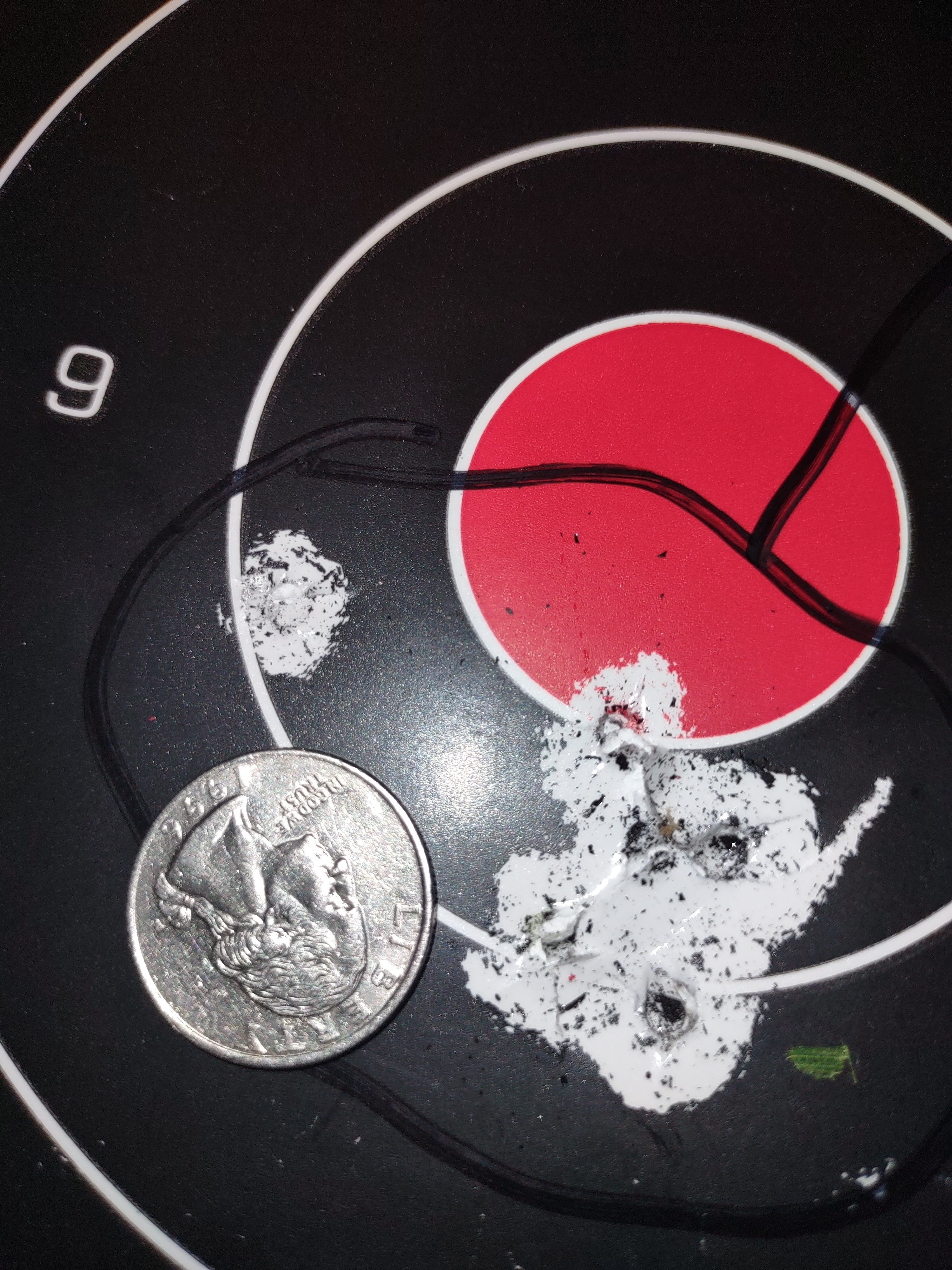

Ok, I got 601 fps with Avanti match BBs. I then switched to a target at 20 yards with iron sights, 6 shot group (had a flier so I shot a 6th shot) with the H&N Final Match 7.87 gr off a sand bag. I also used this eye patch. (https://www.amazon.com/dp/B01D1AJZ06?psc=1&ref=ppx_yo2ov_dt_b_product_details). I put the patch on the very upper left hand corner of my progressive lens. In the old days, I could see the iron sights clear but target was fuzzy without my glasses and the opposite with my glasses. 2" but closer to 3" groups was the norm. With the patch on my glasses the iron sights were very clear and the target pretty clear. Anyway although the gun is not as powerful as specs, accuracy exceeds everything that I expected. This gun is a keeper. I agree with Tom Gaylord on not to scope it. I don't see how you could pump it. Funny thing is on the Youtube reviews and even Tom Gaylords review, the accuracy of the Crossman 760 does seem impressive. Must be the button rifled barrel vs smoothbore on the newer 760s. Trigger must be 15 lbs, horrible but still good accuracy. I will get around to measuring it sometime as I want to have a vintage pumper shootout and compare accuracy , velocity, energy and triggle pull of my pumpers. Need a Benjamin 342, 314 0r 347 plus a S&W pellet gun to complete my collection but that will take some time. Should be fun with what I got.
