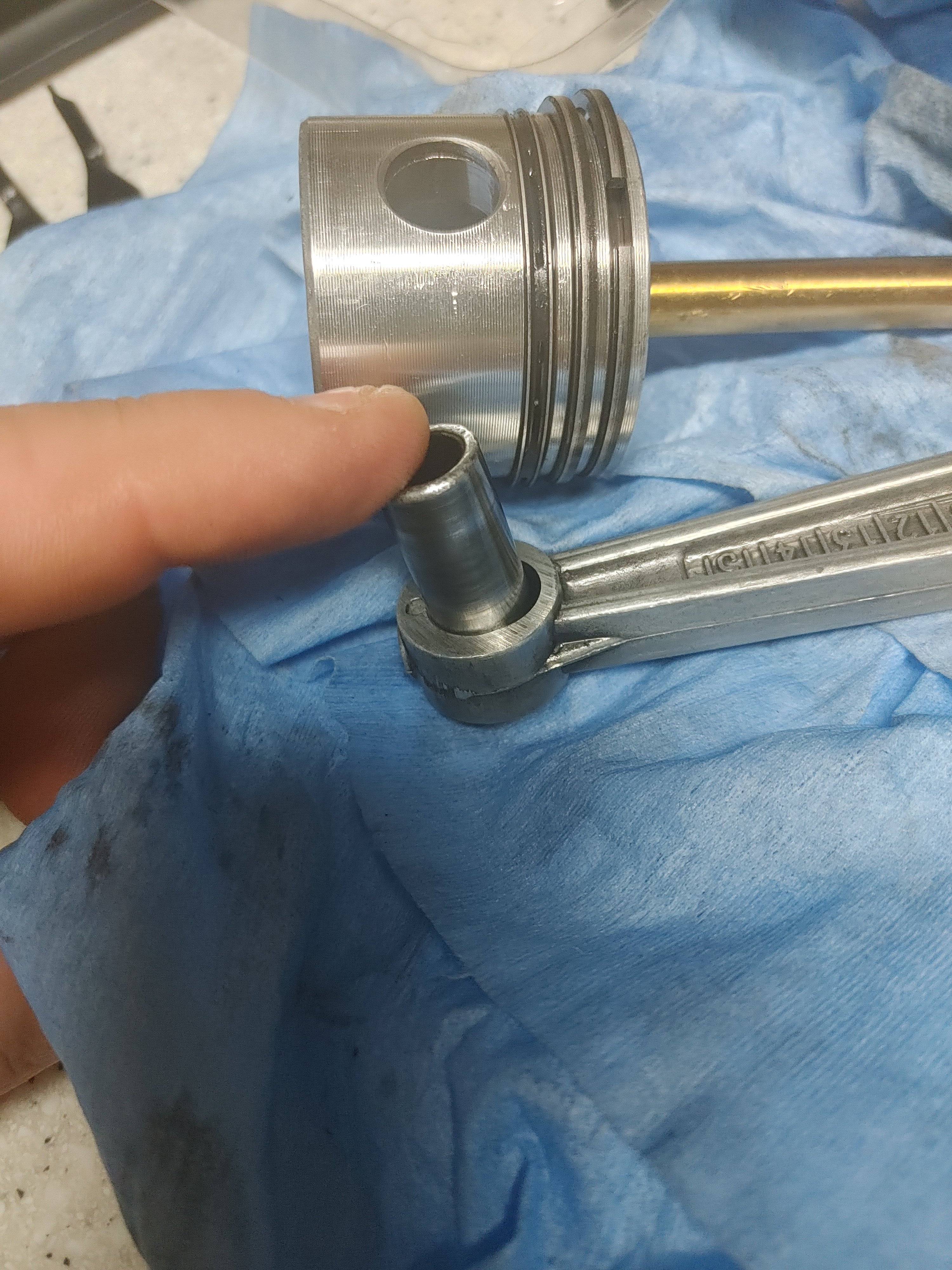

Wow talk about wollowed out. Time for a new piston / rod kit.
What I've discovered on the YH clone. The second stage piston is a smaller diameter than Yong Heng with no replaceable rings and second stage piston no where to be found. The blast disk is located on top and uses a larger blast disk. The only problem I ever had with the clone was carbon under the anti flow-back plate (would only pump to 1500psi), Cleaned and was performing perfect. I was using the Royal Purple Syn100, I think that's what caused the carbon. I changed to Mobil 827 Rarus used it for awhile, Reboxed as a back-up and purchased a real Yong Heng from Walmart.
The hardest part of taking the clone apart for me was the stainless piping because tight fit and angles of threaded fittings. Ali-Express is a great resource but no parts for the clone that I could find.

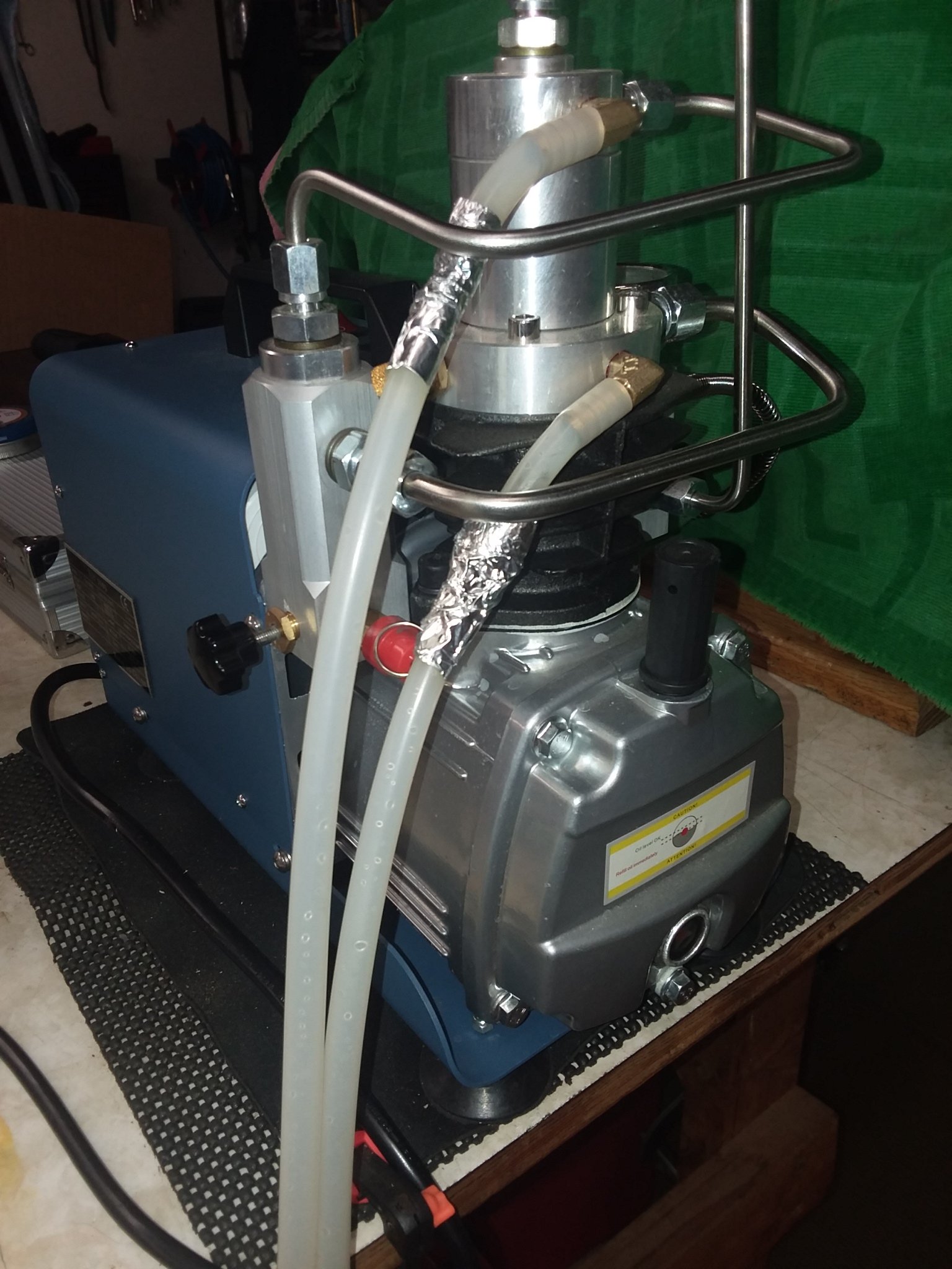

Hey Guys, Compressor came today! Im sad to say but I'm allready running into problems,
I filled it up with oil hooked up the waterlines hooked it to 220 and fired it up.
I tried to fill my cricket .22 up with it, and it kept beeping and shuitting off, and finally it stopped completlely. All it does is beep when I turn it on! I think I'm in a world of hurt now... Any ideas from you guys?
This is a 220 volt model.
I did have it hooked to an extention cord, but idk if that made any difference.
I did put in the right kind of oil.
I did hook up the cooling system properly.
Any suggestions would be greatly apprecieted....
I did contact the company we will see what they are able to tell me. Man I wish I would have bought locally!! :-(
Mine has all of the electrical connections soldered and shrink wrapped. Mine refused to start up after a while and this was the fix. Not sure if it'll help, but maybe. I've been using mine for years. Also came from china/ebay. Just buy from a reputable seller and you should be good assuming the post does their job. And assuming it is actually a real yong heng. I did my homework and due diligence when I got mine so there was no question.
