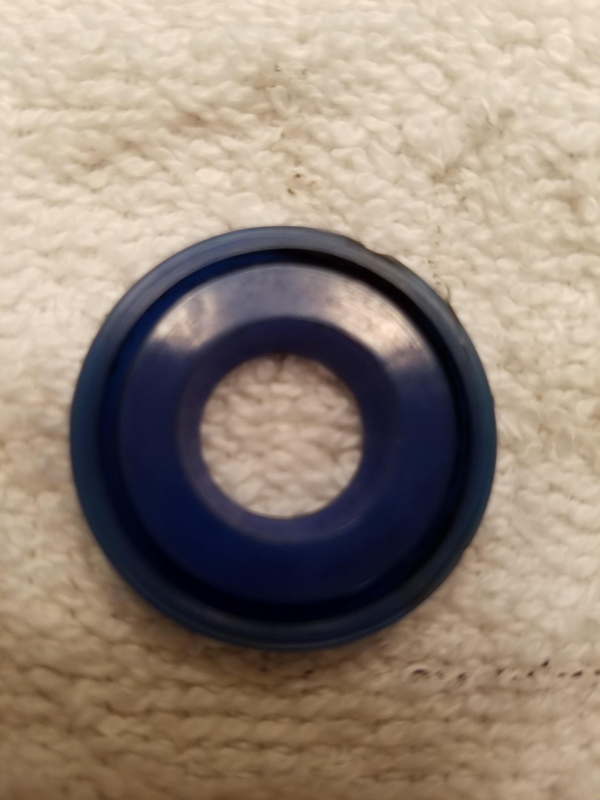

That's slow for a magnum. I have a Diana 34 and it is shooting those JSB pellets at 680fps. Just recently, my poi dropped so I checked with chrony and it was down to 650fps. Took the gun apart and found a bad piston seal. Replaced with a new one I had on hand and I'm back to 680fps. Got my spare seals from gunspares, original blue Diana seals.

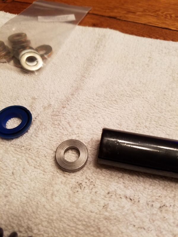

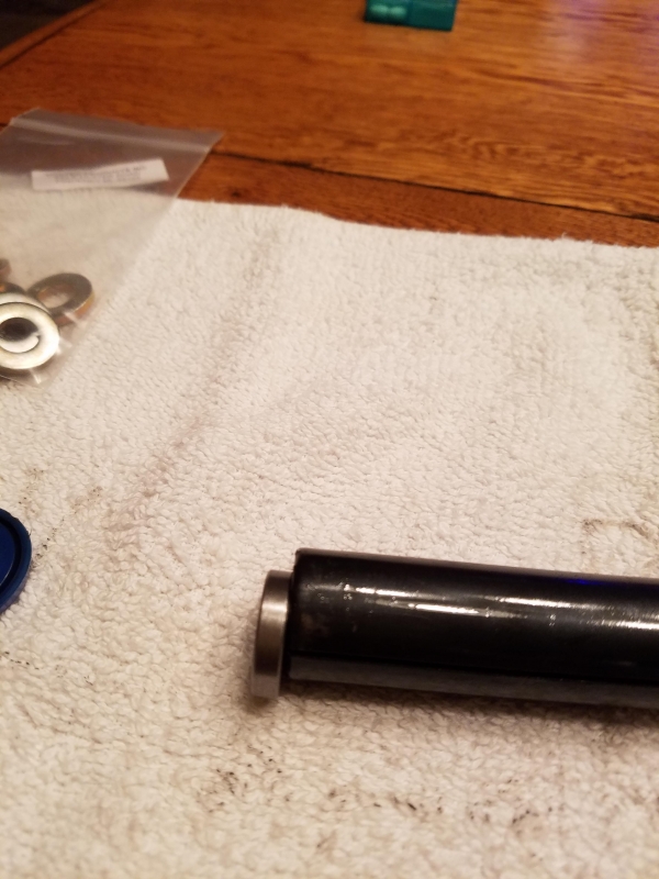

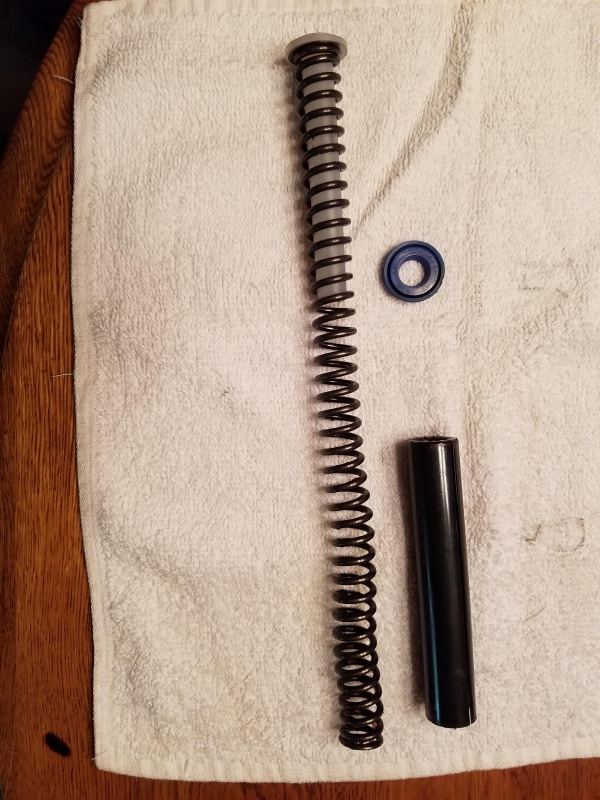

I finally disassembled my gun and this is what I found a smaller and shorter crooked spring than the Vorteck spring that I replaced it with.a damaged piston seal a very thick washer for pre load and round tube inside the piston.Its no wonder I was having low FPS numbers.I polished the piston and air compression chamber.The vorteck spring had at least a good 2 inchs outside the gun where the old spring was barely even with the end of the gun ugh This was a re-manufactured gun.New number 15.89 JSB 775 fps
