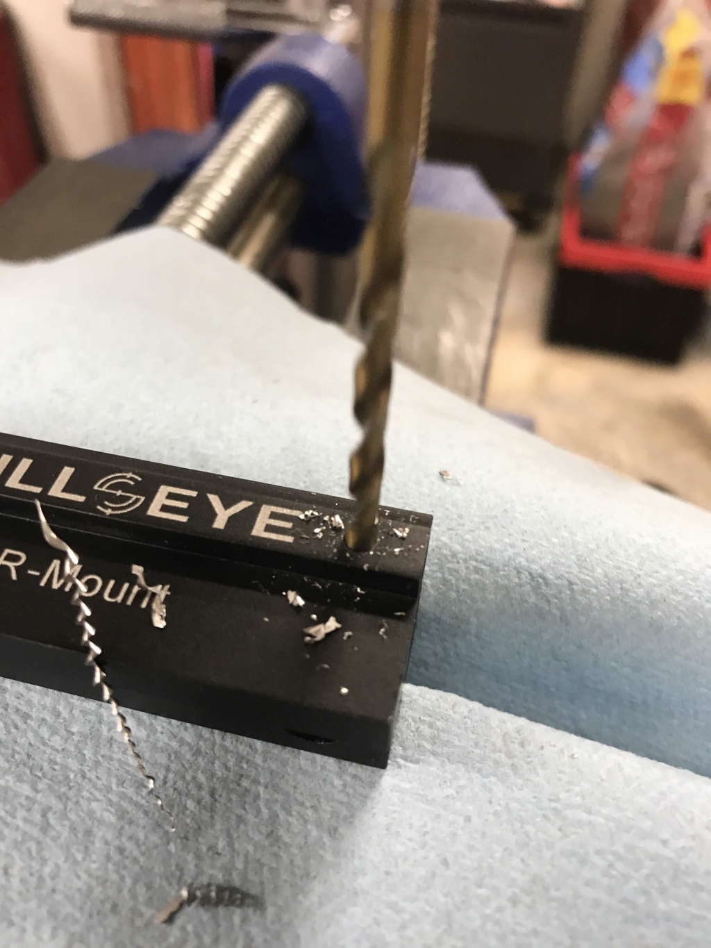

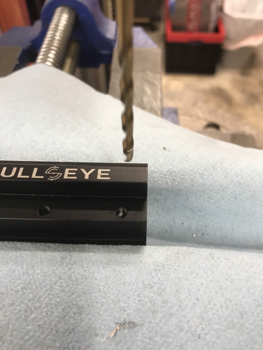

The trick involves some drilling and tap work to install your own grub set screws in the mount body. (I ain't no machinist, and in fact I screwed up a drill hole, and this still ended up working out).

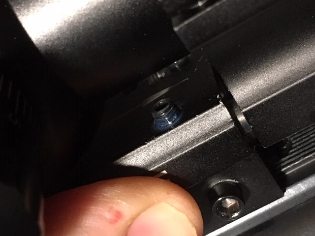

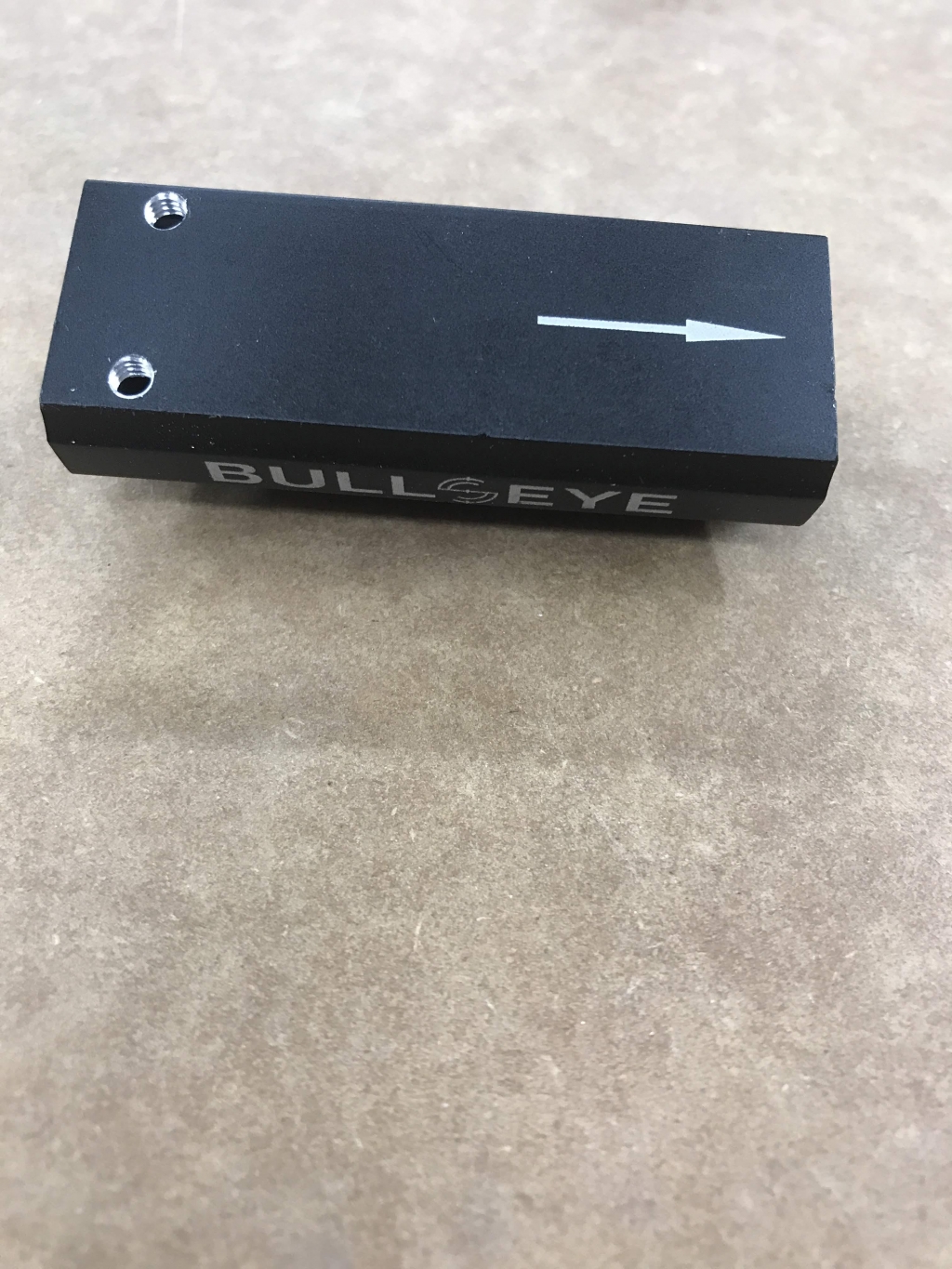

I went with a 4 grub configuration using 4M x 0.7 set screws (4mm). With the mount fully DISASSEMBLED I tapped holes in each of the 4 corners of the mount body to allow the set screws to intercept the rails upon re-assembly.
Each time you set a grub you compress the mount and lightly tighten the screw until the mount rail is "locked". Then you begin to loosen the grub until the moment the mount releases. Do this on all four corners and use blue lock tight so that the grubs stay exactly in position. We are talking thousandths here, so its very important that the screws don't turn from their position even a degree or two.
Damn if it didn't work (at least in the first few hundred pellets). The mount absorbs recoil and the rails slide freely but WITHOUT THE PLAY thanks to the light pressure applied by these grub screws.
It is important that the grubs are brass or some other material that is SOFTER than the steel rails, otherwise you'll end up scoring the rails as they slide for hundreds or thousands of shots. (I've got some brass on order, it was hard to find).
Among the photos I attached is a 10-shot 50 yard group shooting 16gn JSBs out of the Air King with its improved ZR mount. This was not achievable before the fix. The other pics show one of the grubs (just above my finger with blue lock tight visible).

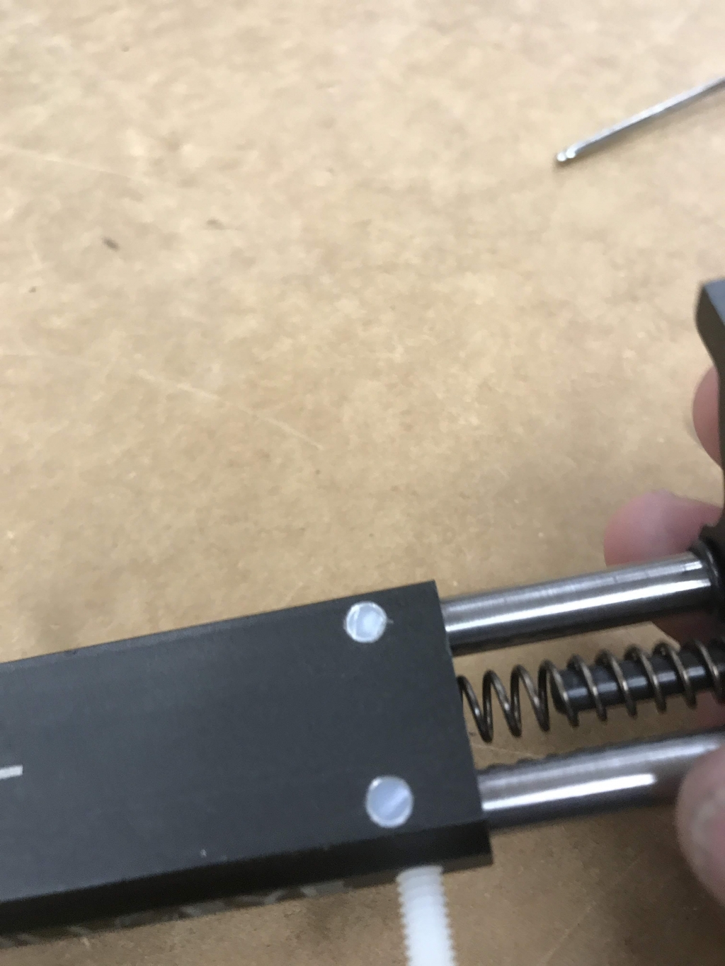

Thank you for covering this subject. This is now what I use on almost every springer. I would love to see them built this way from the factory (Hint to Diana). I first learned this trick from Hector Medina (many many field target springer championships with the 54/56 platform).
I do it the same way but first polish the shafts and tunnels then use nylon screws. They don't seem to back out or wear even over many thousands of rounds.
This was the first one I did. I did all 8 corners. Since this time I have found that one on top and one on one side has the same effect on accuracy. No more worries even on fragile scopes!
Lewis, thats awesome. What thread size and bolt? I love that you can just trim the nylon flush. I found there wasnt much metal to work with and that the top appeared a-bit thicker, which is why I went in there. The screws i installed with lock tight are just biting a few threads. And yes, I failed to mention I also lightly polished the rail and holes with some super fine wet-dry. I lubricated with gun oil.
Flex,
I don't remember the size but I used a 1.5 thread pitch nylon in a 1.0 thread pitch hole. This is an old machinist trick for things you don't want to move, you just have to make sure the sacrificial part is softer than the base material. This intentionally causes a slight cross thread. The bolt goes in but is extra tight. Any damage to the threads will be on the softer nylon and not the aluminum. This keeps them from backing out or moving. Worked PERFECT!. The nylon bolts are super cheap and could be replaced as often as you wanted. I have never had to touch them again and they have lots of use on them.
