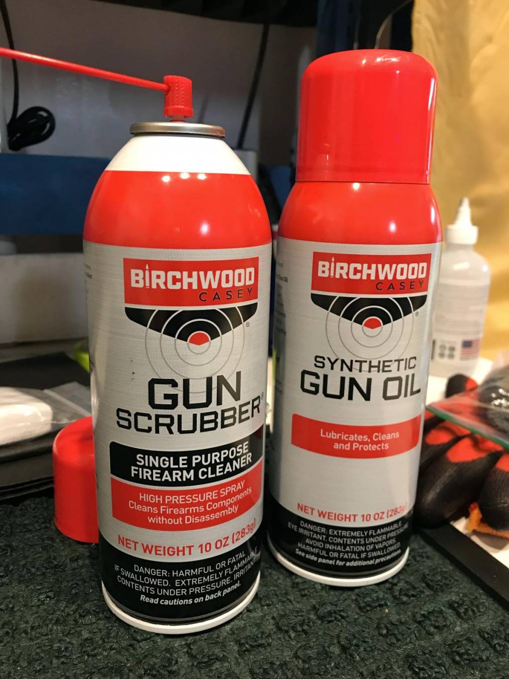

I can't speak with any level of real expertise, but allow me to try. :)
Most new guns, unless they're "tuned" or such, get a dose of these.
(Make sure you get the synthetics, don't use petroleum products on rubber. Kinda like Vaseline and condoms are a no-no! lol )

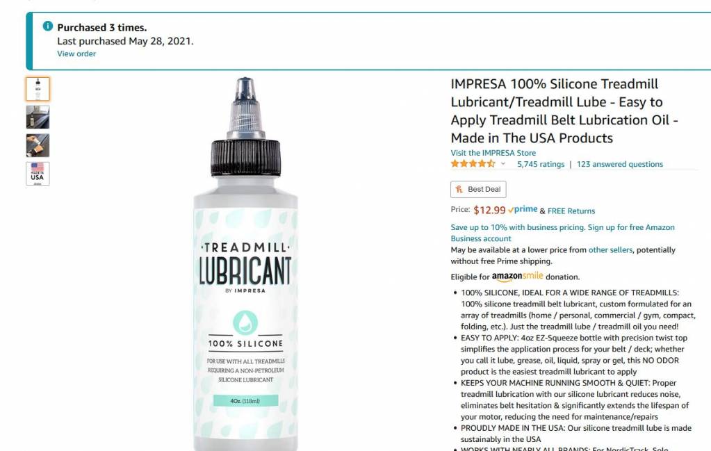

And a bottle of silicon oil for general lube-drips.... something like #ad this.

The lube in the rifle from the factory is petroleum based. That's why it diesels in the first place.
Breech seals in RWS guns if black or usually Buna rubber. Petroleum won't hurt them. The piston seal is either a type of nylon or urethane, and petroleum won't hurt them either.
There is not a single place on a spring piston air rifle for silicone oil to be used. It's a rubber lubricant and that's all. It offers near zero lubrication for steel, and will cause parts to gall under high heat (such as inside a compression tube). And it's an oil, so it will get everywhere inside, regardless of where you put it or want it to stay.

Synthetic oils can and most often are petroleum type oils. The are generally made either from natural gas or by breaking down and rebuilding the molecules in crude oil to get molecules of specific properties.
Silicon oils are also synthetics, some of the carbon, usually methyl groups have been replaced by silicon chemical groups. Silicon oils and greases are much more rubber friendly than pure carbon based or petroleum products, natural or synthetic, but from all I read do not have as good of a lubricating property. They do have a higher flash point hence the lack of the dieseling problem with pure carbon based lubricants.

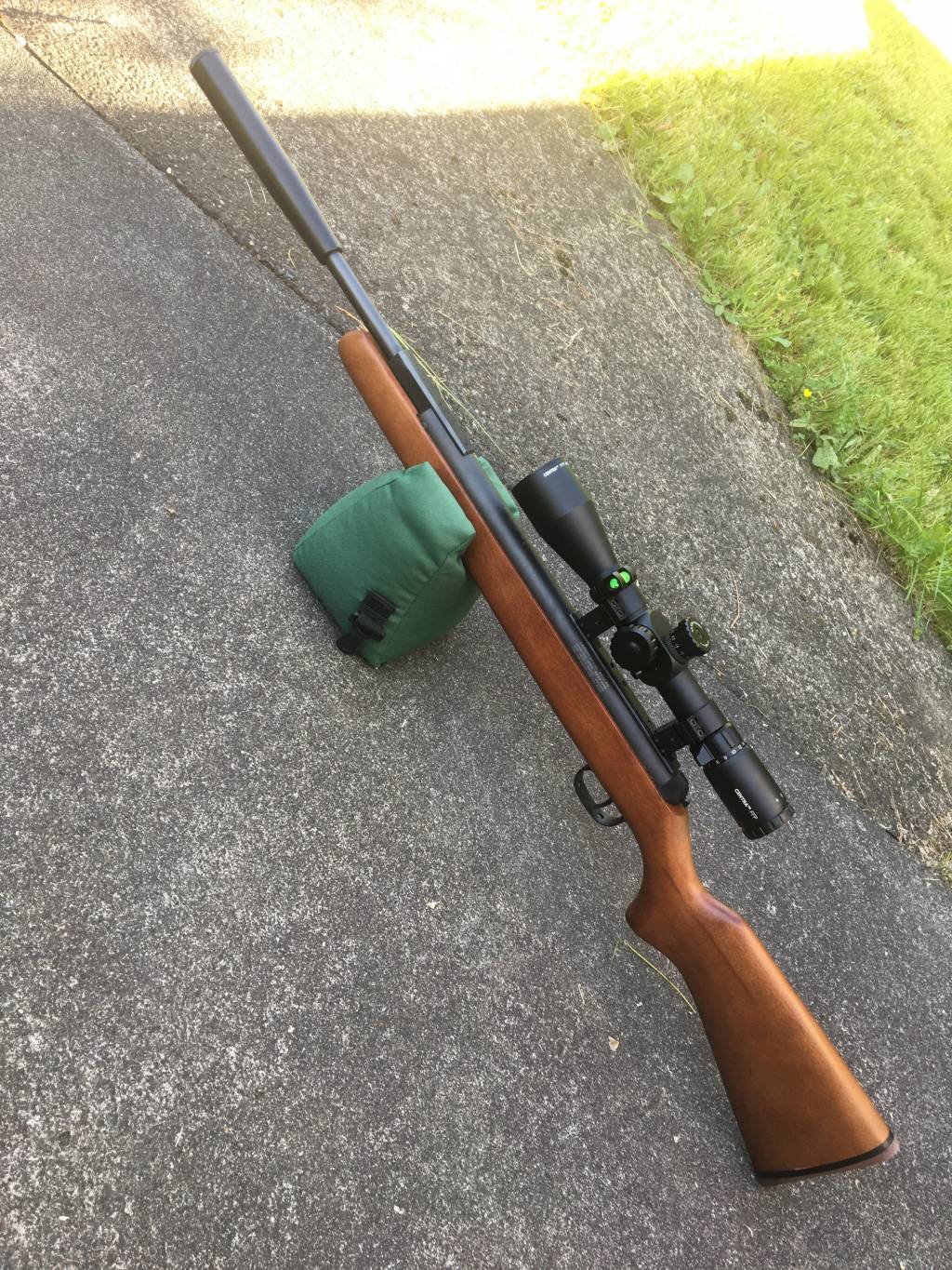

I got my 34 Meisterschutze pro compact here in the classifieds. Its been tuned a bit. Upgraded springs and such. Ive had it about a month. I have two PCPs but I’d been searching for a springer that I actually enjoy shooting. I added a rubber butt pad to help secure the buttstock when cocking. I am enjoying this gun. Good fun for my backyard plinking. And it takes a little more skill to accurately shoot a springer compared to a PCP. So the challenge is fun. The trigger is amazing for a break barrel. But now that I’ve been shooting it for a month there is a little more creep on the second stage than I’d like. So I’m going to look and see if I can adjust that out.
