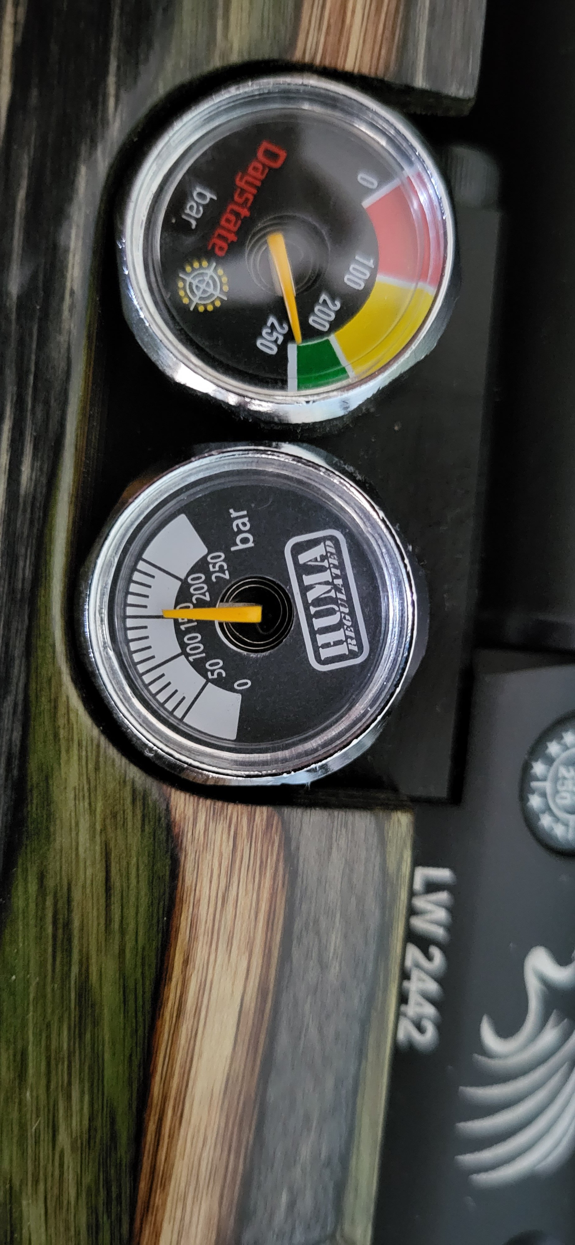

Marty and luck turn it down? what was your shot at 150
I have not attempted it yet. I also haven’t counted my shots but it is in the vicinity of about a hundred shots. I have not run out yet during the HFT matches I’ve attended, which is the prime reason I got this rifle over the Revere and HW100.
-Marty
Reactions: keith1
Mine came from the factory set just a hair under 150 according to the gauge. Gets over 220 shots on a 250 bar fill using JSB 10.3:

I'm calculating a zero percent chance of me improving on the Daystate factory tune- not going into the rifle until it's time to reseal.
Can't swear they all leave the factory this tight, even the best manufacturers give birth to a lemon every now & then. But I do think your reg pressure is in line with the average.
