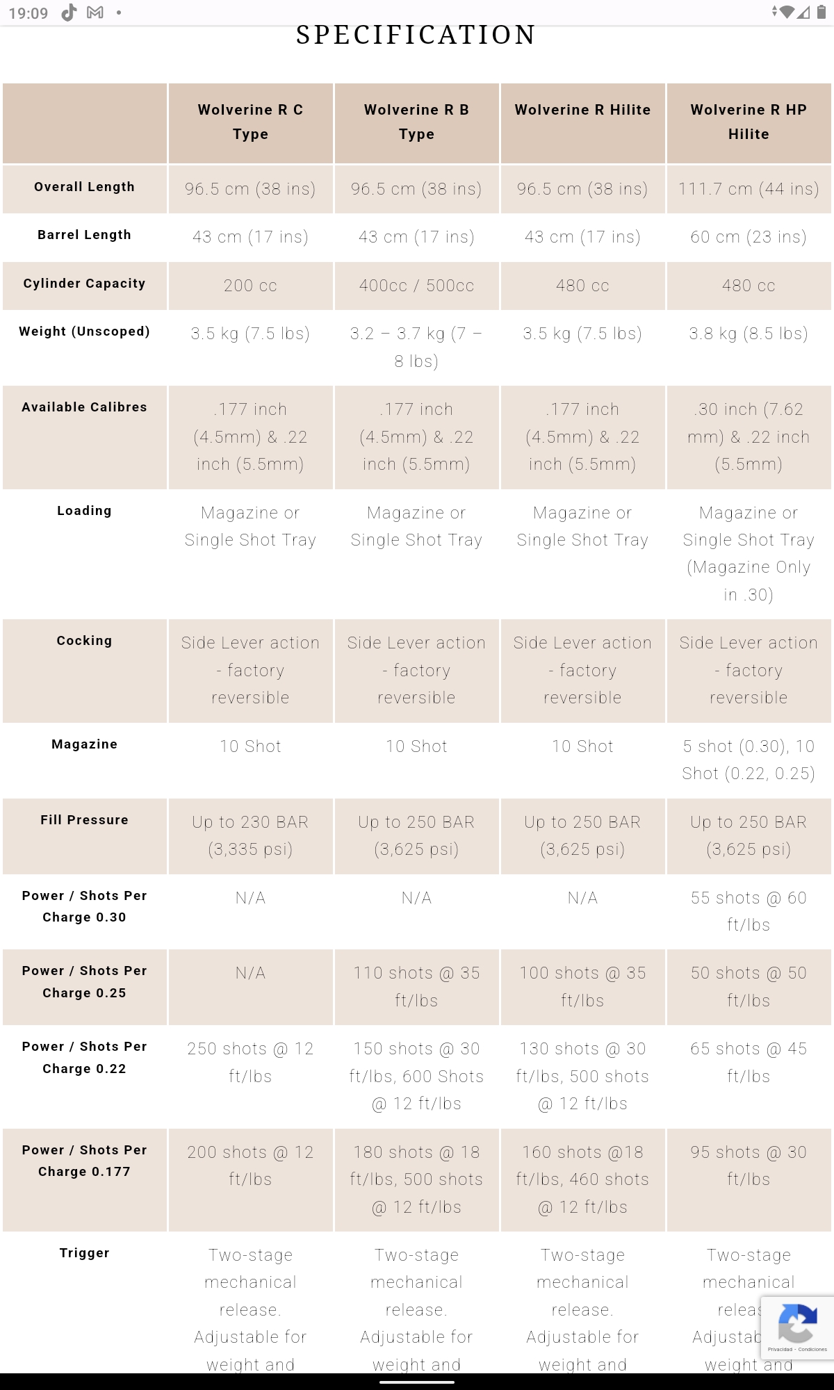

I have the non regulated one. You can get over 100 fpe. It is a big rifle for hunting but extremely accurate. Mine has the carbon bottle and with 50 grain pellets I get 15 shots at 50 yards to the same point of impact. The 30 caliber is devastating on Fox and raccoons. You can even take small hogs with head shots.

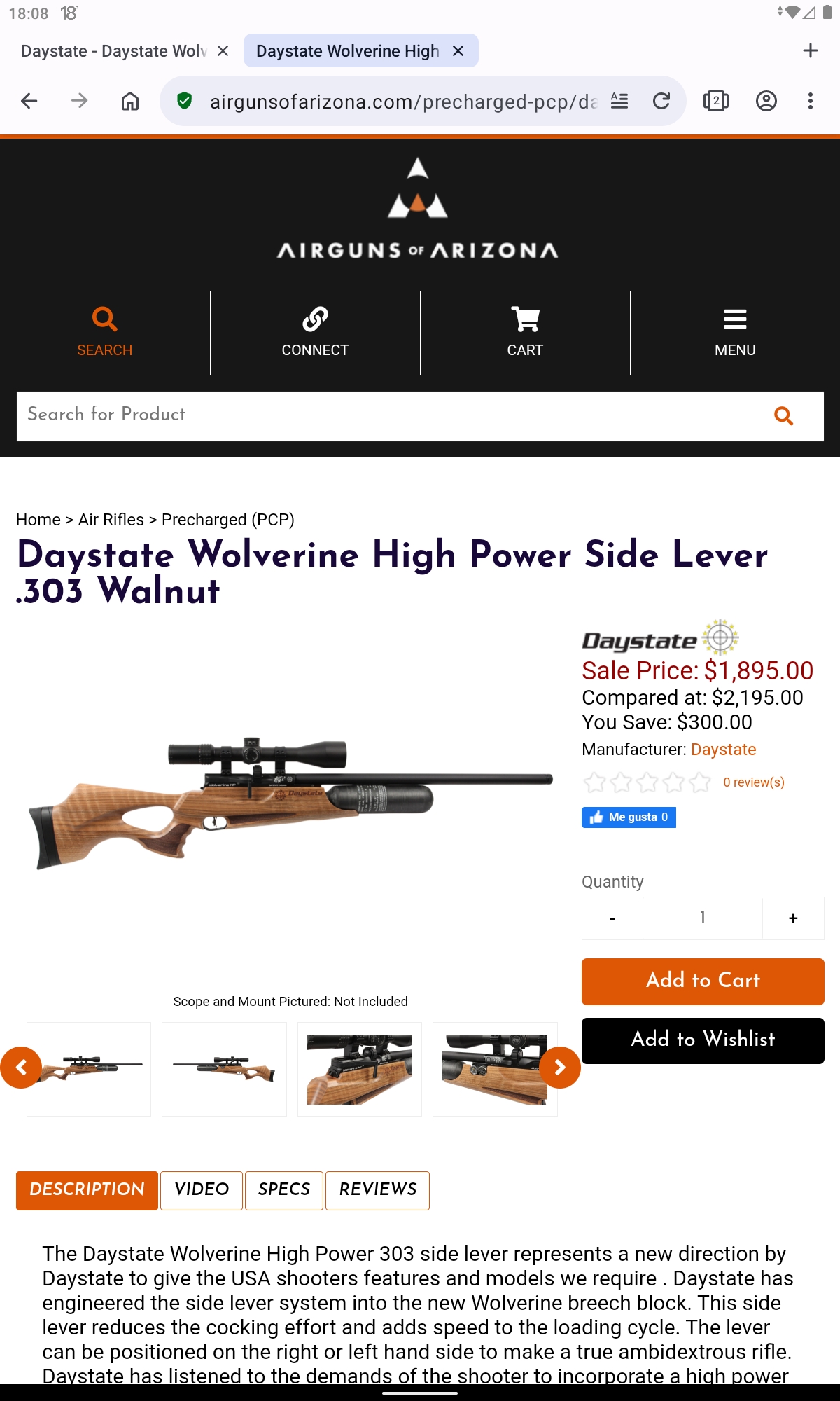

Thinking about one of these anyone got any advice or tips, mainly for hunting. AOA has a Holiday special on them . This would be my first PCP gun. Thanks for any help .Mike

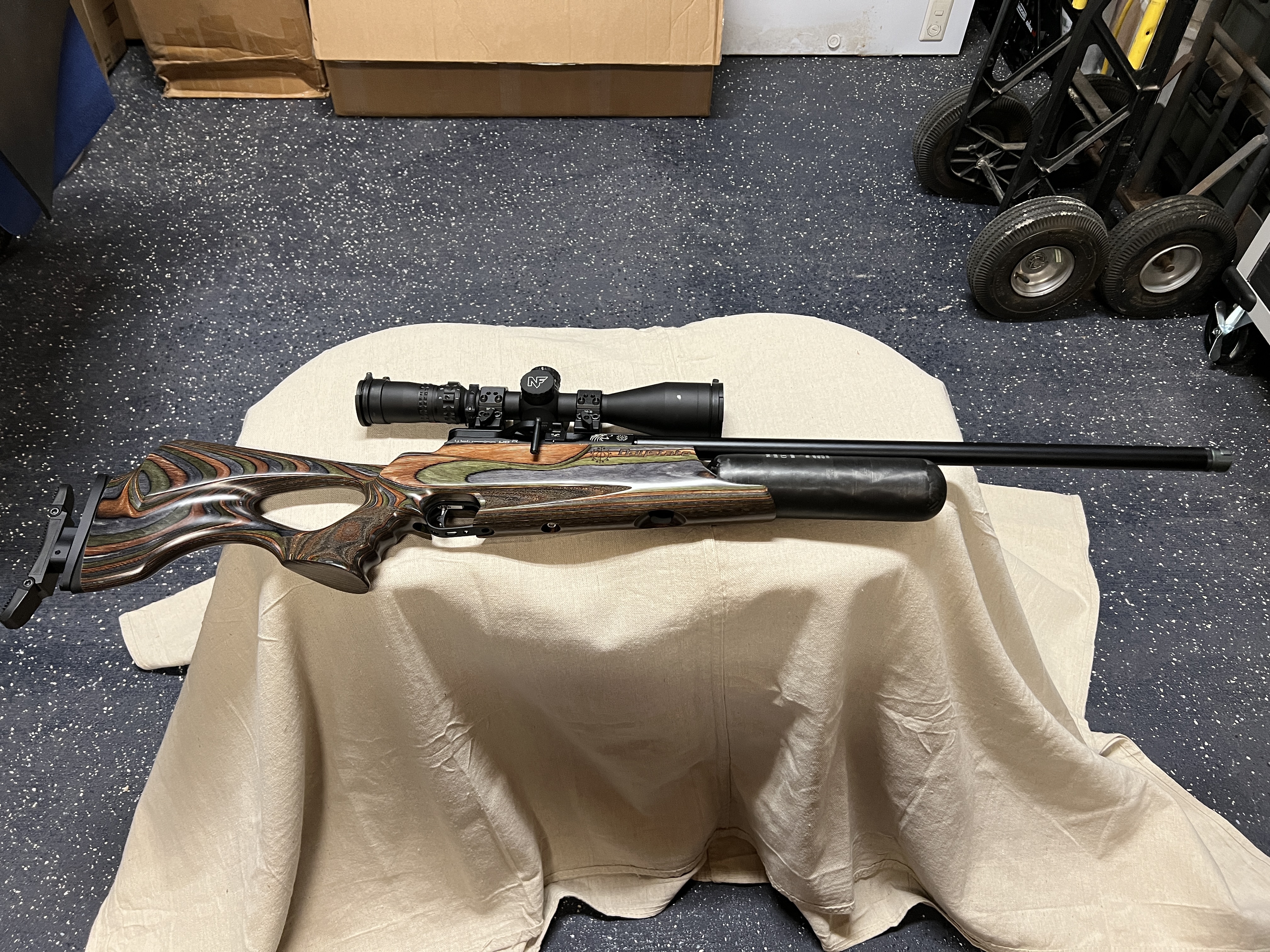

Actually 10.9 lbs scoped including my PRS accessories and moderator; but they are longish - quite a crack at the muzzle! If you want to know the weight(s) of some popular rigs for comparison = weights are fully loaded/prepped on digital scale:

I have the OG Wolverine .303 unregulated. I zeroed the rifle at 75 yards so one mil dot hold under for 50 yards and three mil dots hold over at 100 yards. The rifle is an air and pellet hog. A compressor and tank is needed. One tin of 150 pellets takes a large air tank below 250 bar in a hurry.
