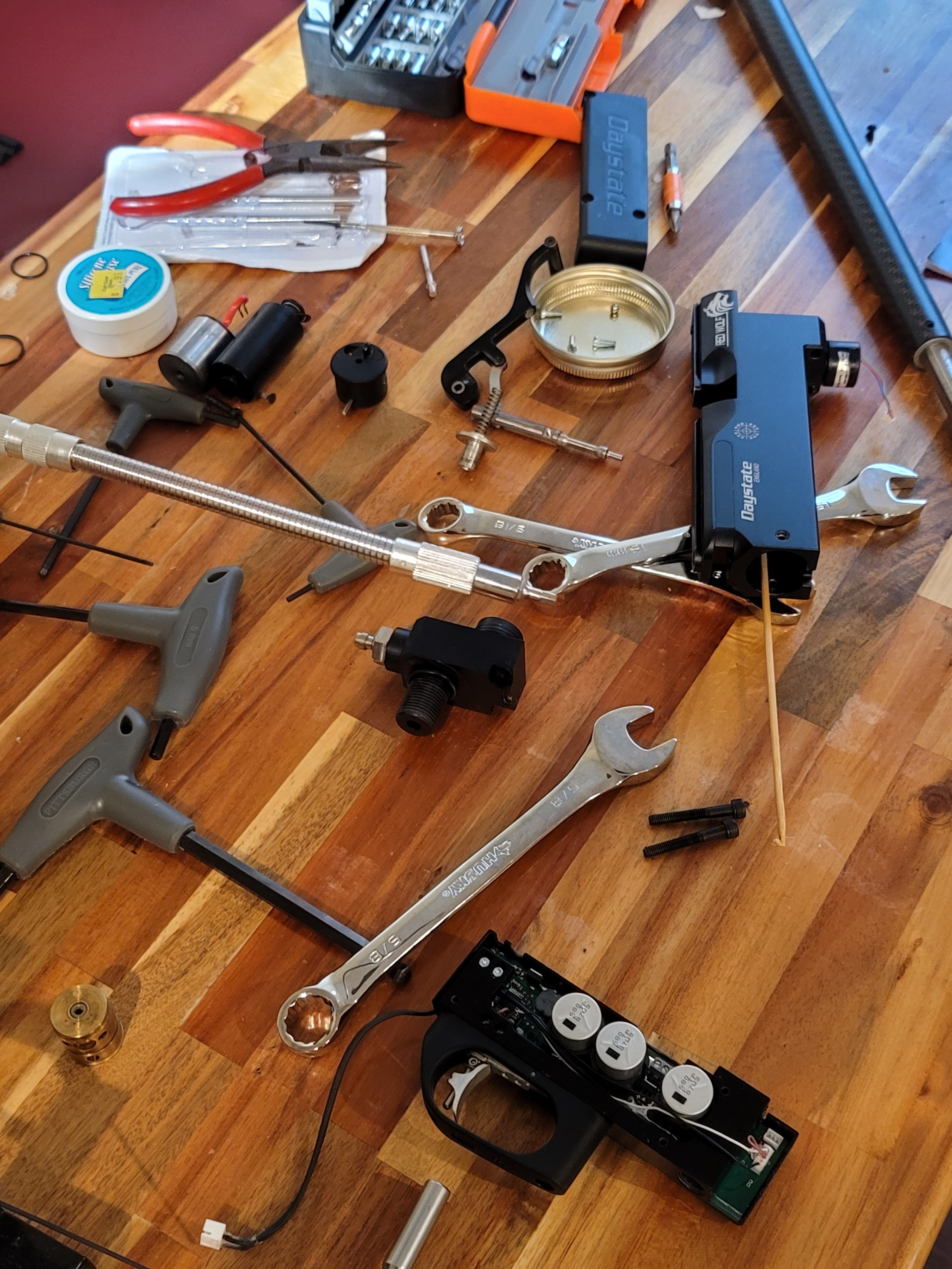

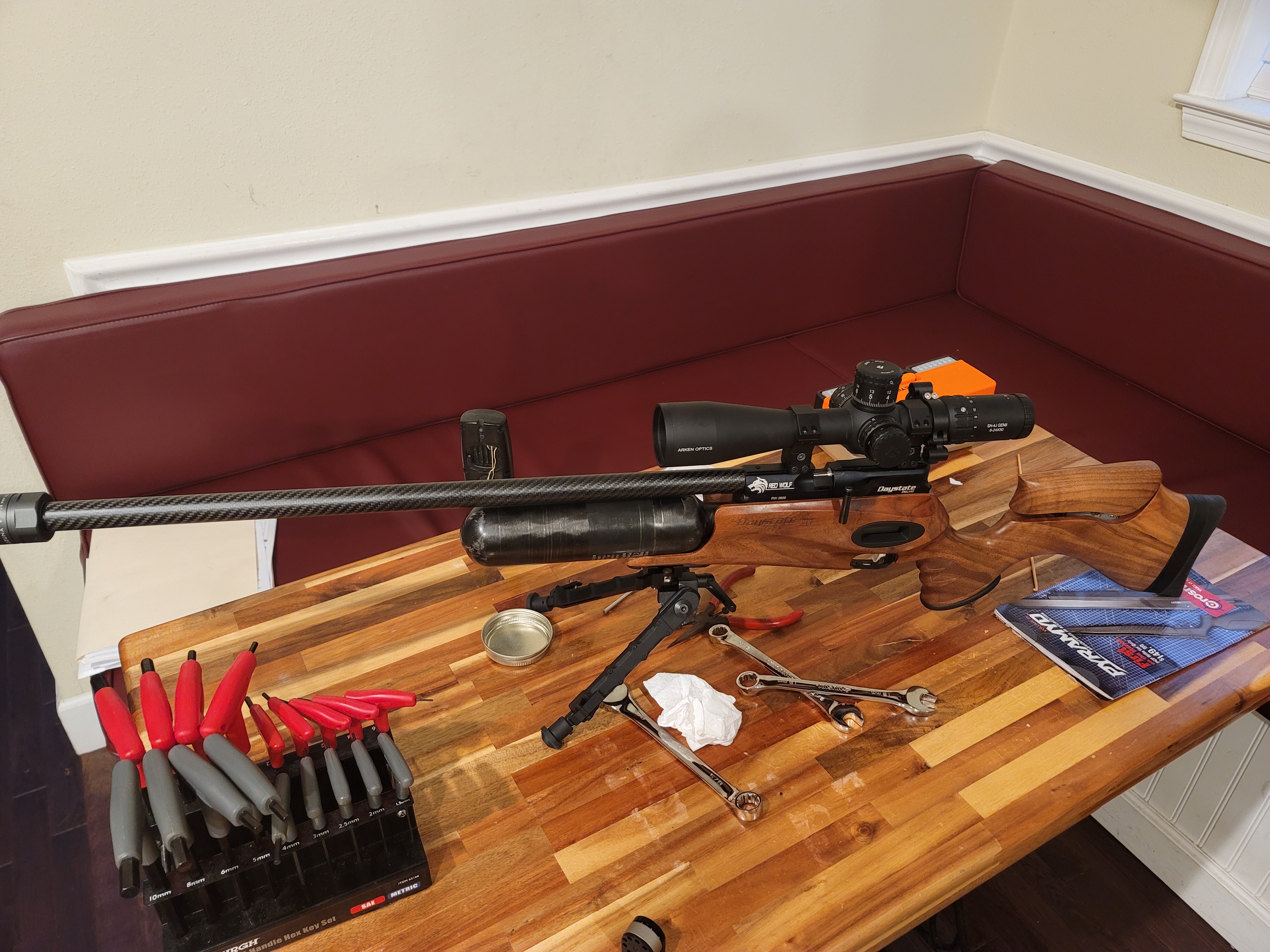

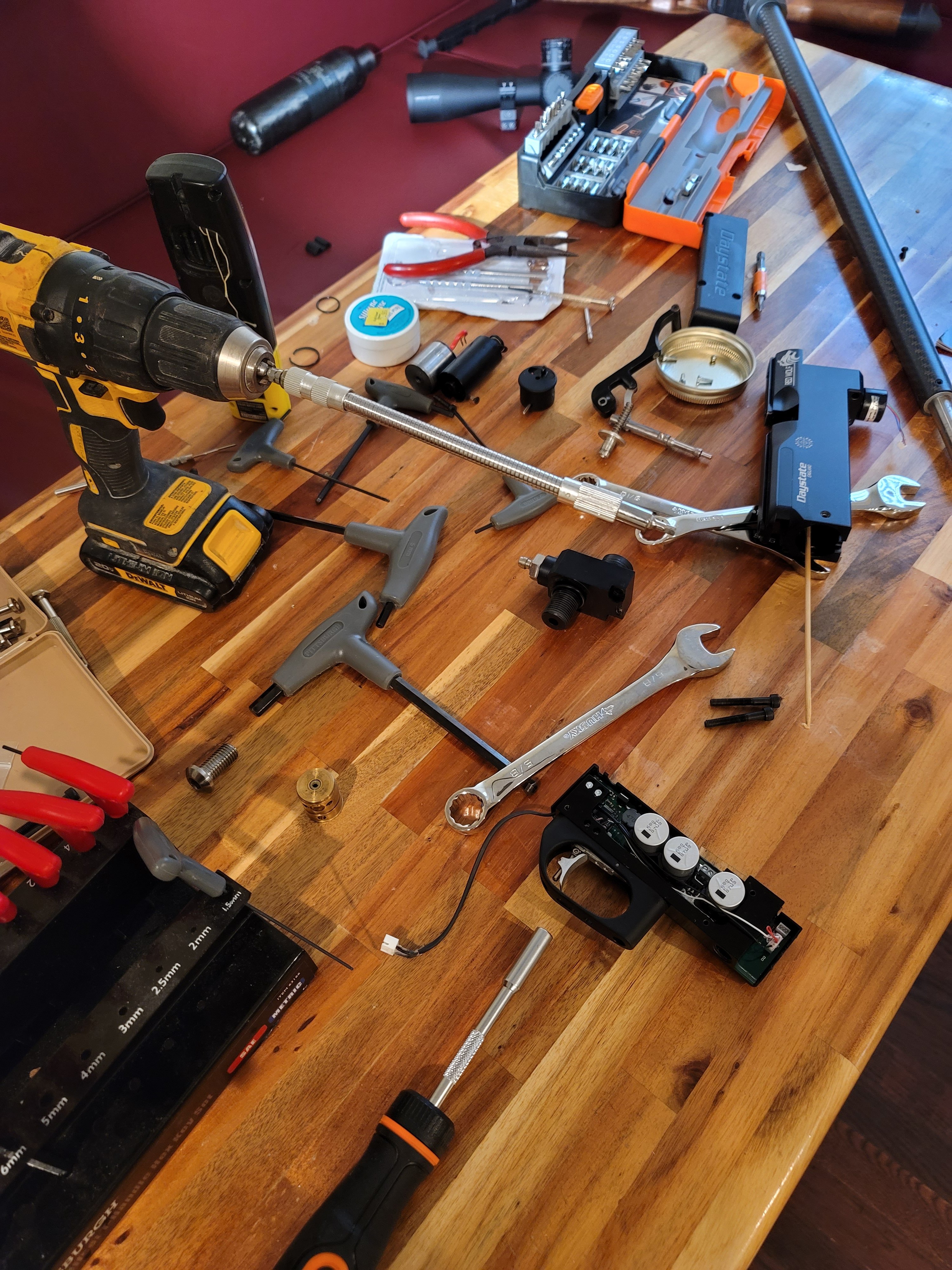

On last Friday I pull out my Redwolf just to take a couple of shots and notice that air pressure was very low but when I place it in the safe it had 210bar when i turned it on it showed 68bar so I call AoA and they sent me a Oring kit for the valve body the gun was leaking air out of the barrel, so Sunday I started surgery on my Redwolf and I am glad to say the patient is doing good 20240512_113723.jpg20240513_175028.jpg
