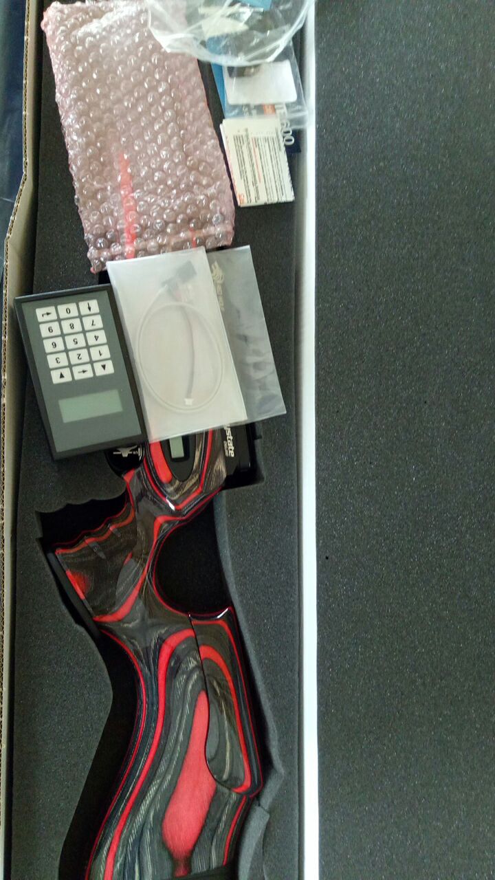

This is the first .25 caliber electronic rifle I purchased.

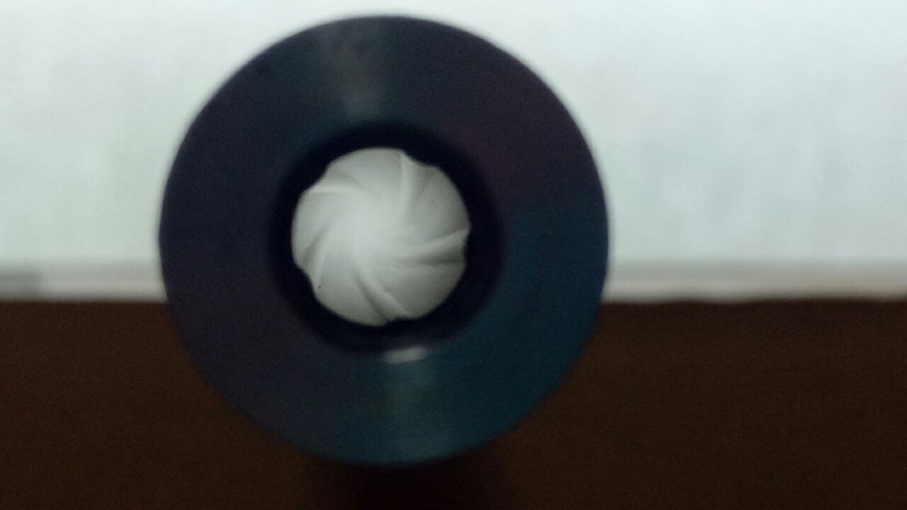

When I removed the barrel of the red wolf rifle, the inside of the barrel showed that it was a polygonal barrel with only 5 rifles, which reminded me of the fx slug barrel

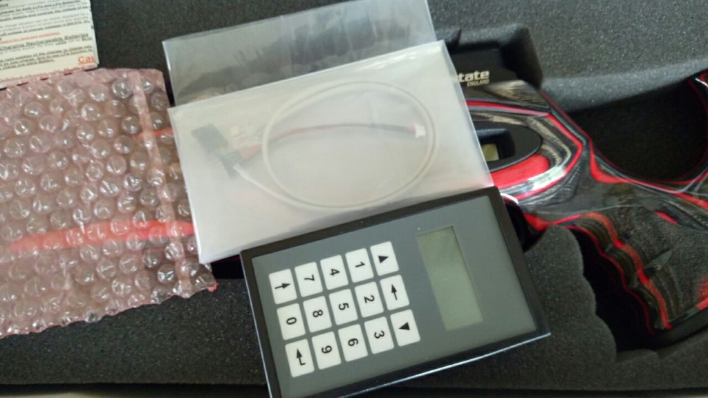

My dealer gave me a daystate electronic programmer. Does this programmer have all the data of the original daystate red wolf built in?

On the programer usually not (have the data of your RW) you need to save it AoA video is pretty good
https://www.youtube.com/watch?v=jG3Y74va4TM

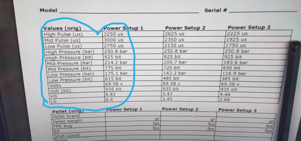

In one setup, I did not save the original data of my rifle. Who can share the original data of red wolf HP. 25 caliber?
This is bad news. My dealer told me that the red wolf data was built into the daystate programmer, and I was determined to buy this rifle. For me, this electronic rifle is a completely new field.
There should be a factory setting that it can go back to. I’ve never done it, but that is what I understand it to be. Hopefully someone who has messed with a programmer can jump in.
I watched many videos of Mr. Michael (including AOA) many times. I learned how to use my daystate programmer (only to modify and save data) but I ca n’t understand what each type of data represents and what role they play. This It is a very complicated data. I want to set up my red wolf HP.25 caliber rifle, using JSB MK2 33.95GR speed to reach 925Fps, can you share this data?
I can't understand the data in the picture. What role does the data play? So I want to get the data that can be used directly, or the original data

https://www.airgunnation.com/topic/red-wolf-standard-with-g2-board/
Check that link out for a description of understanding and learning how to do the programming, and what each parameter represents. It's buried in the details, but it's there.
I understand every individual gun leaves the factory with settings unique to that particular gun.

If you have changed your factory settings without recording them, you will have to try and email daystate. They will need your serial number and they may be able to give you the factory settings as it was programmed when it left the factory. Each red wolf is programmed differently so someone elses numbers may not work for yours.

EXACTLY...worst case scenario you have to send your gun back to the dealer to have it reprogrammed. Yo!
