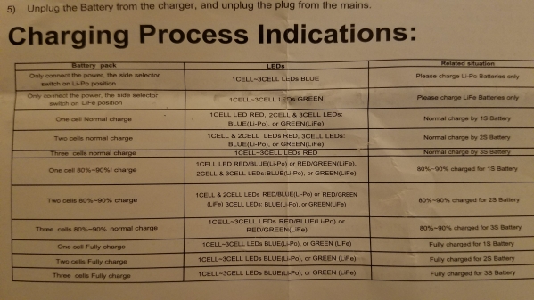

The lipo requires special lipo charger, cannot use a regular nmih or LiFe battery charger. The 2s lipo need a balanced charger which charges each cell separately and evenly. That's why it has 3 prongs, one for ground and two for voltage for each cells. The charger cuts off at 4.2V charge for each cell.

So your charger may be bad. Or you charger connections going to the battery are lose. Or the battery went way below 2.8V and the charger won't kick in. Either way to do any troubleshooting you must be able to read the voltage on the battery pins. And go from there.
If the lipo is dead, the "dead" lipo can be recharged by raising the voltage in it to at least 3V level so the charger will "recognize" it again and allows charging. One way to do that is to take 3V-3.3V from another battery to each cell and slowly build back up the voltage to above 3V inside. Do not use much higher voltages or it could damage the battery.
