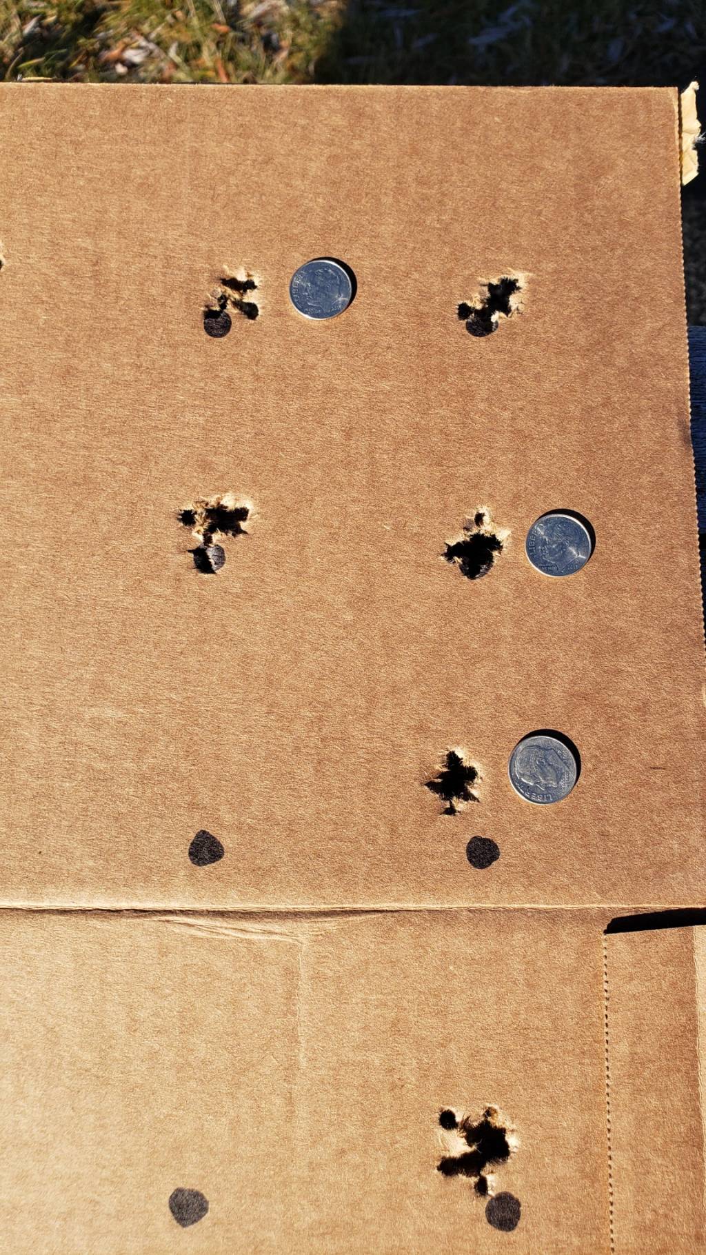

Started playing with the new Crown the other day, put the 700mm barrel on it and have been shooting the JSB 25 grain. I've watched all the Crown tuning vids 2 or 3 times and I feel like I have a pretty good idea of how to adjust the gun. That being said, I can't seem to find that sweet spot for the harmonic tuning. I have about 700 rounds through it now trying different settings, etc and have had a little luck but just can't get to that euphoric spot with the gun where I know it can be.
Best results I've had was with the reg pressure at 125 and 4 clicks to the left with the hammer spring from Max toward Min, transfer port at Max. I'm attaching a pic of the target I've been using and the 4 ten shot groups that were shot at this setting have a dime over them for visual reference. I know these groups look pretty good but I've done a little better with a previous FX 500. My attempt to tighten these up with tiny adjustments failed and I've been unable to reproduce the results. I've turned the reg up or down as little as 1/16 of a turn, dry fire five shots and then try several groups. I feel like I've been up and down the reg and the hammer spring. Mostly trying to keep velocities in the 850 to 890 range.
Does anyone know a good starting point to get the best results? I know all guns are different, just looking for ideas. Also, I have not altered the internal factory hammer spring setting yet.

All groups shot at exactly 50 yards. Some sighters. The dime covered groups look pretty good here but just not quite good enough I think to hold up at 100 yards, trying to squeeze a little more out. Regardless, have not been able to reproduce those results after changing settings back. No wind when I've been shooting.
most look good to me ,700 rounds not many for new gun...imo
You're probably right, I went back and looked at old pics of what my Royale 500 did and it was basically those 4 10 shot groups that are covered with a dime. I think I'm just going to keep trying to replicate that setting and see if I can get back to it. I know what the hammer spring was set to so only need to get the reg adjusted back.

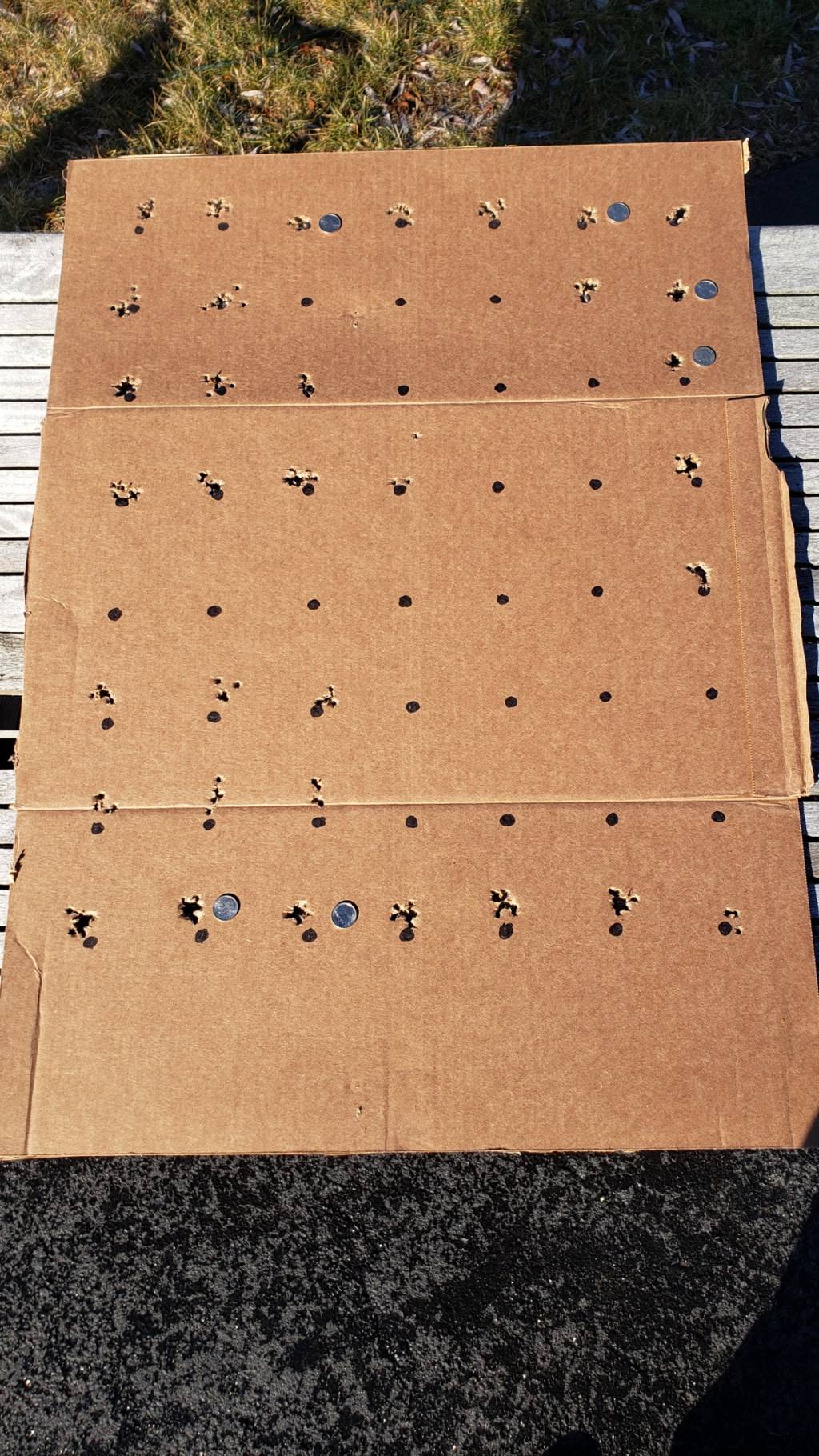

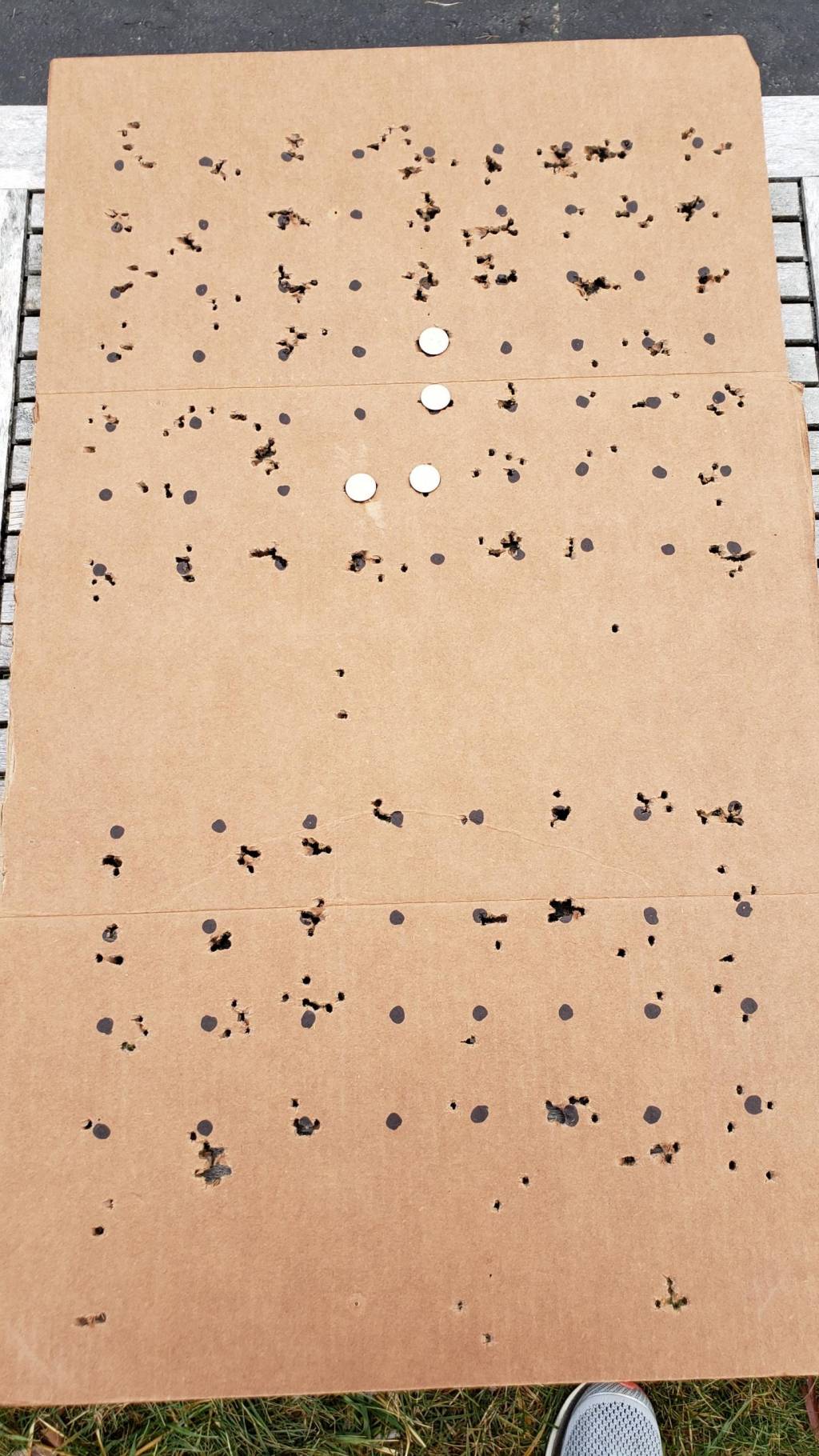

Quick update. I'm slowly but surely learning the tuning process. Watching the Ernest Rowe master class video a few times has been a great help. I watched Ted's recent video where he says his current .30 Impact is the best shooter he's ever had and what his settings are on it. I was surprised to hear him say his reg is only set to 90 bar. This seems to match AEAC / Steve Chally (spelling?) philosophy that lowering the reg pressure means the hammer spring can strike with less force and the shot cycle is less violent resulting in better consistency or at least easier to achive.
Anyway, I dropped my reg pressure to just below 110 and adjusted the hammer spring and have played with and tweaked it a few times. The following target is again, almost all10 shot groups with dimes put next to the best groups for reference. It's getting there, but the target that is in the OP still has 4, ten shot groups back to back with no fliers that can all easily be covered with a dime and that is what I am trying to get back to. That is what I used to be able to do with my previous Royale. It's in this continuum somewhere, I just need to find it so will continue playing and tweaking and report back with any meaningful progress.
All groups shot at exactly 51 yards from the muzzle. JSB 25 grain. ~895 to 900 fps average. Groups in the upper left were all shot yesterday. The upper right and bottom of target shot today after slight hammer spring adjustment.
