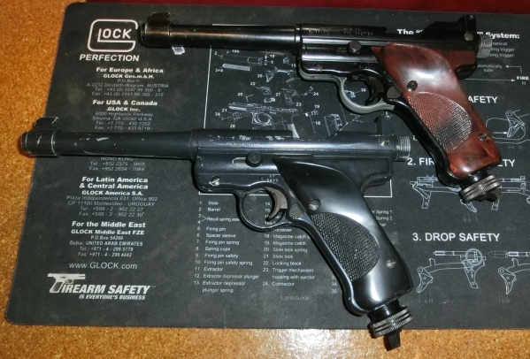

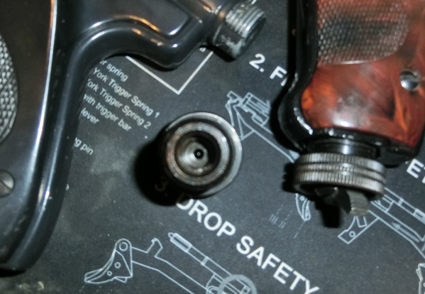

It's all pretty strait forward, except...the piercing knob, have the right sized tool for it, don't force the threaded cup part to hard it will maul really easy. If it don't want to come loose, maybe soak it in some oil, like Kroil, if it still don't want to come loose, heat it lightly with a propane torch, it should come loose then. That's the only hard part of rebuilding a Crosman Mark pistol, that and getting some of the pieces apart, they can be tight sometimes. This is the part I'm talking about and a pic of my two pistols. Good luck.

For sure take heed of the last foot note in Diamondbacks post. I made a tool from a large screwdriver I had, ground it down on a grinder till it fit perfectly. proceed cautiously at this point, as these parts are irreplaceable. Mac1 is the place for these pistols, if you feel unsure about it you can send to Mac1 to rebuild also.
