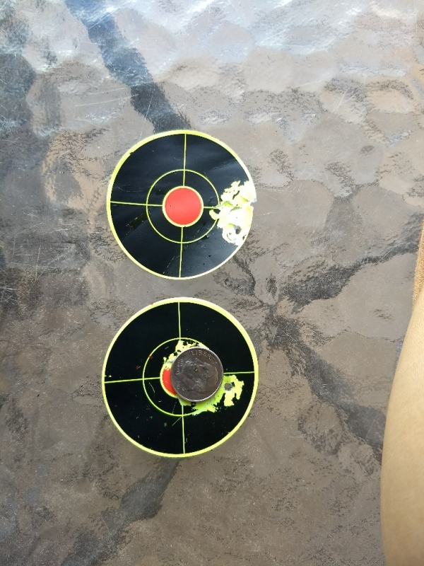

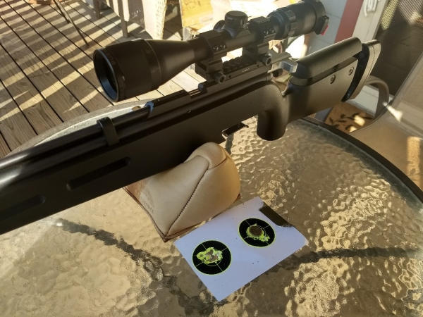

I just took it outside and shot two groups at 25 yards. Both groups were 10 shots. the group on the right was shot at 720 feet per second with an 8.2 grain pellet. The one on the left was with the power adjuster cranked all the way in with about an eighth of an inch left and it is averaging 803 foot per second. 9 out of the 10 shots fit under a nickel. They were shot quickly just off of a front bag and the pellet is not the most accurate it is the h & n sport flat nosed pellet. I am definitely not getting the flyers that were talked about. Trust me very little effort went into shooting these two groups. And these were the only two groups shot. The taking the gun apart and drilling out the transfer port whole process took about 25 minutes. Will go try some heavy hunting pellets.

Shawnlyndy also shoot it over the chrony using a steady firm rifle rest and just experiment and set the power at what is the most accurate velocity because you should easily get one hole groups the size of 1/4" or less (25 caliber pellet hole size) at 25 yards 10 shot groups when set correctly. Make sure you shoot it for groups on paper targets as you are running it over the chrony so you know what velocity will give you the tightest groups. Upping the power too much just to get a higher velocity may not get the best one hole groupings in the Challenger FYI. I know you are a target shooter so don't focus on power then you will achieve the best consistant accuracy out of your gun.
