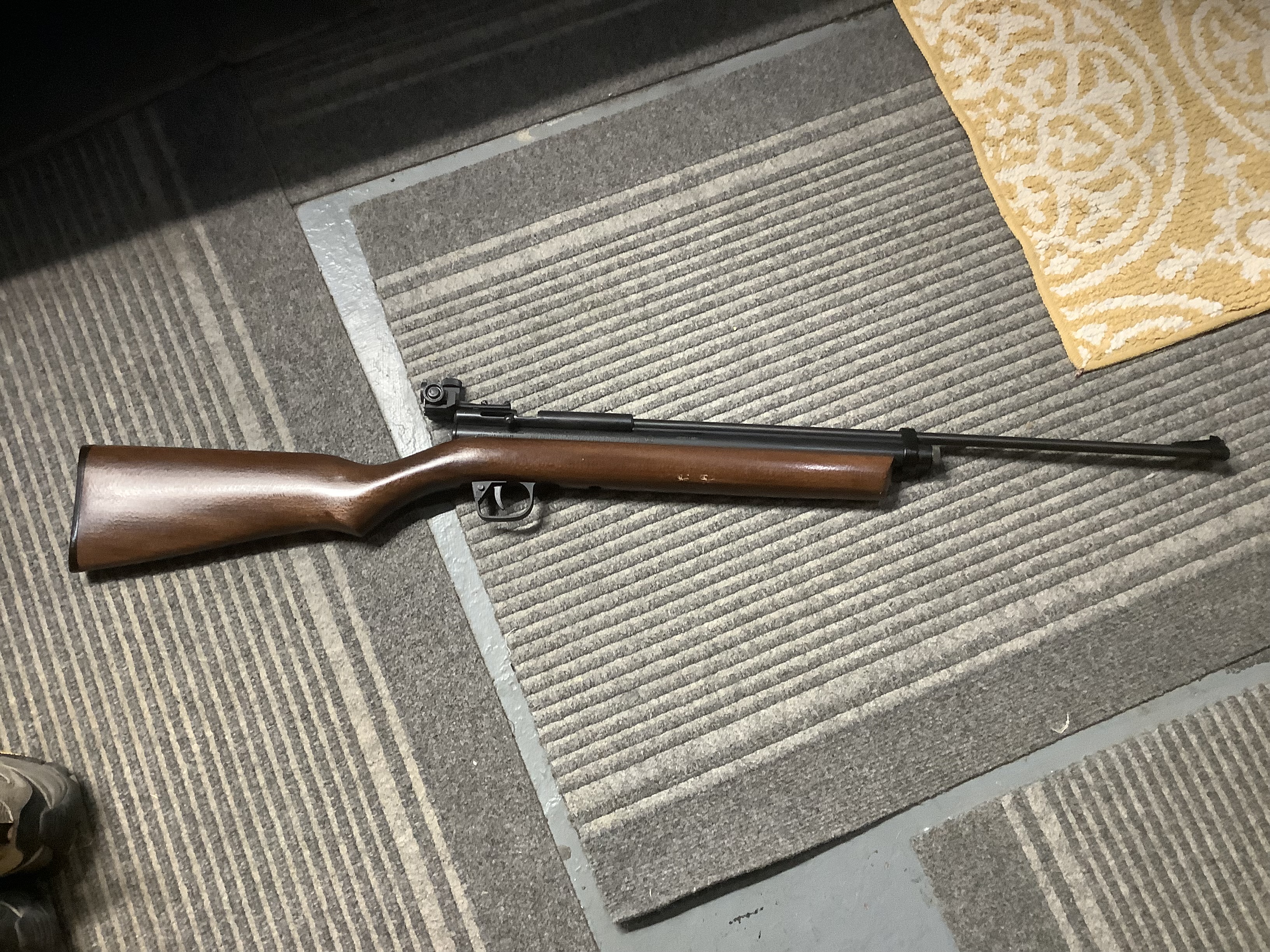

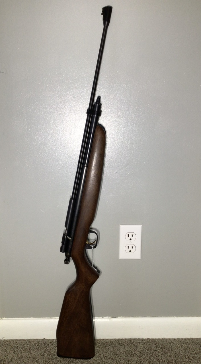

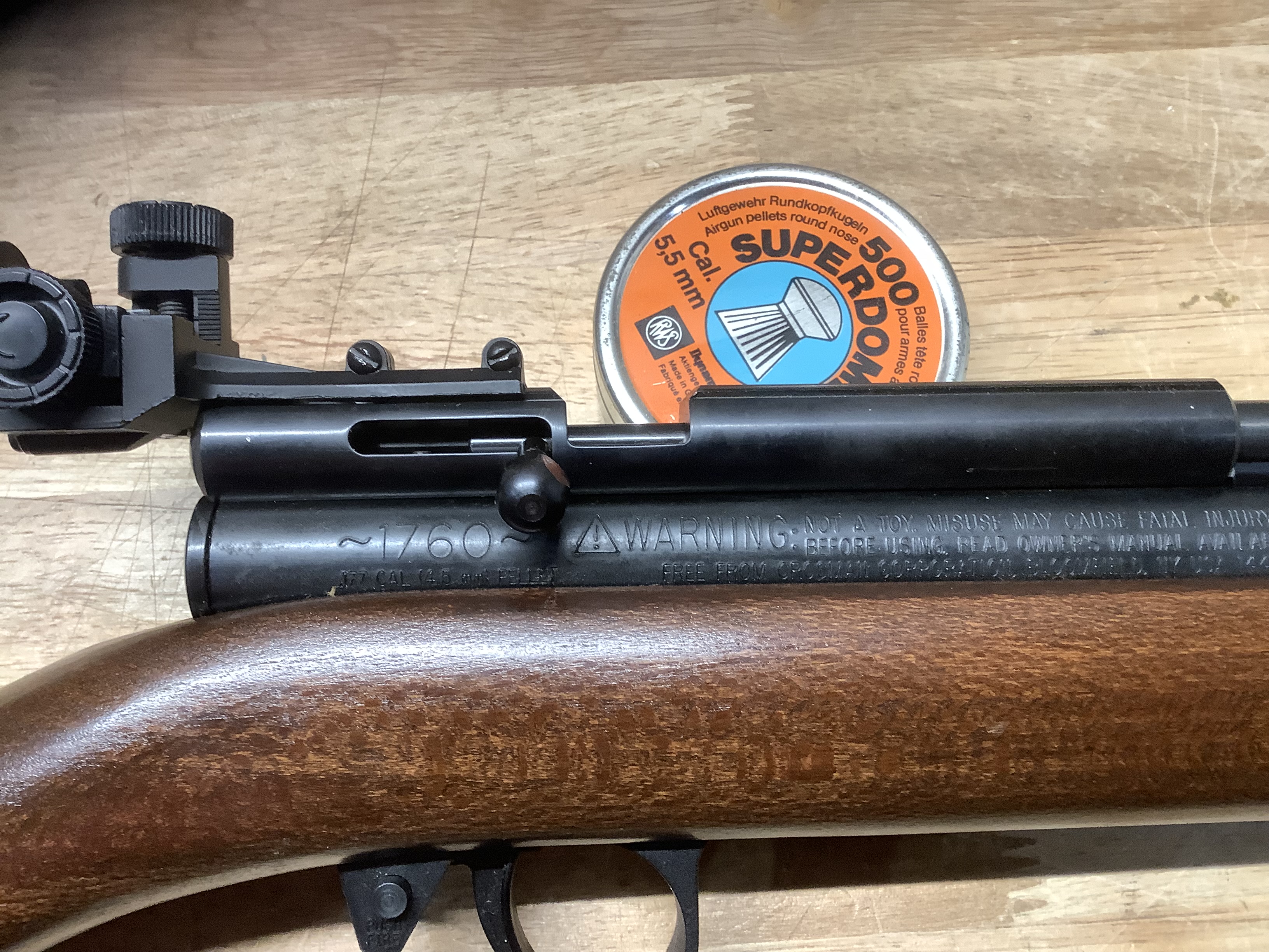

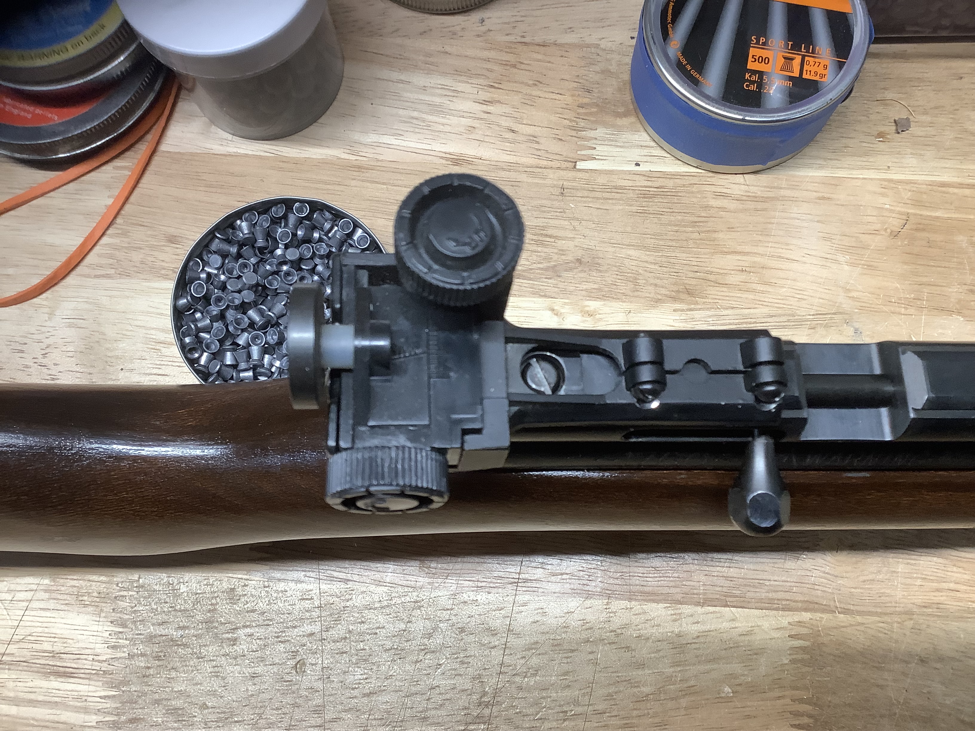

Pick this up here a the forum a few months back. Decided to add the steel breech I had in my parts box. Then was on the hunt for Williams peep sight, didn’t find one but had this Daisy peep from another project. Very happy with the results.
A gen 1 Mrod trigger will fit these with a little bit of work. Basically needs some .035" shims on the screws between the trigger group and tube. HUGE IMPROVEMENT! You would have to fashion up your own trigger guard, I don't think you can find the one's Norm used to make from DiscosRus.

Found mine on ePay - listed as, Crosman 22 not working needs seals. Could tell was nicely assembled 2240/50 with older Hy-pac adapter. Turned out 2B a 2250, 177 cal, and HS adj was max in holding the valve open. Still haven’t taken it down for a thorough inspection yet. Planning for it to be a peep sited plinker like yours
