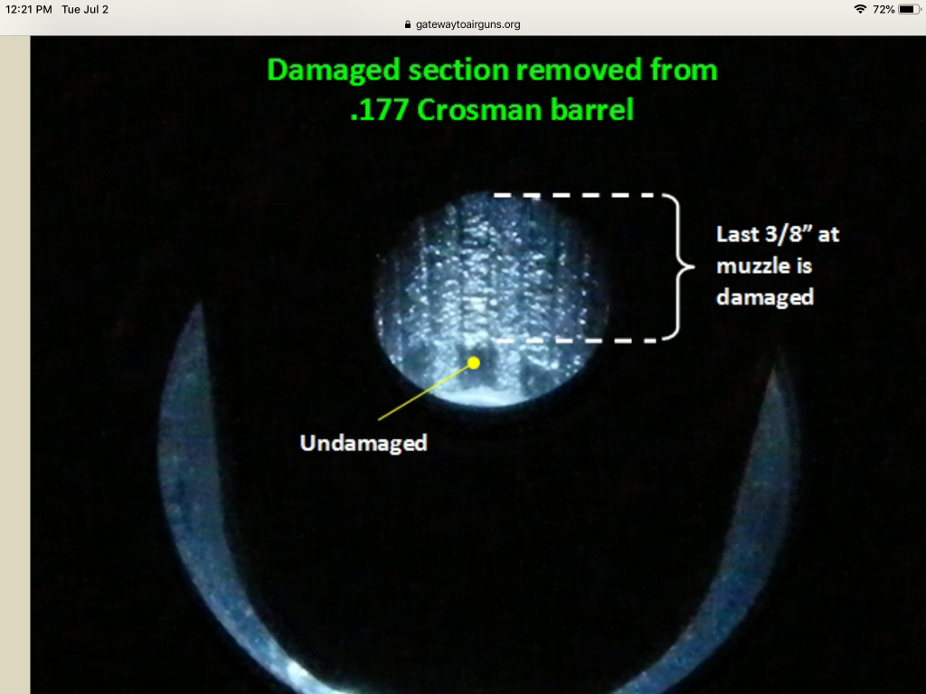

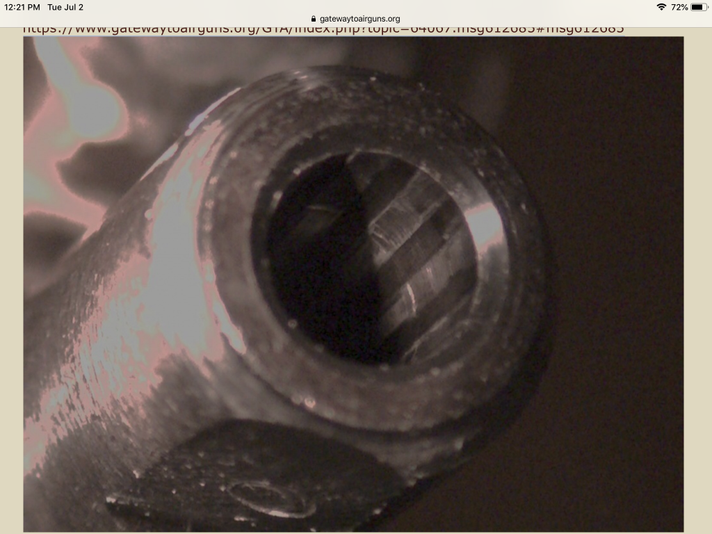

Inspect your crown and the rifling just inside the muzzle. Fliers are usually a last inch of the barrel issue. Crosman has been known to chew up the rifling just in from the muzzle. When your gun was really dirty, it may have masked the issue.
Was wondering about that. Is there a possibility that I damaged the crown with weedeater cord while cleaning it? I was hot, frustrated, and whipping those patches through there with "attitude".
1562084620_13325014325d1b850c7c3f75.05610713_A44EE883-A017-4BB5-923C-FE6BE0D36E95.png
Inspect the rifling inside the muzzle and look for chatter marks before you do anything.
I kinda did. Nothing glaringly obvious, but I'm kinda bugged that the rifling is so shallow and hardly even noticable throughout the length of the 14" barrel.
It almost looks like a smooth bore with tiny TINY scratches for rifling.
