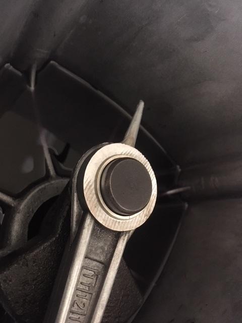

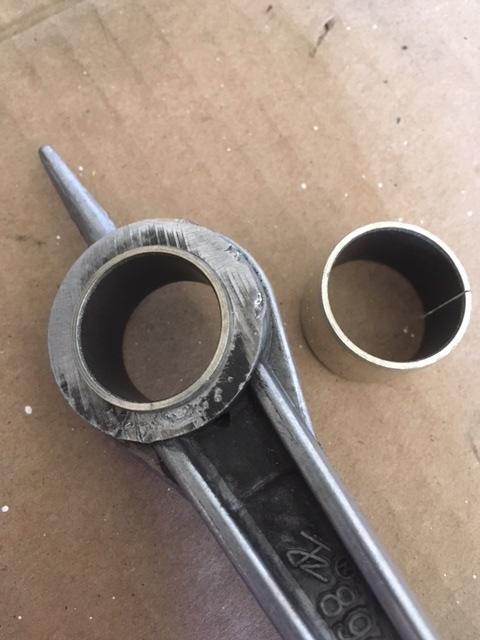

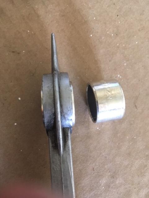

I had a rod go on my brand new compressor. The company sent me a whole new top end. The original rod can be rebuilt so that is what I proceeded to do. I purchased some self lubricating bearings and had the rod bored out to size. the rod was a nice slip fit on the bearing shaft. I am trying to up load pictures not sure if I can had some errors earlier. It is a steel bearing with a self lubricating surface. I was wondering if anyone has attempted this and do they think I am headed in the right direction. the bearings are only about 3.00 each so I bought 5 of them. Anyone interested in one I can send them one. If it doesn't work I still have a whole new top end.

What about any side thrust the original rod is very smooth on both sides and you will also have to be very accurate with the stroke as not to hit the top of the 2nd stage piston to the top of the cylinder. I had my first unit which was a vevor seize when the oil slinger broke off, I ended up replacing the rod and crank and have had no problems since. Good luck with this setup if it works you will be extending the life of the unit quit a bit.

This is the original rod. I caught it before it was completely destroyed. Boring it out cleaned it up. You can see a little bit of galding left on the face. I will have to rotate it by hand to see if it hits the head. There was 180 degrees of clean surface to indicate in. I would hope I have a few thousandths of a inch to work with. If it hits I can try a shim. Plus I have a whole new top end. Thanks for the information.

I probably wouldn't buy another one of these compressors. I new it was a chance when I bought it. I see some people swear by them and some swear at them. I am hoping this will be a good fix. time will tell. As far as any help If you have a 20mm diameter bearing journal I can send you one of these bearings. You need to bore the rod to 23mm that should give you the 20mm rod diameter. It would cost about 7.00 with shipping. Then you would need to find someone to bore the rod out and press the bearing in. Someone in airgunnation should have a Bridgeport mill that would bore it for you. I found a guy that I did a little swap with did it for me. It is a big decision to buy a 1200.00 system.

Well folks just an update on my rod repair. I finally got around to putting the pump back together and gave it a test run and filled up the bottle on my crown. It ran for about 3-4 minutes (I only needed about 40 bar) and got up to a temp of 40 C (104 F). It seemed to hold about there. No rod rapping (a good thing).
This was a self lubricating bearing plus I put the blue oil in it.
I thought some people might be interested. I will update as I get more fills and try a bigger bottle.
No not that concerned. If it breaks it didn't work. If it lasts it worked. I will be able to tell by the sound if the bearing is going and I can drive out the bushing and put a new one in. I have more sleeves if that happens. I figure anything is better than Aluminum on steel. I have a whole new top end for it also.6
