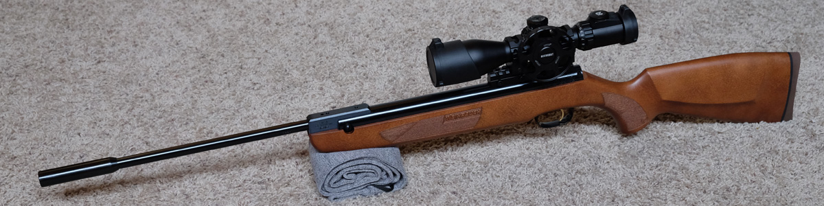

Here is my current setup. I like having lots of room for loading, and I like the rear weight balance. This is why I'd prefer a compact scope. It doesn't sound like there are a lot of options though... 🫤
