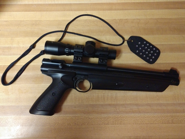

A souped-up 1322 can be an excellent small-game pistol, Fishin. Got a photo and details?
Nothing you haven't seen before....
Steel breech.
Enlarged and re-sealed (with bic lighter O-rings) transfer port.
Double O-rings on the bolt probe for a snug lockup.
Bearing trigger trick, and all moving parts polished smooth.
Stock piston & valve with polished and coned exhaust port.
Piece of bicycle inner tube along the bottom of the cylinder to quiet the SMACK SMACK SMACK while pumping it up.

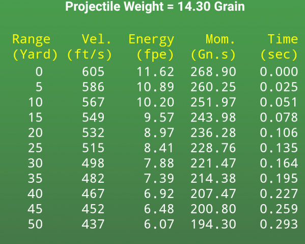

10 pumps View attachment MTU0NzYyMzAyNV8xOTI4OTEyNjMwNWMzZWRhNzEyMjE5YjMuNDM2NTE3NjlfU2NyZWVuc2hvdF8yMDE4MDQwNy0xNTIwMzJ+Mi5wbmc=

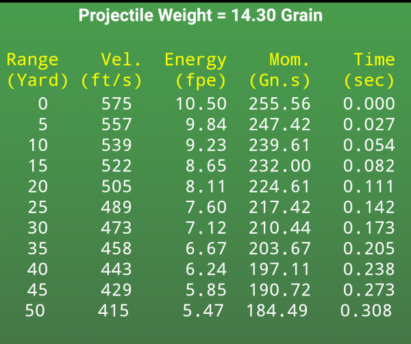

15 pumps View attachment MTU0NzYyMzA4NF8xMTkxNjExMDMxNWMzZWRhYWNlOGNlMzcuMzk2NzM0MzRfU2NyZWVuc2hvdF8yMDE4MDQwNy0xNTM3NTV+Mi5wbmc=
I actually never go 15 pumps, but I do go 12 pumps for shots over 25 yards.
I'm zeroed at 20 yards with 10 pumps. (first zero is at 12 yds.)
12 pumps moves my far zero to 30 yards. (with a first zero at 15 yds.)
