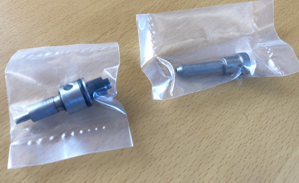

I have a question: I sent my 50 fpe version (.25 cal, LW barrel) in to Martin to have it converted to the 60 fpe version (using the LW polygon barrel). At the same time, I requested he fit me up with a .30 cal barrel and probe for the same gun so I could swap setups easily. I asked for the spare parts back, and I think he supplied them. Now I have a little bit of doubt about which parts are needed for the probe portion of the swap.
In the picture below, I'm assuming all I need to install is the set of parts in the bag on the right side-is that correct? I'm assuming the parts in the left side are the old parts, taken off my gun?
Is that correct?

"jps2486"You may have to re-calibrate the reg too.
According to Martin, once it's setup for the .25 cal 60 fpe config, swapping to .30 cal should be just the barrel and probe exchange. He mentioned I may need to tweak the hammer spring setting slightly, but that should be just tuning. The regulator should be good left alone between those two particular setups-that was one of the reasons I went that route. Other caliber exchanges likely need the reg adjusted like you're suggesting.
