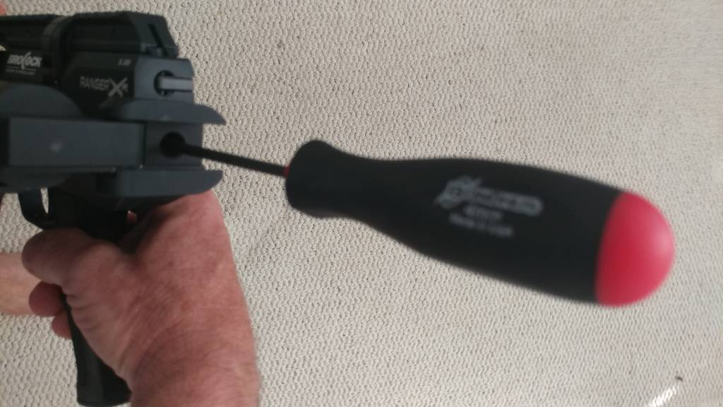

Hi, I'm looking at buying a Ranger XR but I can't find a single example anywhere on the internet showing how the Ranger's hammer spring is adjusted. I don't know if it's like the Atomic's in carbine form where you have to mess with the nylon looking screws or if it's different. If someone who has one could tell me how it is adjusted, preferably with pictures if different than the Atomic's, I would appreciate it.

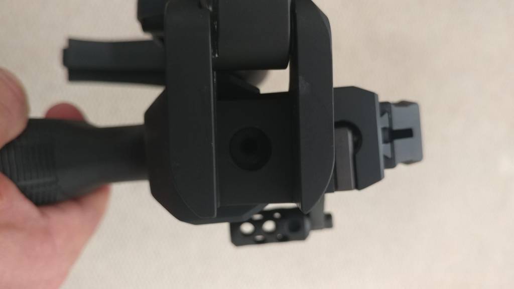

Easily adjusted by folding the stock and inserting a 4mm allen key:
