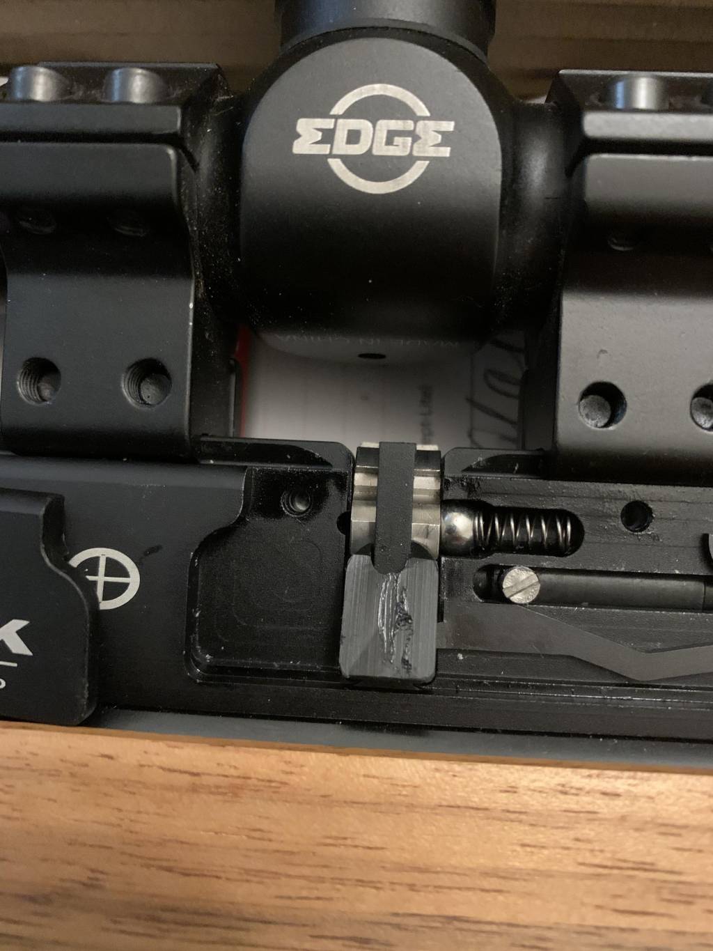

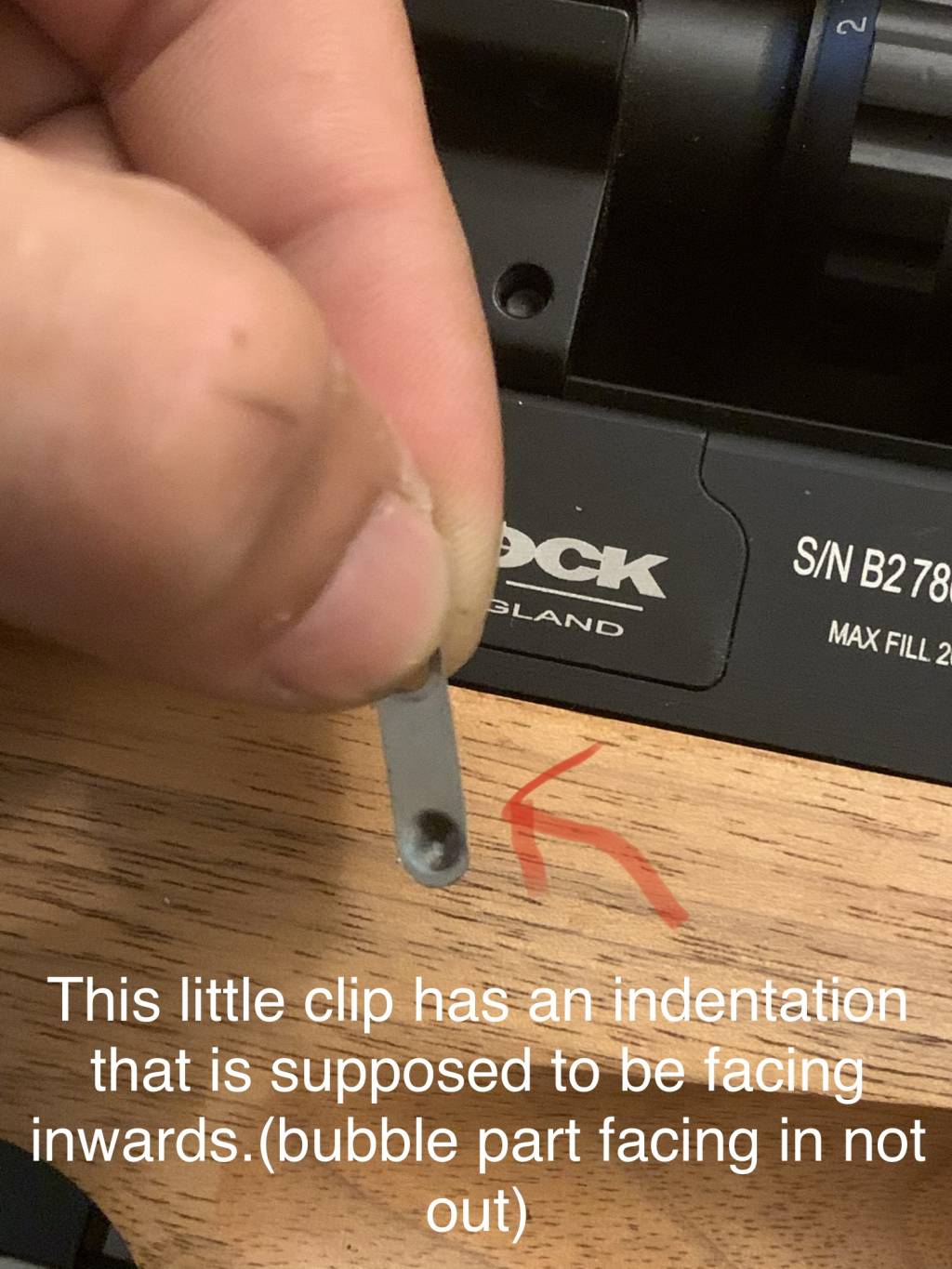

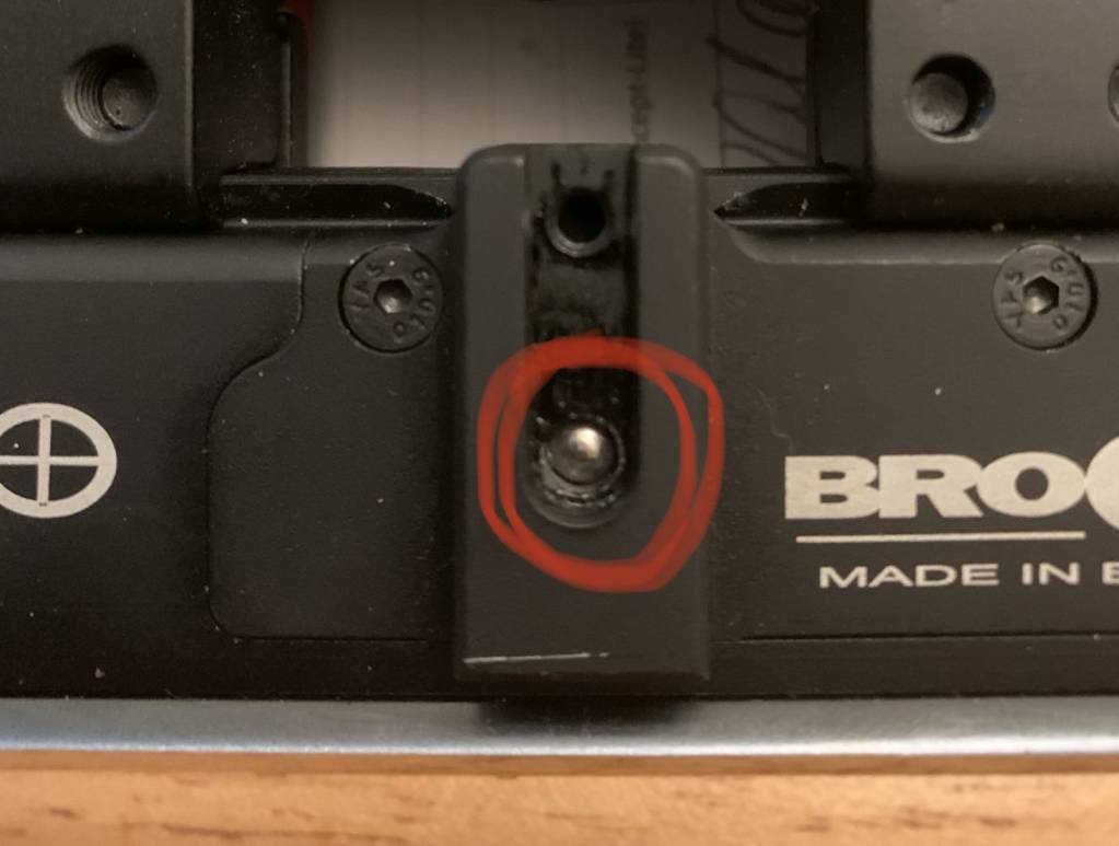

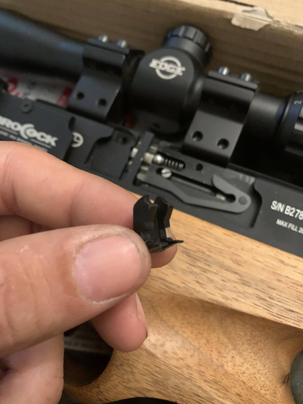

@peskadot671 I’m wondering if the indexing problem you’re having is (1) a worn indexing claw, (2) indexing claw not aligned with lever properly, (3) metal clip on left side plate installed the wrong way, (4) missing ball bearing underneath metal clip (left side plate).
I don’t own the elite contour s6, but I own the pistol version which has the same action(Grand Prix Elite).
(1) indexing claw - check to see if worn
(2) indexing claw properly aligned with lever
(3)👆
(4) ball bearing

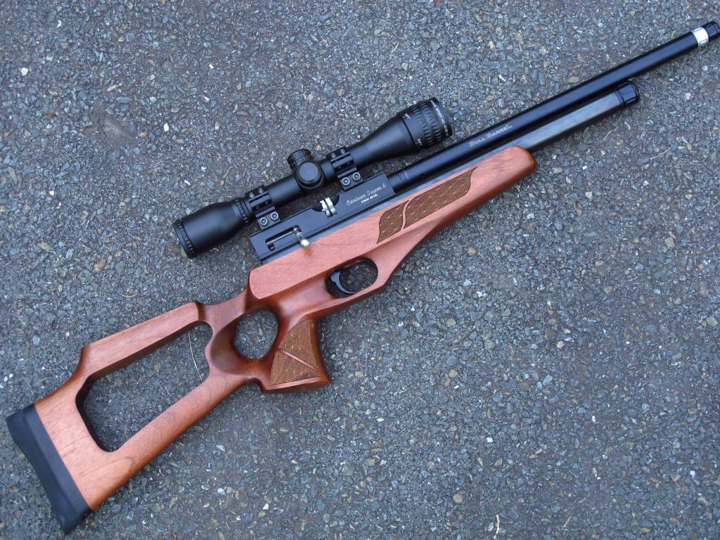

I thought they were great guns. Post Falcon Airguns, Brocock made a few different variations of the Contour. The single shot AimX, Contour, Contour S6 with a shroud, the Elite gauged model, a green stocked model and I believe the Specialist was based off either the Contour or maybe the Concept. As they progressed from the AimX to the Elite gauged model they got bigger and longer but remained svelte. The only issue I recall was the mag index issue. I had the model pictured below in .22, great air rifle. Wish I never sold it I had it dialed to shoot 15.89 grainers at 13.5 ish fpe and got 30 shots on a 190 bar fill, quiet (with an LDC) and fun out to 25 yards. I know there are a lot of adjustable PCPs out today but I think a quality, compact, light weight, mid powered PCP is what’s missing today and that Brocock and BSA Ultra fit the bill. Every once and a while I look on the classifieds.
