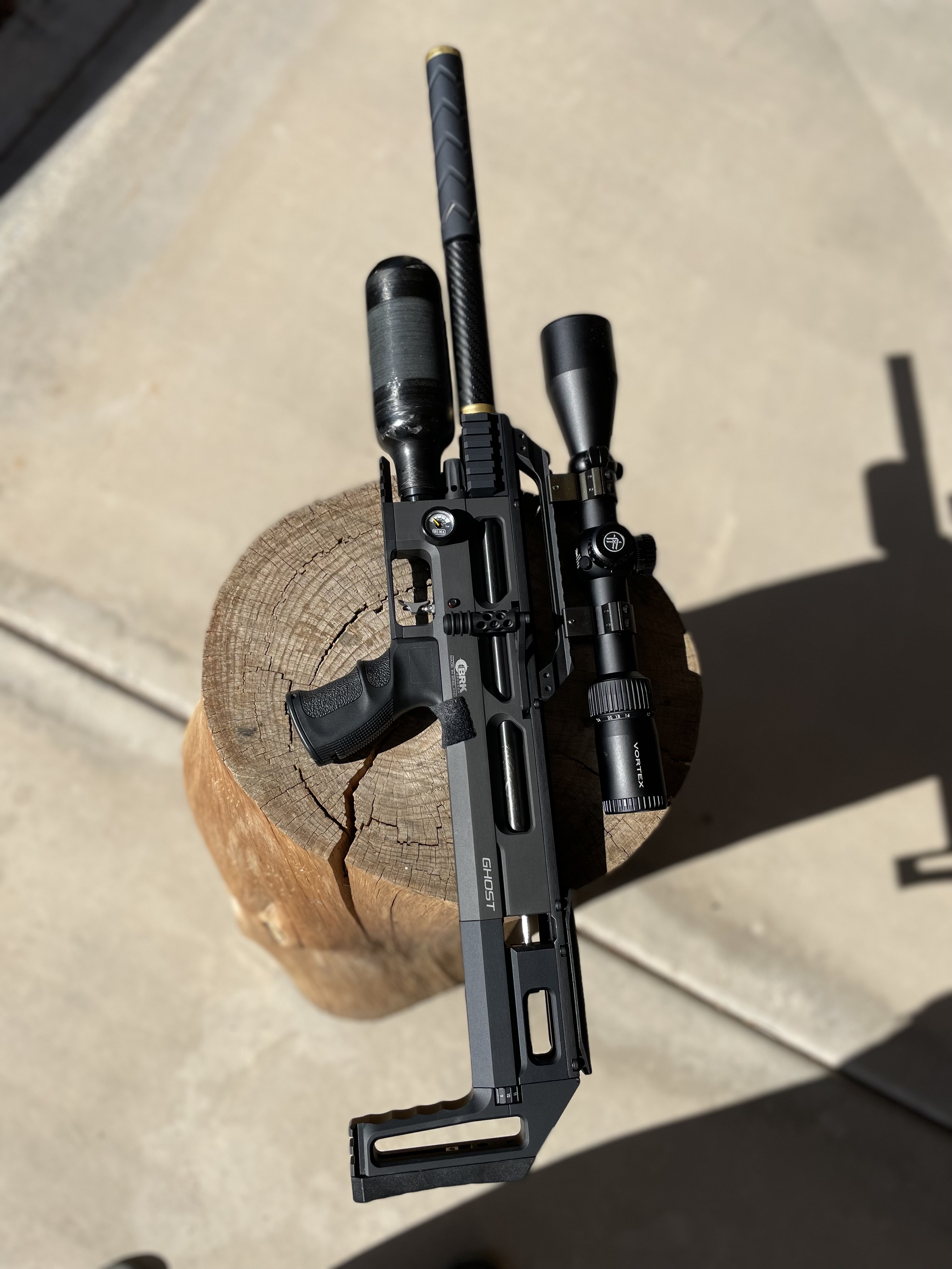

BRK Ghost Carbine .22 "backyard practice" tune
With an extremely low regulator pressure of 45ish BAR and a weaker-than-stock hammer spring, my Ghost is shooting the Crosman Hollowpoints at an average velocity of 670 FPS, or 14.3 FPE (14.3 grains @ 14.3 FPE), which is accurate and more than sufficient power for me for backyard practice shooting.
That’s slower than the 725 fps my Atomic send the CPHPs, nice! How many shots do you get out of that sweet Ghost?
Nice. Looks like the carbine model w/ custom shroud? What moderator is that?
Yes, it's the carbine model in .22. The shroud is OEM. I just covered the vent holes with gold pinstriping, which I also did for the vent holes on the moderator because I don't like the lead dust being laterally blown. The venting doesn't make a difference in accuracy in my experience and to my ears makes the report a bit louder than when covered. The moderator is the 0DB Tactical model.

Thanks! I agree with all you've said above. Yes, I indeed removed one Belleville washer and replaced it with a flat washer in addition to changing out the OEM spring in order to minimize as much as possible regulator creep given the ultra-low plenum pressure. I'm happy with its configuration as it requires very light cocking effort and is really quiet. Oh and my compressor gets to take a break, LOL! And yes to your remark about the whole reason for being into airguns in that it's not about having them produce mondo power just to enjoy them. Cheers!

I can get more than 230 shots. I say "more than" because with the bottle pressure gauge currently showing 80 BAR, it's got a lot more to give (I stopped counting at 230).

The spring just happened to be one of various other springs that are in a tackle box I use to organize different O-ring sizes, parts, and accessories for my PCPs. I don't remember where I got it from.
I believe you can do it to the .22 HP provided you get all components mated in that the hammer spring tension works well with the regulator setting. I should note that to maintain consistency between shots in my Ghost I've had to eliminate one Belleville washer from the regulator and replace it with a flat one. Additionally, at such a low power level in my setup, it was necessary to decrease the size of the transfer port hole by turning the barrel--similar to the way the Air Arms s410/510 does so with its built-in adjustment knob--until the transfer port hole was of the appropriate size to retain shot-to-shot consistency.
