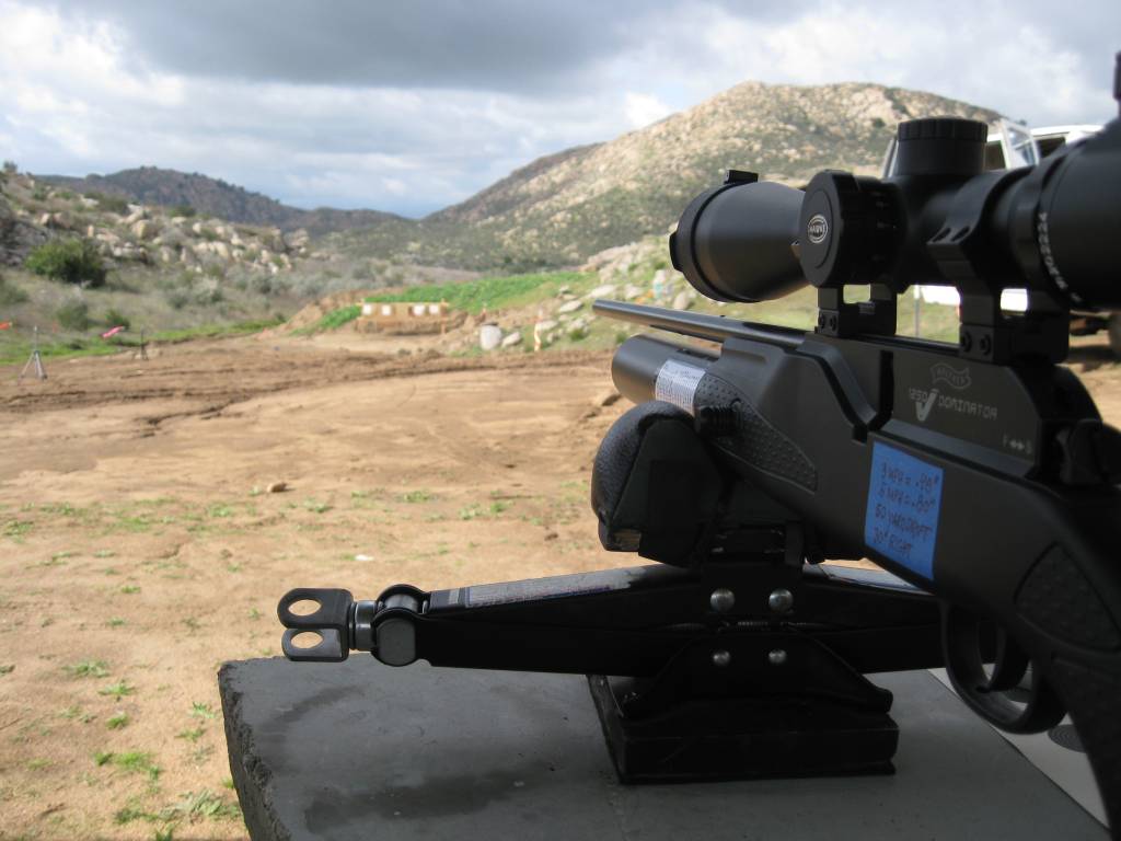

Darn, I have come to hate drilling holes in all those nice rifle stocks ... Used to do it all the time but no more!
1f426.svg
Actually the Cayden comes with a recessed brass screw for attaching the included Picatinny rail

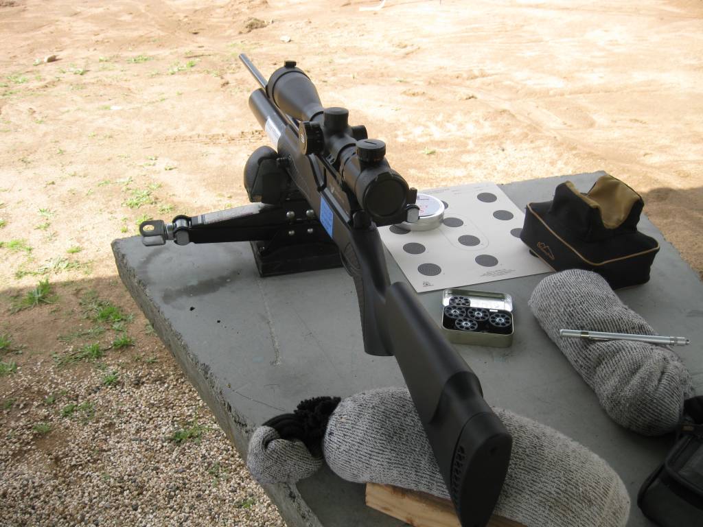

Hey, don't let those blanket opinions get out; lest my competition figure out someone cheated to post club records Overall, and in both classes (35 Foot Pounds and 80 Foot Pounds) at Ranchito Robinson Bench-Rest Silhouette using just a front bag (rear rests are not allowed). BTW, that shooter used Korean rifles costing about the same as most of his competitions' bipods! 😲
"To add insult to injury", that damned Neanderthal's bag cost less than a tin of his competitions' pellets (not counting the duct tape holding it together). 😳 Sad... but true!
So either that cave-man is actually a space alien, or bipods ain't always superior. Just my opinion, mind you.

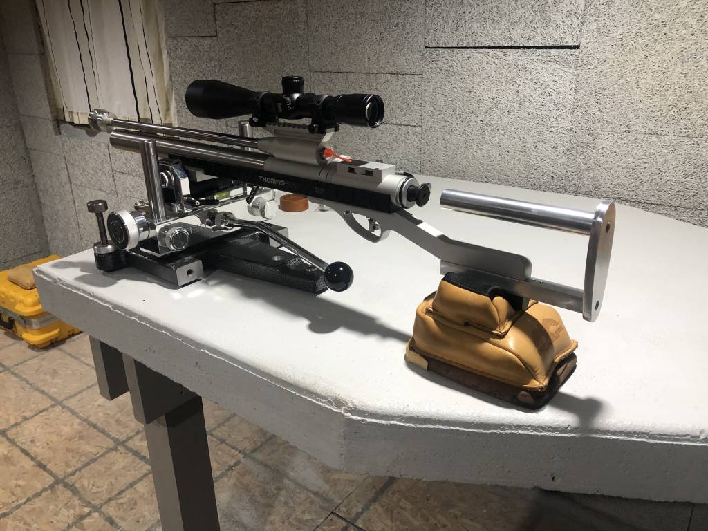

Good front rest with a joy stick any day of the week.{ SEB, Farley }. Also Shadetree Engineering makes a joy stick top that fits most standard front rests. Remember, you get what you pay for!
yes especially for some 25 meter targets where you run out of adjustment.....although i found 20 minutes was plenty of time. I miss my old socks full of aqaurium gravel.
