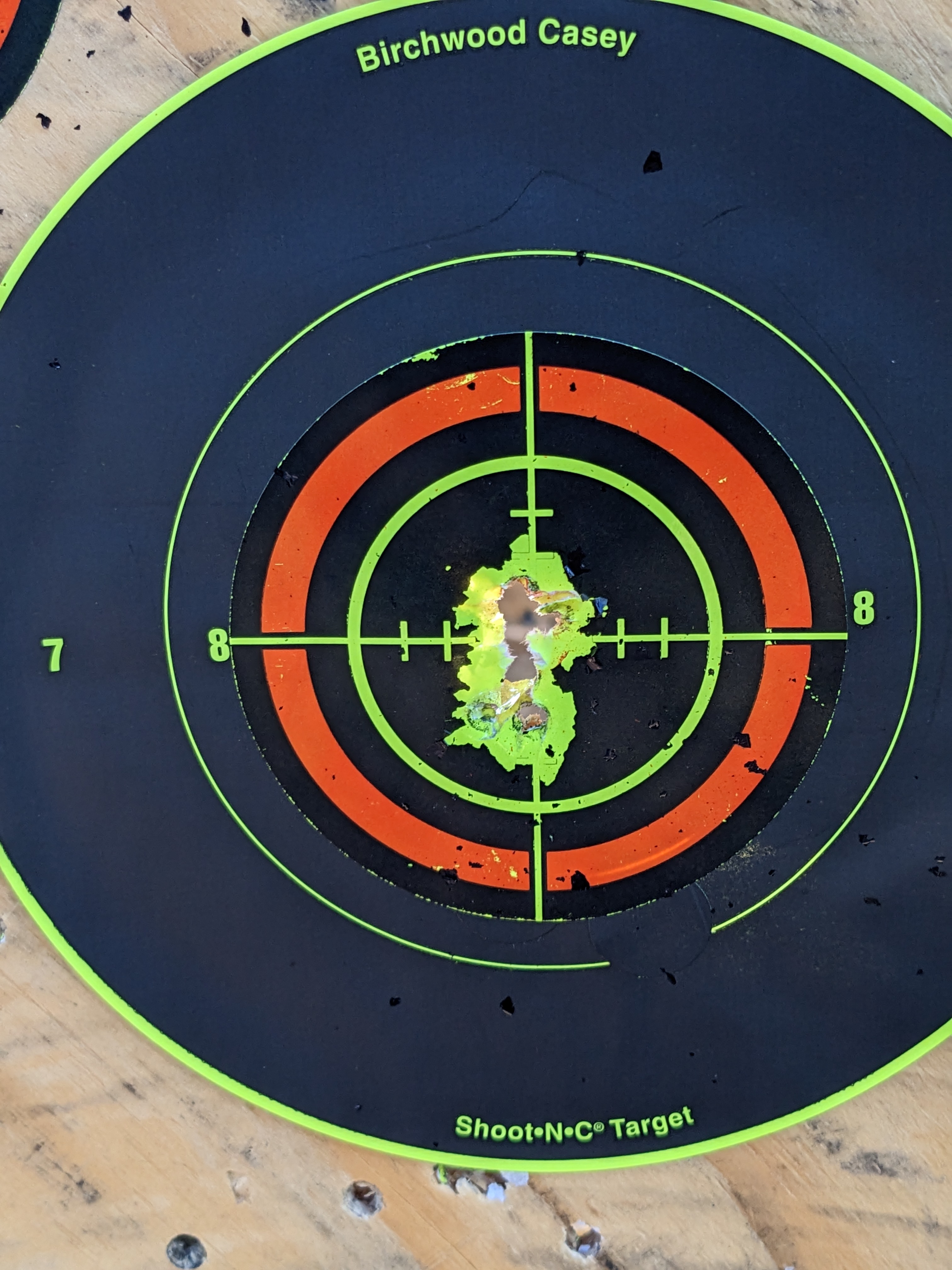

My wife and I both shoot 600mm M3’s with heavy slug liners. Hers is very fond of NSA 24.8’s in .217 out of the heavy liner. Mine would shoot 23 gr .217’s pretty well but l tried some .217 27.5 NSA’s just because I had them left over from a Maverick sniper. BINGO!!!! My M3 loves them. No rhyme, no reason it is just what the gun shoots the best.

What kind of velocities are you finding those NSAs to be most accurate at? I ordered 5 boxes (17.5, 20.2 & 23 grain) last night in hope of finding a fit for my lady's Wildcat.
The 24.8 slugs in my wife’s gun re shooting in the mid 960’s, I was shooting the 23’s from my gun @ 980.
Sounds promising. I hope her Wildcat can push those lighter weight slugs at similar speeds accurately. I indexed the barrel yesterday and that seemed to help accuracy, if I can trust what I got out of those cheap Crosman Premier pellets at @ 55 yards. 🤣
