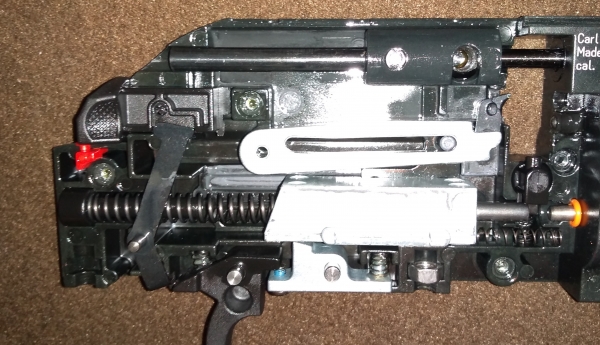

Well, i looked again into the action but there is not enough space to add a sleeve on the striker pin. that was my first idea to reduce the noise when hitting the valve!
the weight of this hammer is 60g / 2 ounces
regulator is set to around 1000psi and i got a lot of hammerbounce
i want to keep the power sub12ftp and a much lighter hammer would be great for this kind of setup.
the regulator got no adjustment and i dont know how to set the reg up higher because i think that would help with the hammer bounce. i cant find any documentary about the belville washers stacks. it seems to be a secret!!
would you all make a lighter hammer from delrin ?
btw its a walther rotek / rotex in .177
So the sound issue is from the strike of the hammer on the valve stem? I would say I am definitely not an expert here, however inserting just a little material in between the hammer and valve faces, and potentially increasing spring force, might both reduce your hammer bounce and your sound level. I think there are a few suggestions above to this effect. :)
