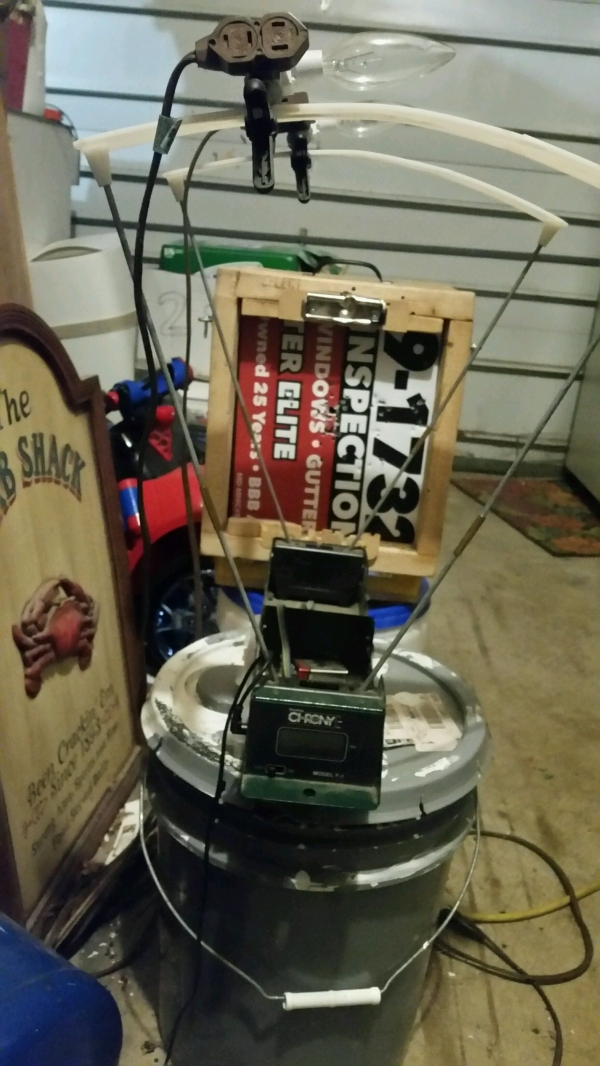

I set mine approx 1' from the muzzle and have had ZERO issues.
Thanks a lot for the information. May I ask your aiming point? Low, medium or high?
I aim approx 4-5" above the sensors. (you should be able to see the holes in target). I also have one of those "horrible" F1's. With the lights on the sensors as shown I bet I don't get more then 1 "ERR" reading every 100 shots, and usually this is when I shoot to the side of rear sensor.
