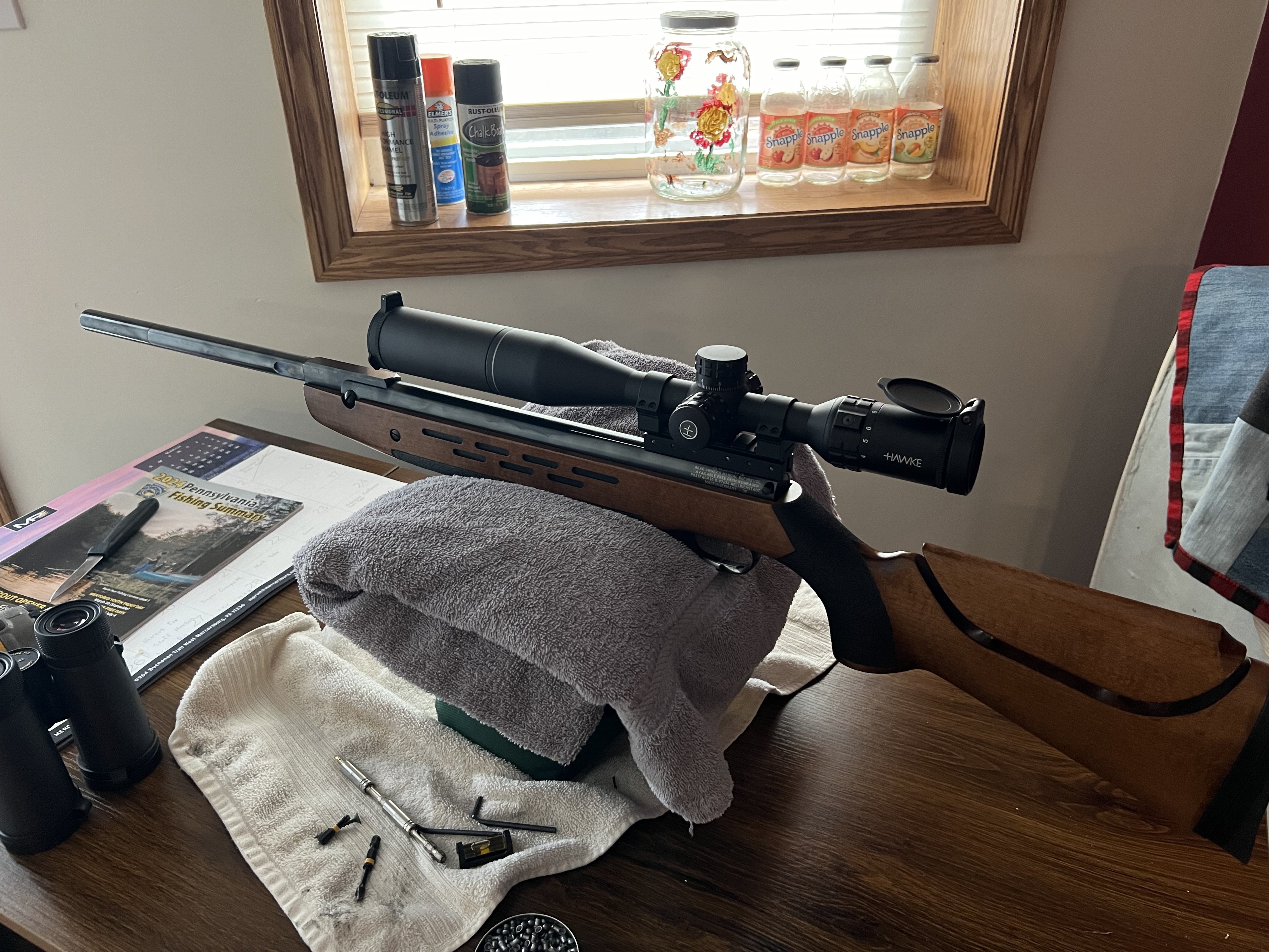

I’m really loving mine on my HW 98 right now. The locking turrets are great. I also like that the mil reticle is true at 10X(sfp). It only took three shots to get sighted in and the tracking seems perfect.
