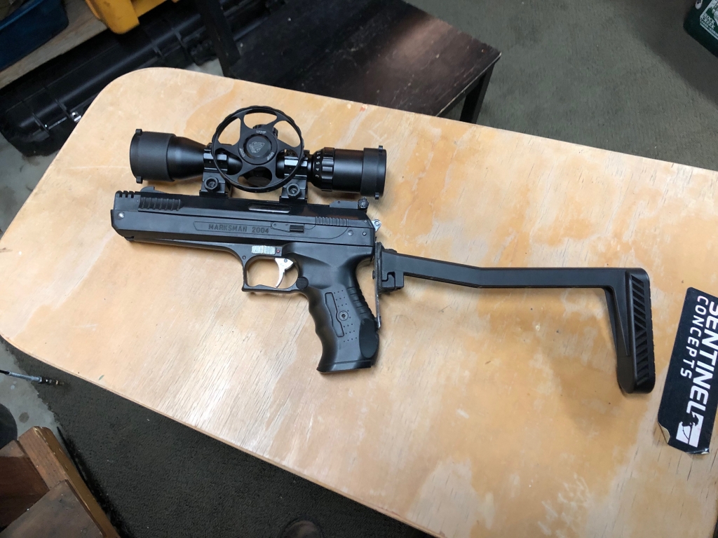

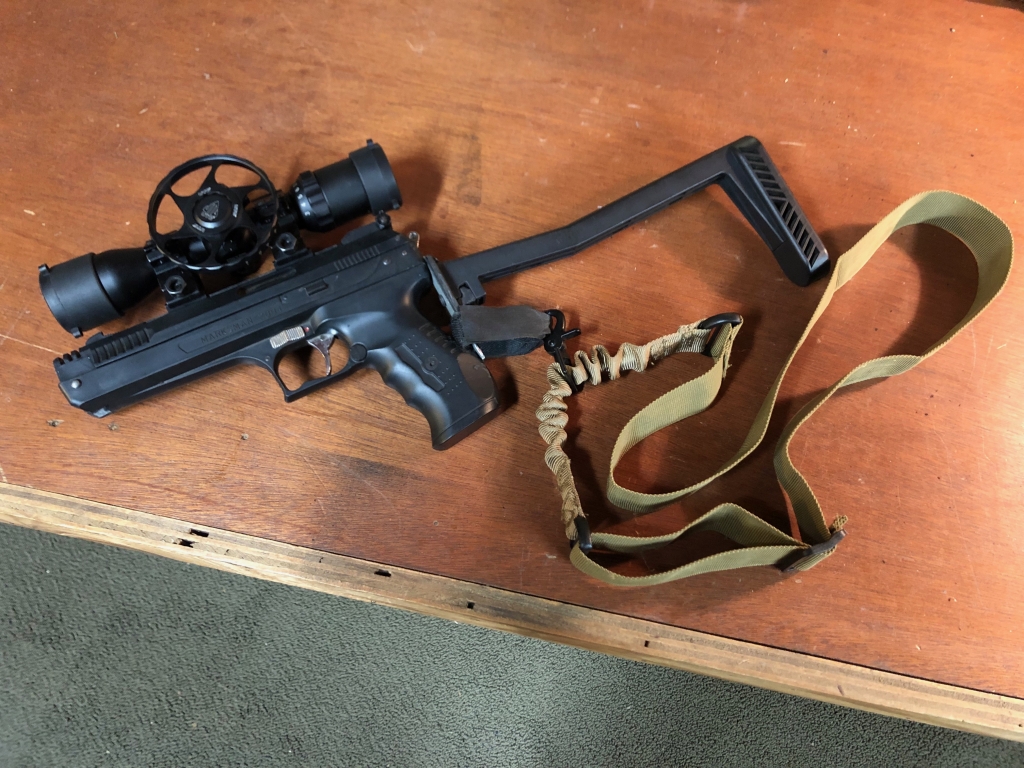

Too much coffee and a deconstructed Umarex stock...
Very poor workmanship on my part, but absolutely serviceable.
This turned out pretty cool. Takes the Marksman 2004 (Beeman P17) to a whole new level.
Offhand dimes at 20 yds with the Bugbuster. Will zero for 40 and take mortar shots with it.
The sidewheel "looks" like gimicky overkill but actually works awesome as left thumb is already right there when shouldered.

Time for some gopher-dissin'
No change in degree of difficulty closing the breech when cocking. Just make sure scope can take it!
So, the stock started out as a folding model but I inadvertently disabled that feature when moutning it to the metal plate that attaches to the stock. Dang-it!
tested it out at "longer" ranges yesterday (40yds). Iv'e settled on a 25 yd zero as that is where i think the limit lies for accuracy. Need to try out a few more pellets - it sure is fun to shoot!
