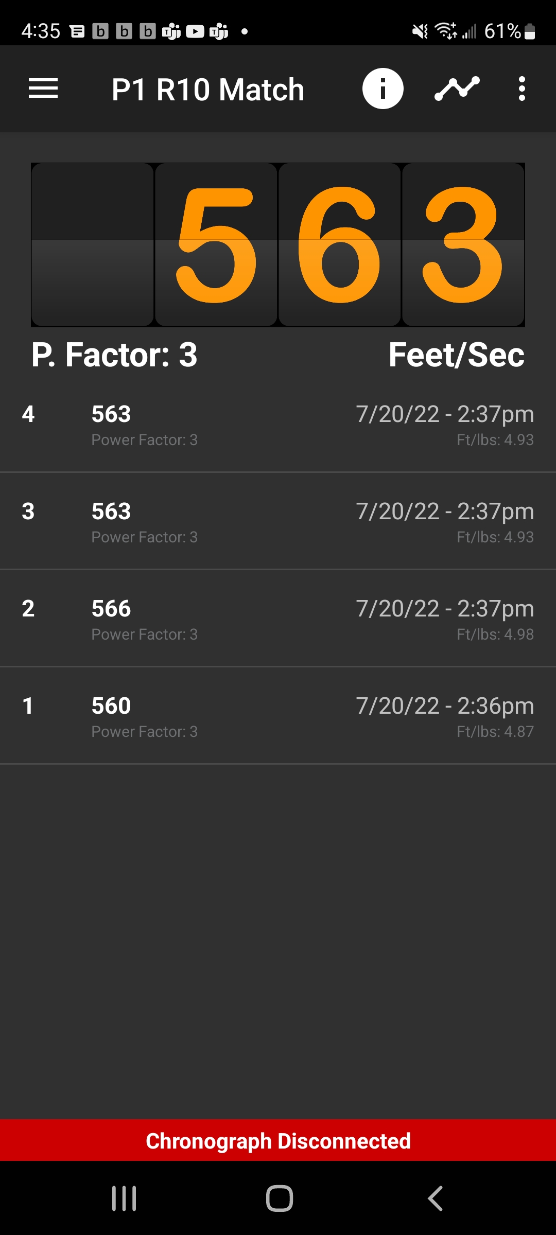

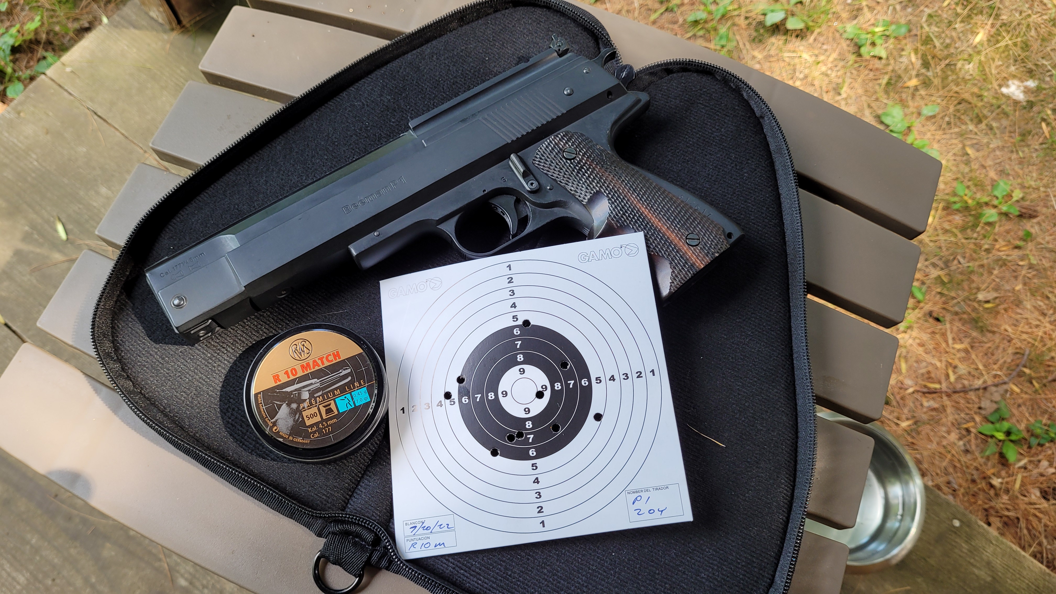

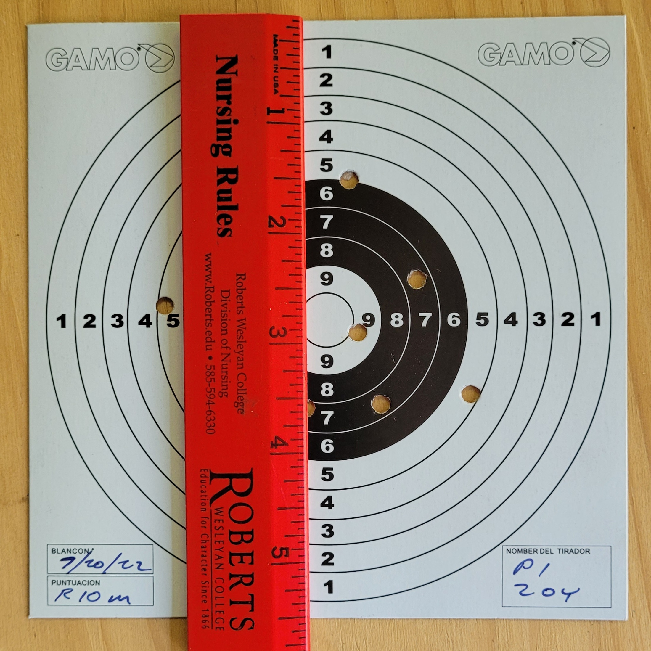

Anyway, I got it out last week and shot a bunch trying to remember its preferences and figure out holdovers at various distances. After playing with various pellets at different distances, I found 20 yards with R10 match pellets brought the widest smile 😃

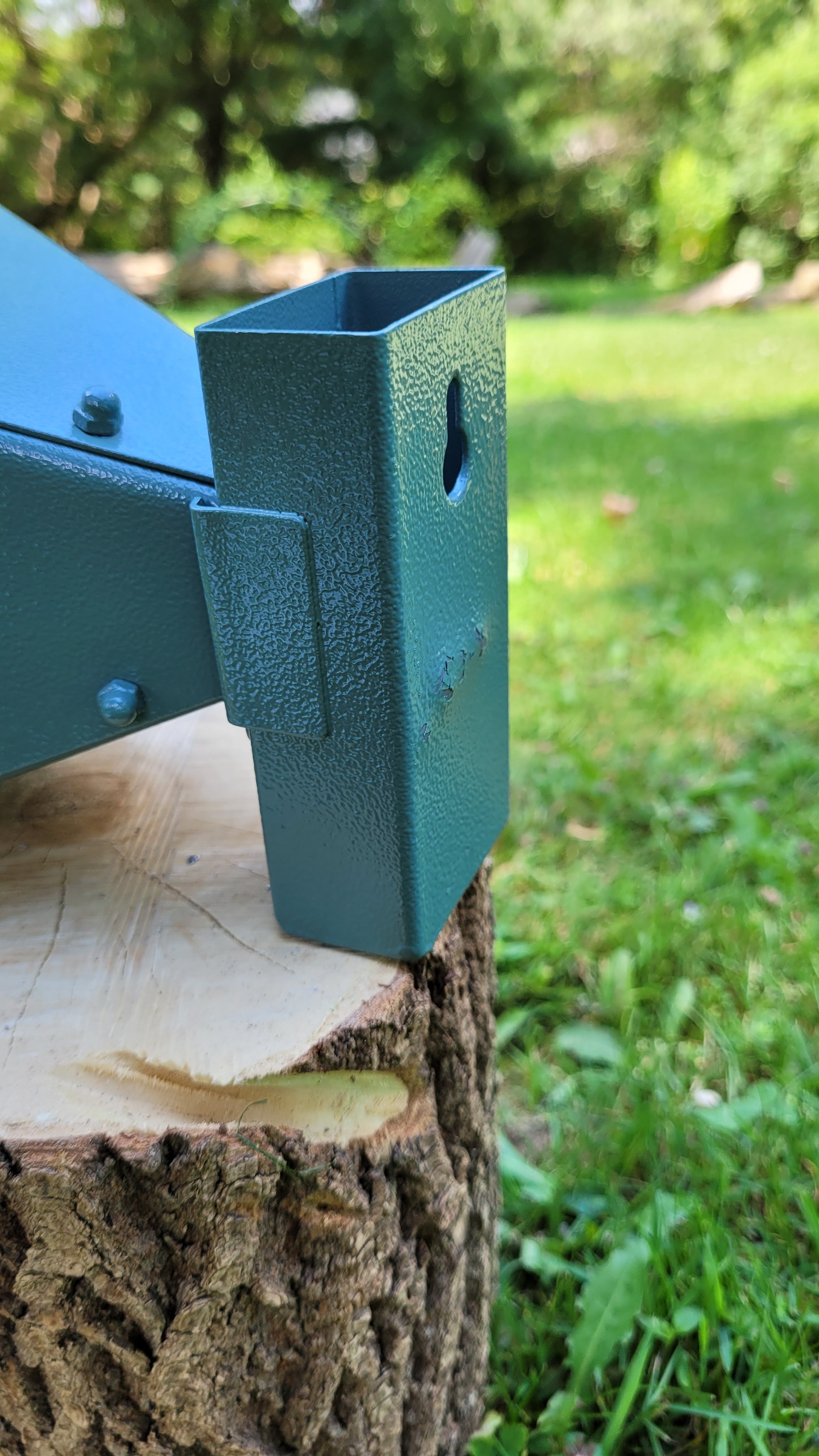

Oh, the Gamo trap took a little beating from the closer 10 yard shots...
Thanks guys. 😊 I should have also mentioned that it shoots Air Arms 8.4 well too. But I'm saving those for other rifles 😉

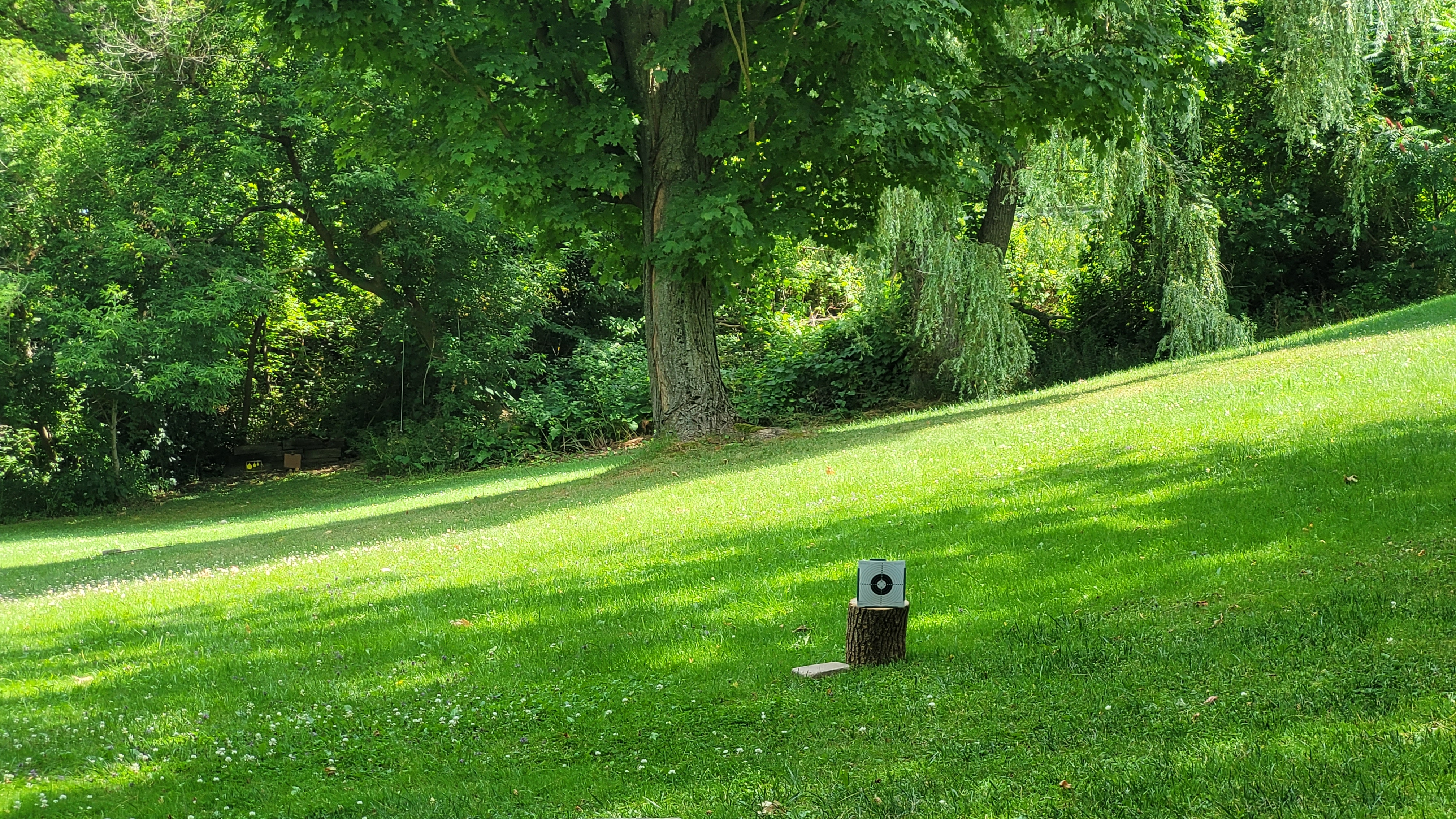

Also, if you look at the pic of my yard, you can see a yellow spinner At that distance it was *possible * to hit that with the P1 by lobbing pellets down there about 1 out of 5 times. It's about 60 yards. Very satisfying when pinging them!

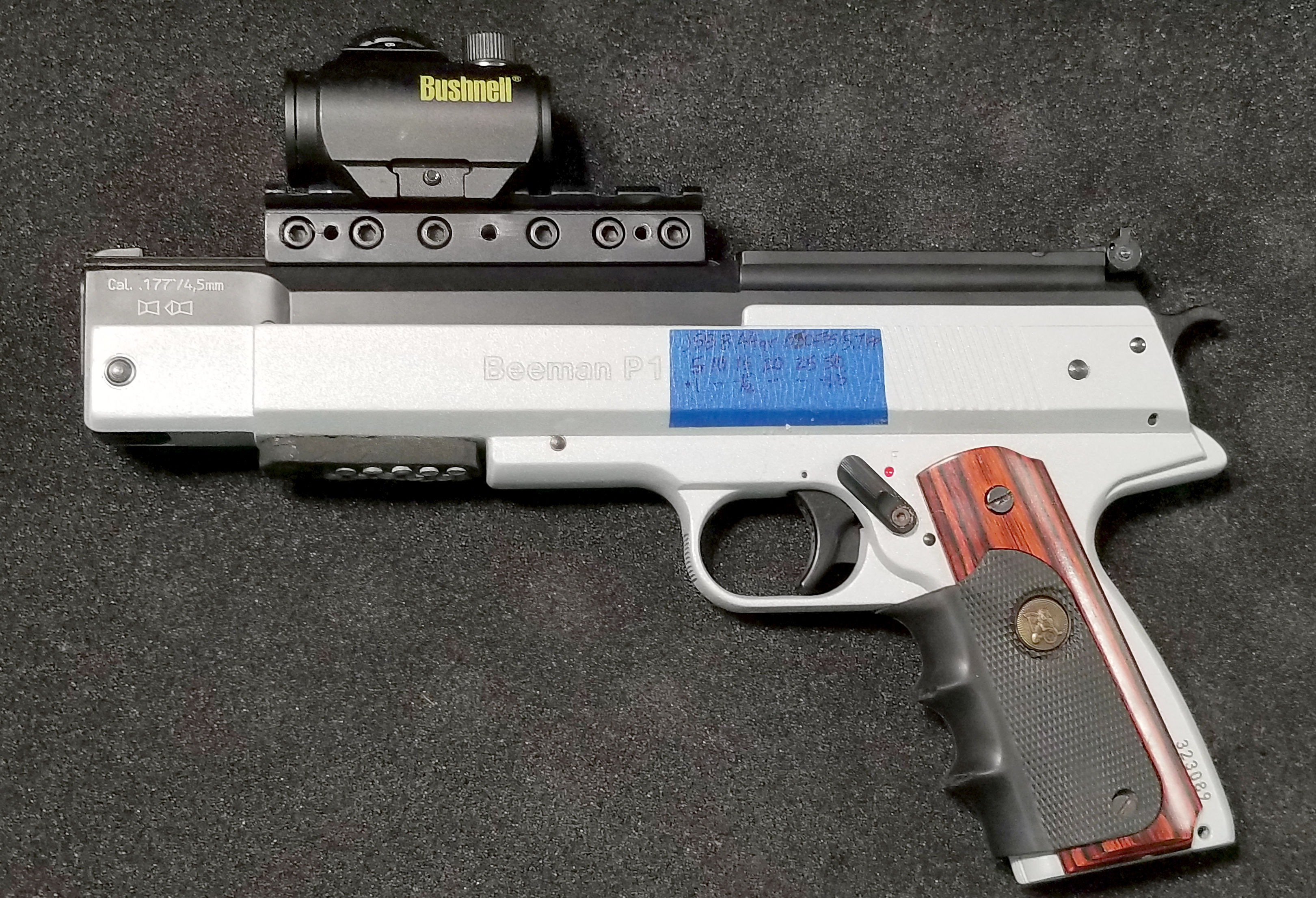

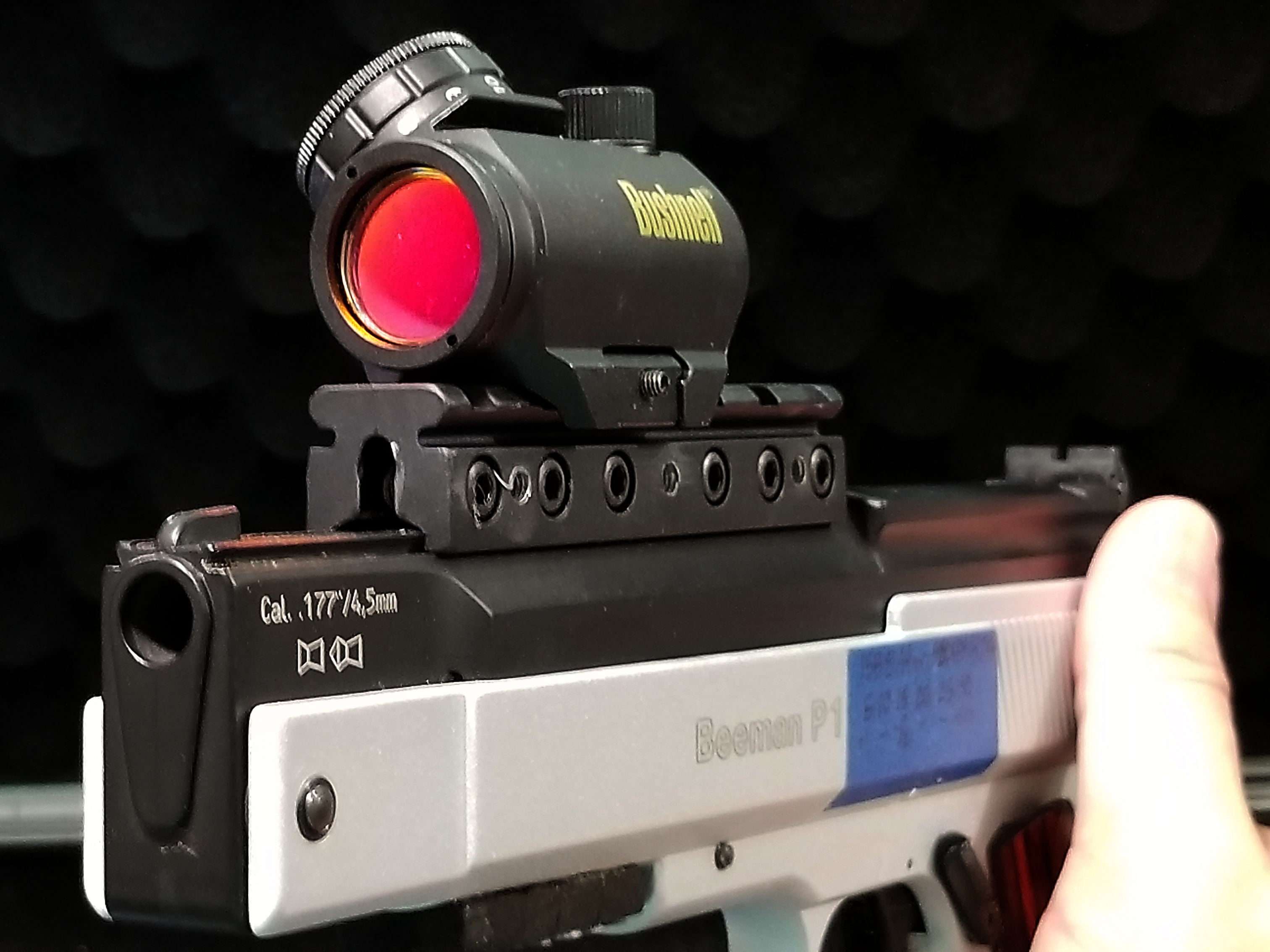

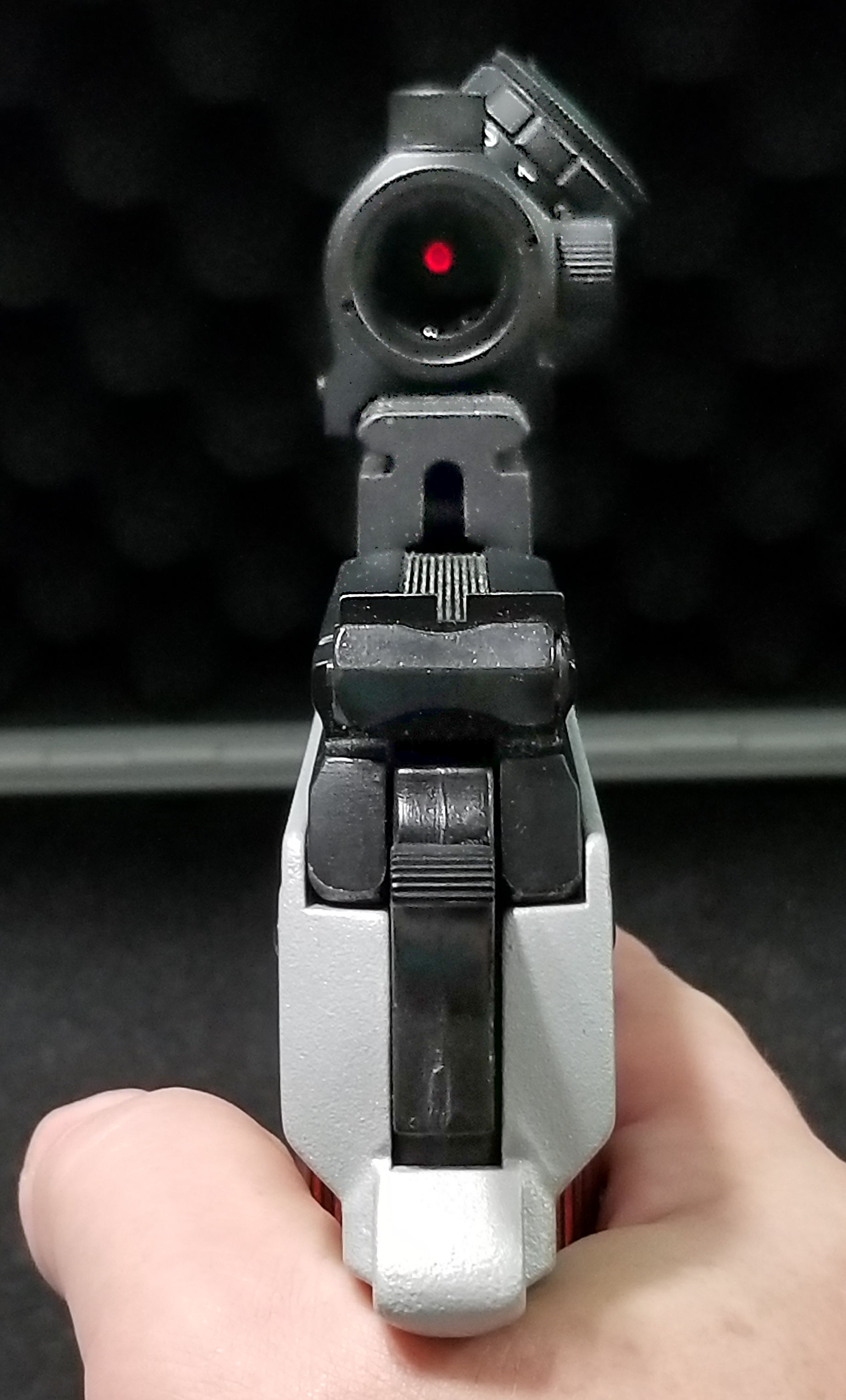

I mounted a low profile Bushnell red dot (Picatinny mounts) using a heavy BKL dovetail to Picatinny riser. The added mass helps to smooth out the shot cycle.
The red dot size is 3moa iirc, and is a good pinpoint aimpoint if you keep the brightness adjustment to the minimum. It looks big and fuzzy in the photo because the camera couldn't focus it properly. The dot sight picture is a little hard to aqcuire at first, but gets better with practice. With both eyes open, the dot superimposes over the target nicely in your binocular vision
The P1 has a dovetail that's a little wider than the standard 11mm. I had to spread the dovetail mount apart by first putting the screws in the alternate holes, until the mount would slide onto the dovetail. I definitely recommend antiseize paste on these; steel screws threads into aluminum threads.
The Pachmeyer molded grips are comfortable and help make your hand position more consistent.
When I shoot from a rest, I place my wrists on a bag, not the frame of the pistol.
