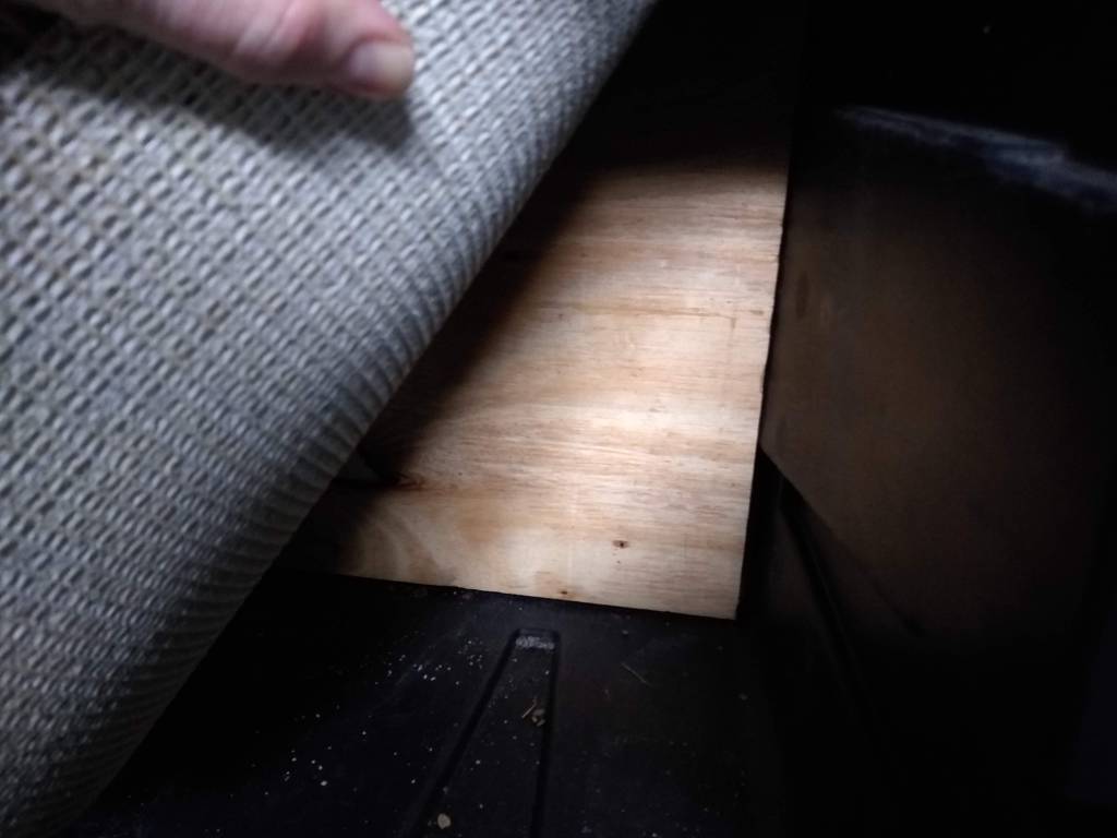

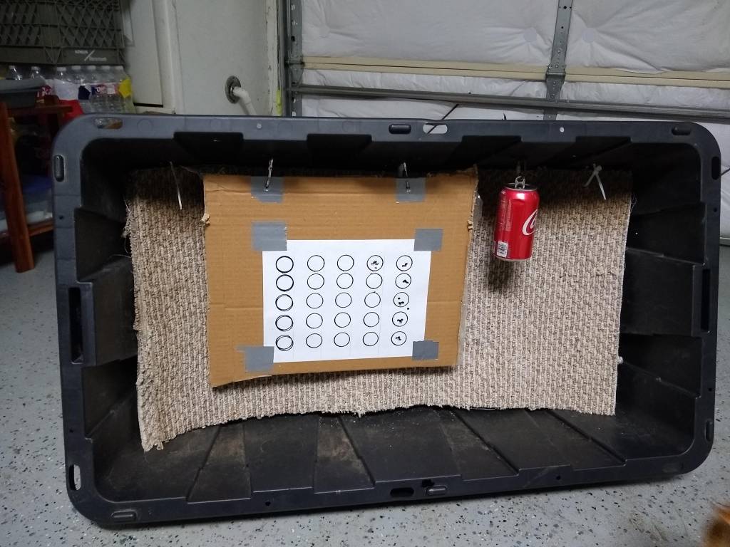

I went to Home Depot and got one of their storage bins -- they are black with yellow tops, come in all kinds of sizes.
Then I turned it on its side, drilled some holes, put zip ties through the holes and hung scrap carpet. Anything over 350 fps will go through the first layer of carpet. This is kind of the "curtain" that allows a pellet or BB through, but won't let it bounce back out. The backstop is 7 layers of carpet stacked tight, with two layers of 3/4 inch plywood glued together behind it. I can shoot .177 cal up to 1000 fps in tight groups of 10 and it never gets through the carpet, let alone the two layers of wood too.
It's also portable -- just snap the lid in place and throw it in the car. All self contained and not too hard to clean out either. I'd post a pic, but I don't have a pic hosting account anywhere.
Actually, I CAN post a pic...
This is my current portable pellet trap. That's a standard 8.5x11 sheet of copy paper that I traced the outline of a quarter onto for "targets". I just needed something simple to sight in a new scope on my crappy Winchester 1977. Anyway, hopefully this gives you some ideas. The storage container was less than 20 bucks. Everything else is stuff I already had laying around, except the carpet. I found that on the side of the road, LOL. Hey, I'm thrifty, what can I say?
And two layers of 3/4 inch plywood glued together just to be safe. Nothing is permanently attached and is easy to switch out as it wears out. So far, no pellets have ever actually hit the wood.
Sirgilbert, thanks. I will have to give that idea a try. I think that the BB pistol is rated at 300fps or so, and the box you describe has enough depth that I can add several layers of carpet/material to trap the BBs. I am familiar with the boxes you describe...I have many of them for storage. Did you cut a hole in the target face area, or just shoot through it?

I just shoot through it...then replace either the target itself or the whole piece of cardboard. We get a box from Amazon like once a week, so there is never any shortage of cardboard, LOL.
Also, I used paracord and small carabiners to hang the targets. That's just what I had laying around...I should probably find something other than carabiners for the targets, now that I think about it.

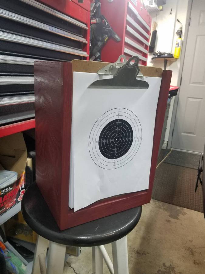

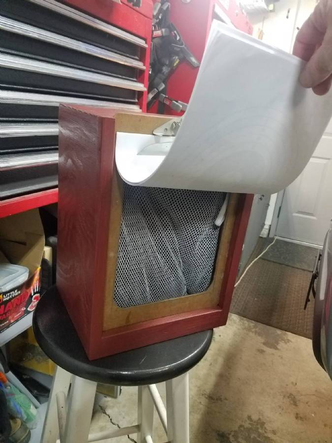

Here is my adaptation of a pellet trap, probably work for BB's but would test first.
Built a box in my shop, added carpet to back interior, filled a mesh bag with rags and scrap t-shirts/socks. Added some cup hooks and hung. I've put 1000+ pellets in this with no issues. Easy to clean. I put two side slots and added a cut out clip board for target holding.
Have you had to replace the mesh bag or the t-shirts? I've been wondering how old t-shirts would fare over the long haul. I end up using them as rags for my oil changes, but if they work for pellet traps too, and would make it easy to clean the pellets out of the trap, that would be awesome.
