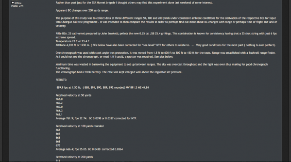

Please help. Does this reference open for you to show my original report and data that has led to the subsequent use of variable and average bc input for long range pellet shooting.
If it won't open, could you please search Google using this search topic, "Promised 200 yards pellet Ballistic Coefficient experiment data and results. LONG. " And please let me know if it gives you access to the report and data. Pictures won't show because of Photobucket's constraints, but I would like to put it back together for its historical value.
It was done in Feb., 2010 and widely read at that time (7332 times) and played a part in the development of Dave Eades' "GA base" within Chairgun.

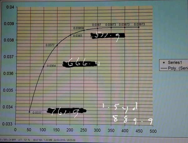

One of the associated graphs which you should be able to expand to allow the data to be read, but needs the above text to explain the details data and rationale: I tried to post it in the pellets and projectiles section where it was relevant in another thread but having no response concluded it could not be read despite my efforts.
Thank you for your help. ... Kind regards, Harry G Fuller. Edit - (If readable then any ensueing discussion is welcome).

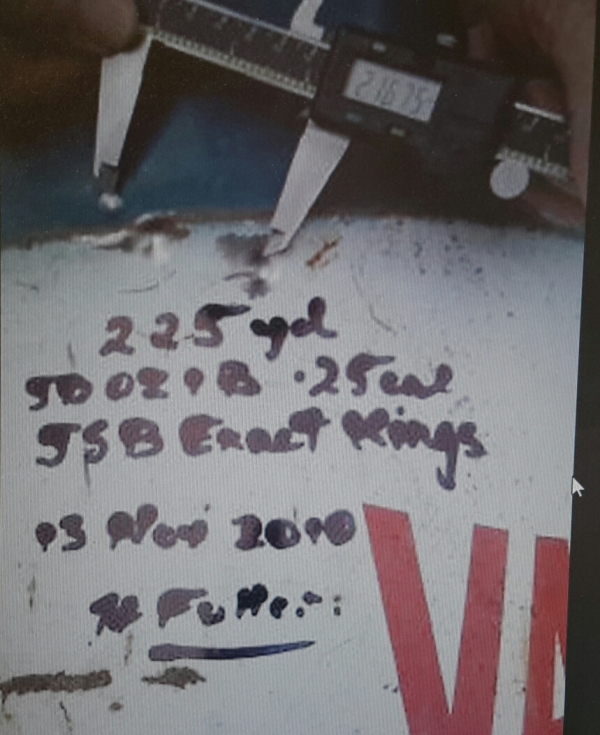

When setting up for the above study and checking trajectory tables these three shots on an oil drum were made at 225 yards which was the limit to the sight setup I was using.
If you expand the pic you see it is 2.16 inches and those are serious dents.

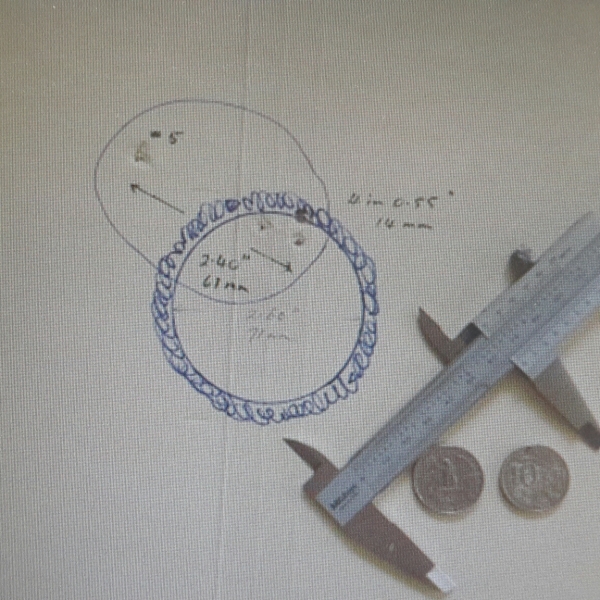

Here is one of seven groups that averaged under three inches at 202 yards - shot consecutively.
There are 4 shots in 0.55 inches in the top of the small JSB tin's circle used for a target.
So, given best conditions, if you have an accurate rifle and a shielded chronograph, give it a go.
