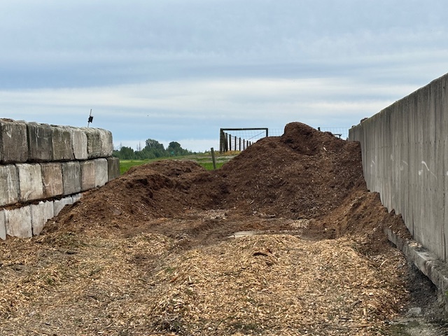

The farmer has called me 3 days ago about coyote activity at his new burial pit that he constructed at the back of the property. So I showed up to look at the new pit and setup my trail cam on the concrete barrier.
I returned this late afternoon and found out my trail cam had failed to record with zero footage on the memory card. Of course the dead cow was dug up and eaten over the past three nights. I had no clue why the unit has failed but after spending some time resetting it, I was able to get it to record again. Hopefully it will capture something tonight.

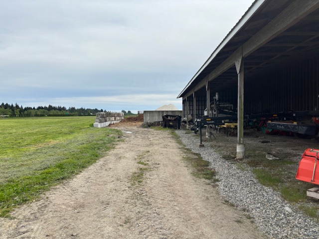

My shooting table was set at 60 yards to the target box which sits between two retaining walls with compose dirt towered over the target box. The retaining walls probably about 50-60 feet long. The distance from the front of retaining walls to my table was probably 45 yards to which a barn on the right and open field to the left. Lots of head wind coming towards me and I am sure there were turbulence wind created by all these structure.
