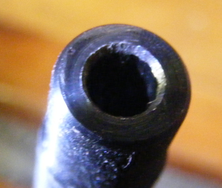

For the first timer, I don’t recommend recrowning a known good barrel. There’s a lot less hand-wringing if you can instead take a barrel with an obviously bad crown like this one:

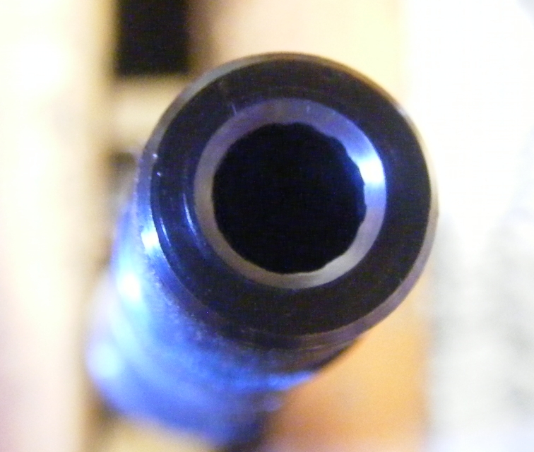

And turn it into something more like this one:
That will help build the confidence to take on barrels which fall into a gray area.
