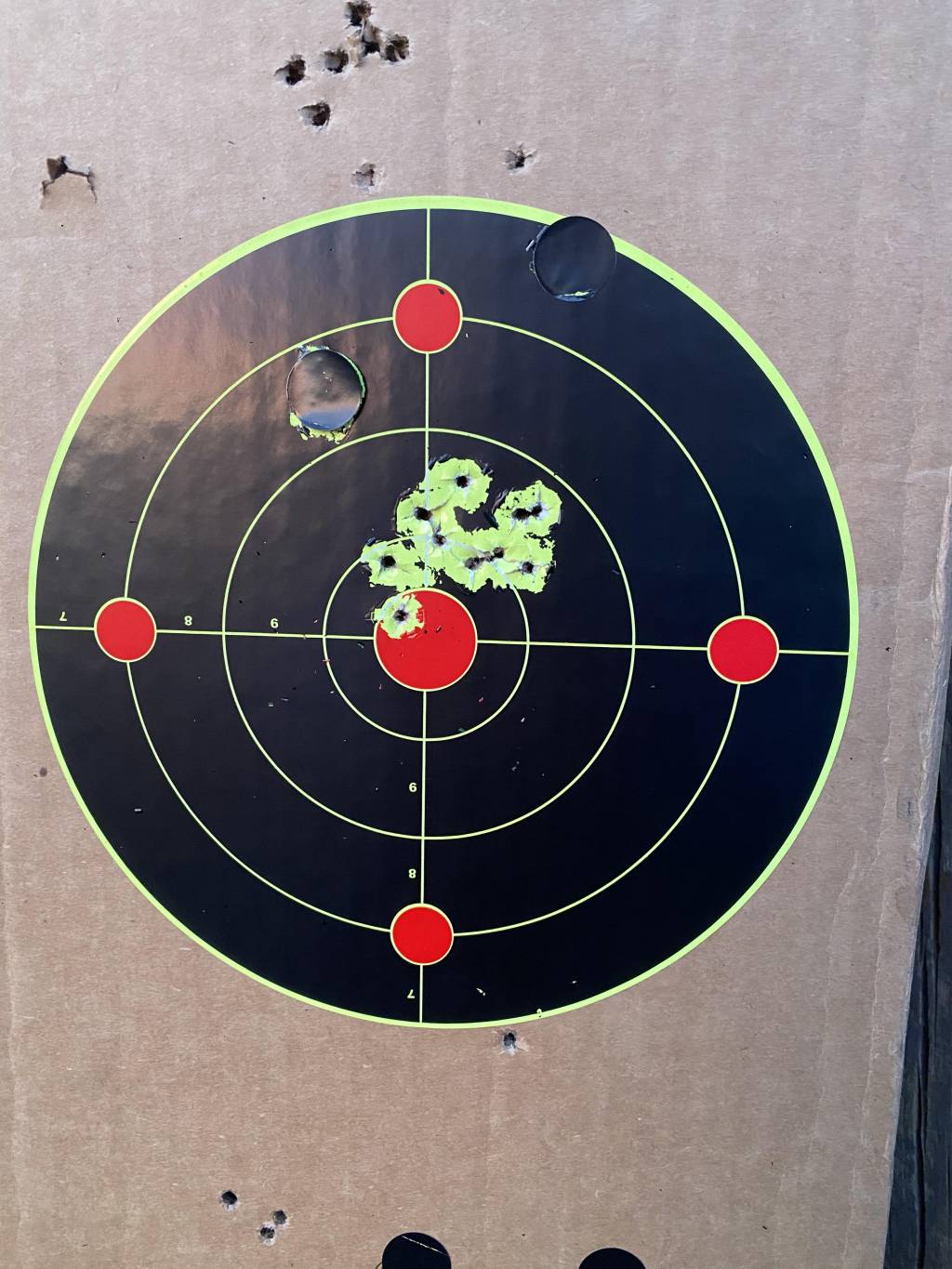

100 yard group using JSB 25g pellets @ 900 FPS

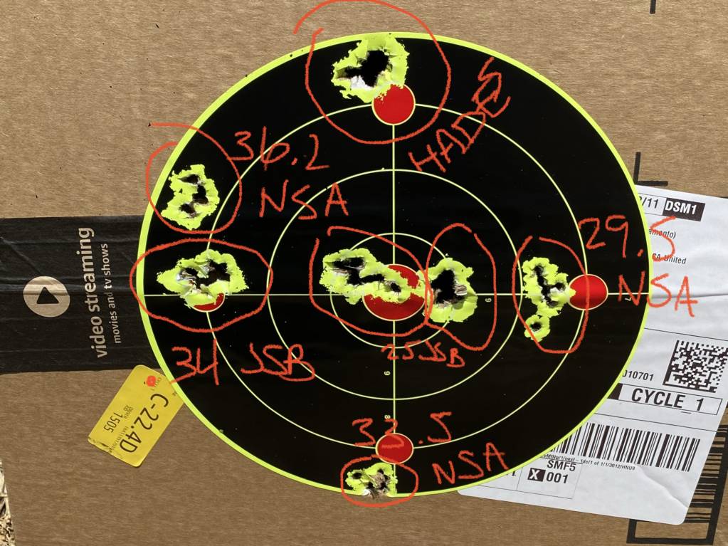

Different pellets at 50 yards all on the same tune. The POI for the 36.2NSA was right at the 3 in “36.2”
