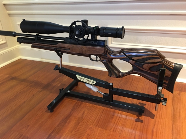

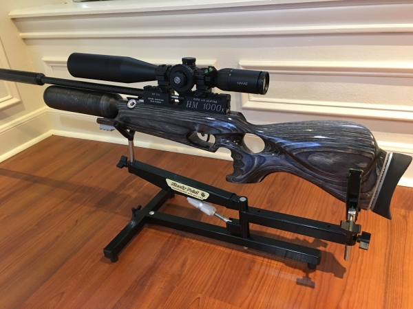

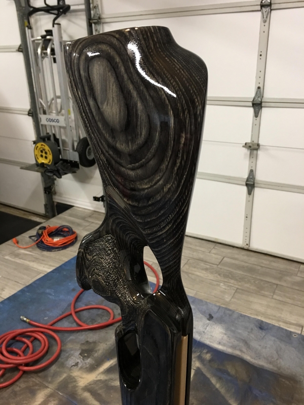

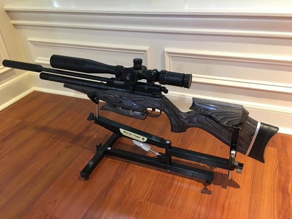

I went to a couple of body shops, they all hesitated to work on wood. Gave me all kinds of reasons for not to work on the stock. With the stocks already removed, I went ahead with Tru-Oil, not automotive clear coat as initial intention, just because it's much easier to fix if I messed up and I worked with it before. Spray 5 coats on each stock, mix 1:1 between tru-oil and mineral spirits - they came out close to what I had hope for with clear coat but with tru-oil, it's much easier to finish again and again down the road. The tru-oil really brought out grains, biggest impact was on the RAW since Martin's finish was too dull to reveal the beauty. They do look better in person than I can take the pictures but just to give an idea.
BSA Gold Star SE
HW100
RAW HM1000x

Great looking guns!
I love the stock on the BSA!

Tru-Oil is a very forgiving product to work with. I smoothed the finish with 0000 steel wool and sprayed 2 more coats on each; the grains just keep popping after each coat - couldn't be happier with the results. I love the lustrous wet looks of exotic laminate in glossy finish, personal preferences. The website scales down the resolution of the pics to show their true beauties.
