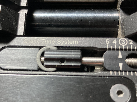

Attn: FX Impact Mk III owners
Everyone has their favorite tune, and the markings on the FX Impact Mk III makes it very easy to duplicate, for whatever reason. However, if you're like me, I tune it, and I leave it alone! Unfortunately, the Micro adjustment knob on the left is too easily bumped when handling the gun. I've done so, once too many times! So, I came up with a solution. Referring to the photo, you can plainly see the clip in place. The specific size is made to clip around a .25 inch shaft, so the distance between the ears is .21 inches. This is a snug fit for the grooves, which makes accidental turning impossible.
