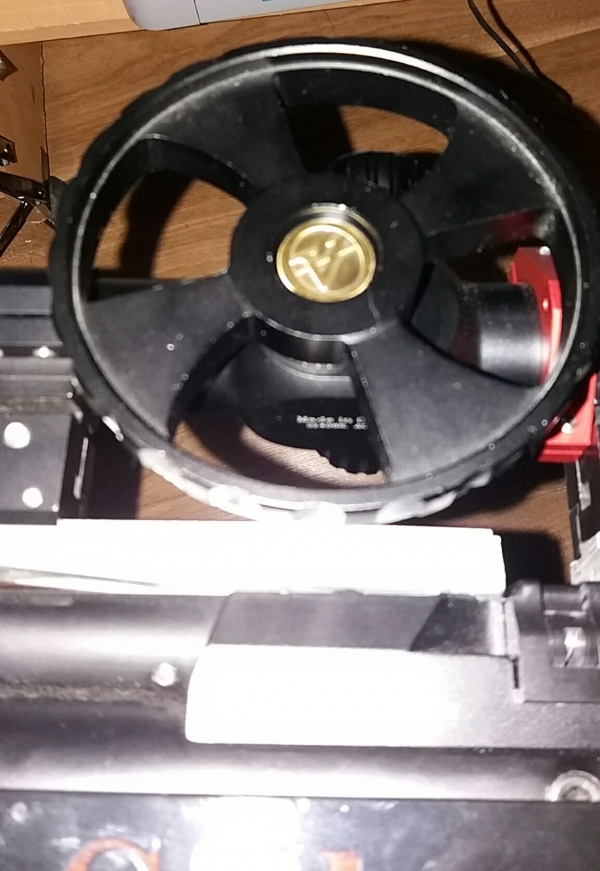

thank you very much, I had one of those wheels collecting dust, you just save me about 100 bucks"coonslayer"Thanks Chuck,
this is what I was looking for something else that closely fit. I can do some modifying.
Hi CHUCK,"CHUCK"Glad you like it Levin... I'd rather spend $13 then 100 or $150 any day
Thank you very much CHUCK"CHUCK"Yes Lev those are exactly the ones I use. I make the whole larger using an attachment for my Dremel tool that looks like a little round Barrel with sandpaper on the outside of it... I make the whole in the center larger and I also remove some of the rubber material until it fits just perfectly snug and then I tighten down the little grub screws and done. These look really nice and you can't beat the price
