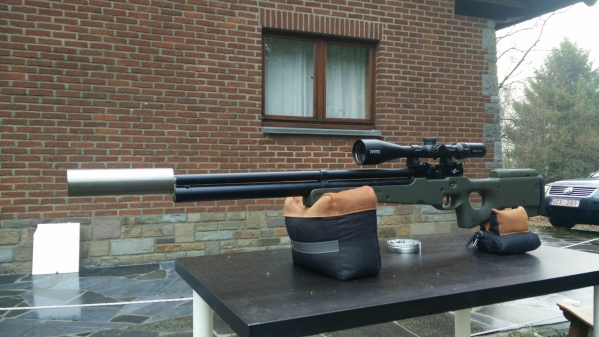

I've just received my ATAMAN .357 M2R type 2 tactical carbine olive green as well. I imported it from the States to get the sidelever! They are extremely expensive here and only available with a rear bolt. I received it 2 days ago and the weather here in Belgium is awful! So, I didn't have much time to play around with it. I have also been convinced by Steve's video!
I could find a few hours without rain and took the opportunity to shoot a tin of JSB's. Well, I really like the gun, it's consistency (the regulator works flawlessly), the smooth sidelever, the soft touch of the stock, the magazine and the big pellets! I think I'll have to get used to the trigger, which is pretty light and sometimes takes me by surprise ;-)
After my first shot, I was shocked by its noise! It's my first "big bore" (my biggest so far was an FX Boss in .30 cal which is very silent!). So, I added the Ataman silencer, which makes things a little better, but still not enough for my taste (or rather for my neighbours!). Any suggestion on how to make this gun more silent ?
Then, as far as accuracy is concerned, I still don't know if I need more practice to get used to the gun (it's my first .35cal!), or if one pellet really goes crazy from time to time.
Here is the example: I was aiming a golf ball at 100 yards (hit it 10 times out of 10 with a crown in .25) and then with the Ataman, out of 10 shots, I hit the ball 3 times, landed within 0.5cm 4 times and got 3 shots 2 inches away. These 3 shots concern me a little bit. It might come from me (though I didn't notice anything wrong in the process: it might be that I hold the gun too firmly, or not enough...), or, from the sound suppressor, or the gun itself that might need some more pellets to settle.
I need to do some tests without the silencer... and practise a lot more...
But all in all I'm really happy with my purchase!

In the meantime I decided to sacrifice my original "Ataman silencer" for the sake of research :) I drilled holes in it, surrounded it with different materials and a piece of exhaust pipe. The first prototype was already better than the original as far as noise level is cocnerned but I still needed to consolidate the whole thing to be able to use it effectively. I'm busy with that right now. When I'm done with my research, I'll try to get a final version done in aluminium and hopefully, i'll be able to do longer shooting sessions at home without fear of bothering the neighbours.
