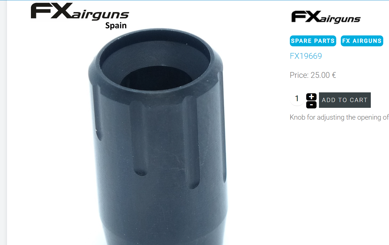

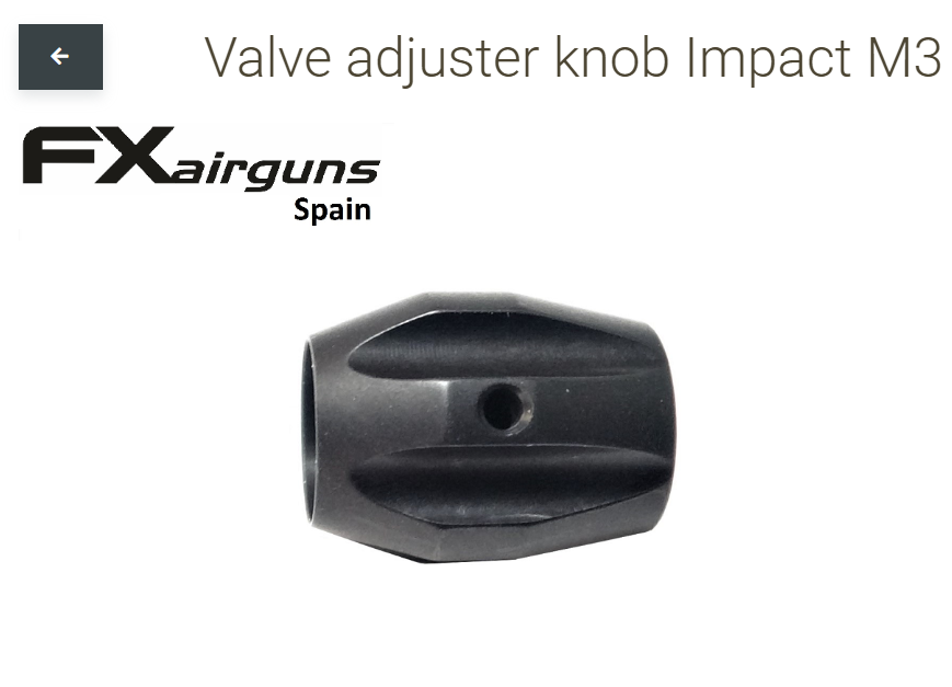

Are the M3 and MKII Valve knob interchangeable??
If I have an M3 but like the look of the MKII valve knob, would it make any difference?

FX includes a new adapter and spring in their conversion kit. Maybe you can swap knobs but you might as well upgrade to the Power Block/Power Plenum.
Edit: Sorry my brain read this backwards. You want to use the MKII knob on your M3? My guess is it wont work, at least not as a direct swap. There are differences in the knob and squishy rubber ball mystery. I have been trying to find a diagram of the two systems to figure out who gets the ball and where it goes lol.
The insides are different. M3 has two rubber balls under the m5 countersunk screw at the end of the knob. Those two balls are buffers for the step down piston also inside that valve knob. It’s purpose is to take the strike from your hammer stop(known as the C1).
With those rubber balls in place, this is why fx says not to use the rubber ball that comes in the slug power kit. The M3 valve knob piston combined wiyh the rubber balls prevent valve rod over travel.
You can switch the knobs out, but use the same M3 spring and use the rubber ball on the inside of the valve spring so the C1 has something to strike against. Go to the parts diagrams to find out the correct size of ball to use.
