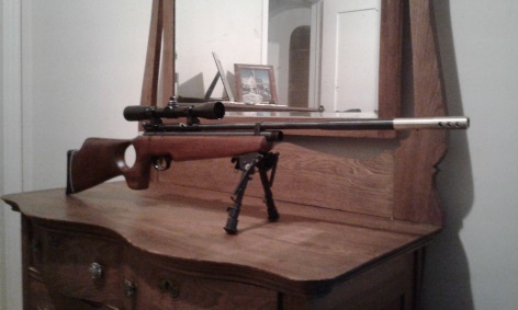

With bipod removed and at bench rest, I can't get any better group than 3/8'' with .177 RWS Wad Cutters 7.0g. The brass break has gotten rid of the whip in the barrel greatly. Any recommendations. Thank you, Happy shoot'n
Have you tried different pellets? Have not had a chance to try the qb guns but they have a good reputation. If it doesn't group well with different pellets some barrel prep may be needed, but make sure you read up on it before you do any barrel work.
Thank you for the input Sir! I've put less than 400 shots through it and just realized today the barrel is not even crowned, just a flat rough cut. I will be taking care of that soon. Shot a string of 10g domes out of it and actually got a small kick, the group was a mess. The learning continues.
