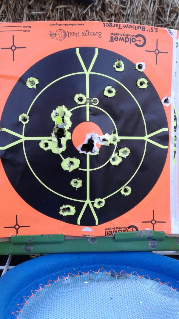

Shot tonight between 50 and 55 yards, winds light from 2 o'clock position, semi-rested using a .22 Benjamin Summit NP2. The gun has more to offer than I can currently avail with my shooting skill. Plenty of pulled shots to distract from the encouraging groups comprised of the bunch in the bull and the cluster just to the bull's left. As with golf, there's enough there to keep me coming back for more. A pretty good evening's shoot.
