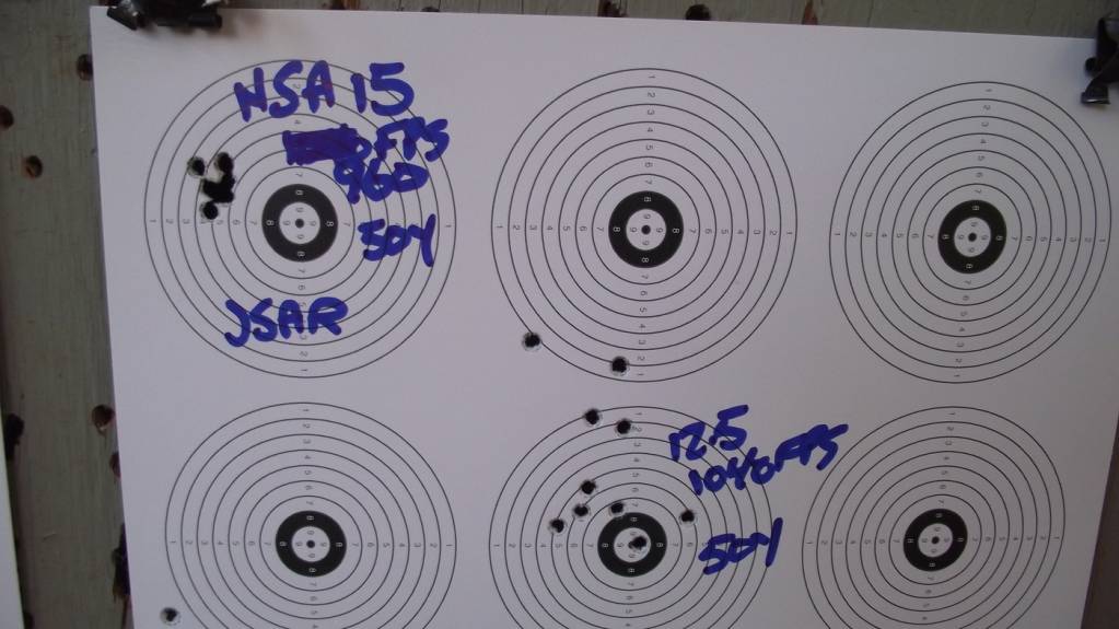

Bit of an update ...
Recently received some NSA .177 in 10.5 grains ... hell yes a Field target doable weight for sure !!
Shot threw an M-rod at @ 890 fps .... RAW TM-1000 at @ 910 fps .... Taipan Vet @ 850 fps
None shot they that well being at 50 yards and inch or so with none exhibiting potential enough to explore further for the FT game.
Now AMPED UP the NSA 15 grain at @ 960 fps at 50 is something special !!
Thats 10 shots easily covered with a dime. right side the 12.5 weight going a tad faster and NOT happy at all.
