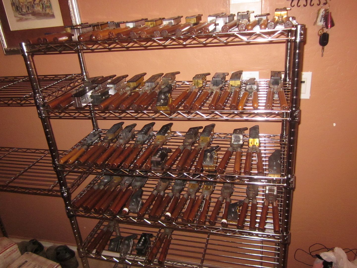

MOLDS%201.jpg~original
Yes, I do. I have been designing bullets and having molds cut by NOE and Accurate molds for 3 yrs. now. along with stock molds from NOE I now have 59 molds for .220 38 gr. bullets up to .510 580 gr. bullets. Many of then are hollow point and a couple of them I have set up with aluminum ballistic tips. I am a manufacture and I wholesale to AOA ans R&L only. I have a day job that takes up most of my time so I have not gone into full production. Lately Kip from AOA and I have put or heads together and designer several .308 ,.357 and .452 molds that preform great even at ranges over 100 yds. I design bullets for accuracy and performance. Performance meaning How well they open in animals and provide a quick and ethical kill. I can cast and size most of my molds with lead free alloy. If anyone out there is looking for a specific cal. weight and design let me know. I will see if I have it or if it sounds good I may have a mold made.
